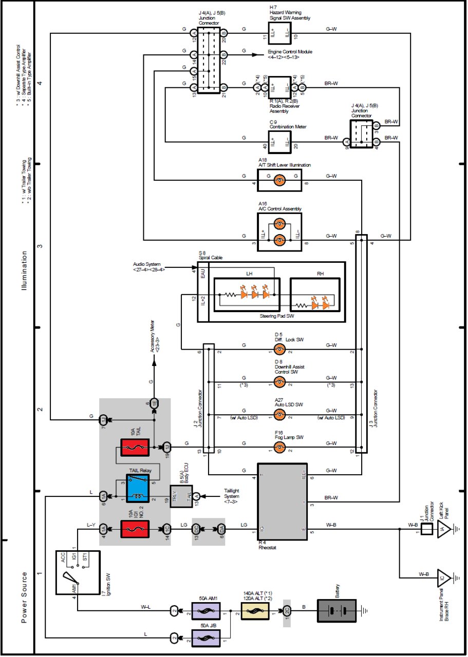

    I just bought a used 2008 Toyota Tacoma and I'm LOVING it! But as can be expected with a used vehicle, its not perfect. Right now, I'm trying to figure out why multiple buttons/knobs are'nt lighting up at night (yes, I have the lights turned on and the cluster scroll thing turned up all the way). Mainly the climate control knobs, rear diff switch, fog lamp switch and the cruise control thing on the steering wheel. Are all of these things related to one fuse? or do they even light up? cant seem to figure this one out.

    Welcome to TW! Yes, they are supposed to light up when your headlights are on. Have you checked your fuses? You should be able to locate which fuses to check in your manual.

    HVAC bulbs are probably toast . Easy to replace ,the panel just pops out .You can get the bulbs on Amazon!

    Check the fuse for taillight. Also I may not be remembering this correctly and I’m not by my truck but on my 09 some of the switch lights come on when the engine is running and not controlled by headlights being on. The hvac could just be bad bulbs- can’t remember if it’s just 1 for the whole unit or 1 for each switch.

    Thanks! This is great! I'm going to use it to troubleshoot the lights.
