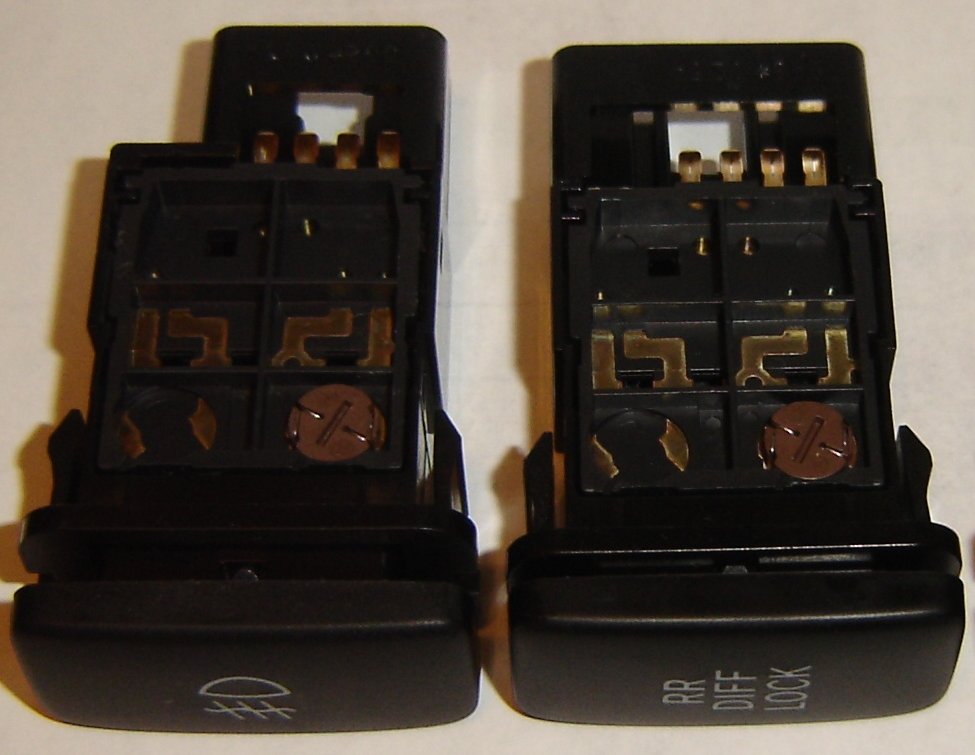

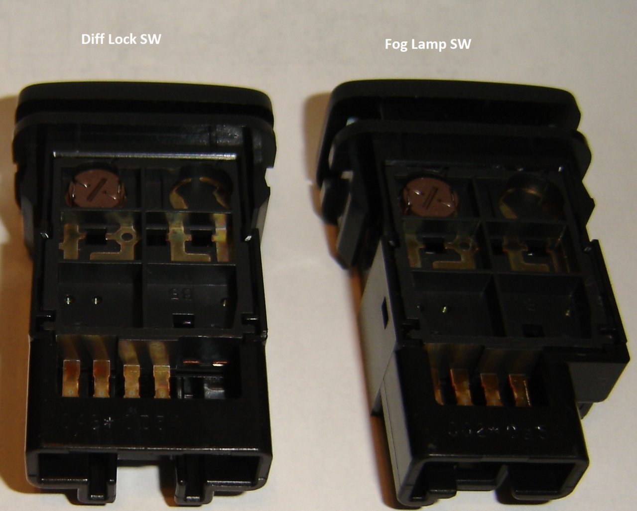

    ok, So i checked all the fuses and they're good. is it just a coincidence that the "fog Lamp Switch" "RR Diff Lock Switch" and "Climate Controls (x2)" bulbs all burnt out at the same time? and are they all the same size bulb?

    Climate Control Lamps are larger...

    Brainfart They both have the Illumination Lamp. When you actuate them is when they don't "light" up...there are mods to get them to though...

    so, if im ordering from Amazon, i think the climate controls are t4 and if the switches are smaller are they t3?
