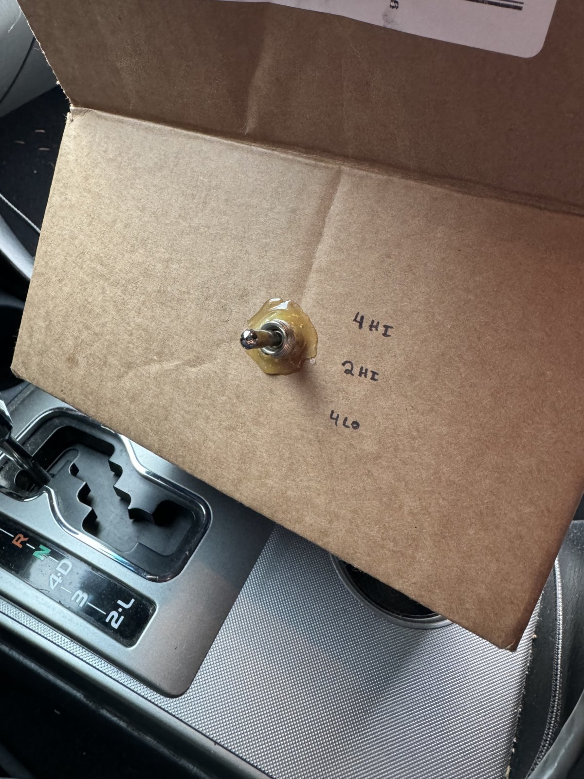

    • I have got 2HI, 4HI, 4LO mapped and working as expected - this problem is independent of any 4wd components (incl transfer case)

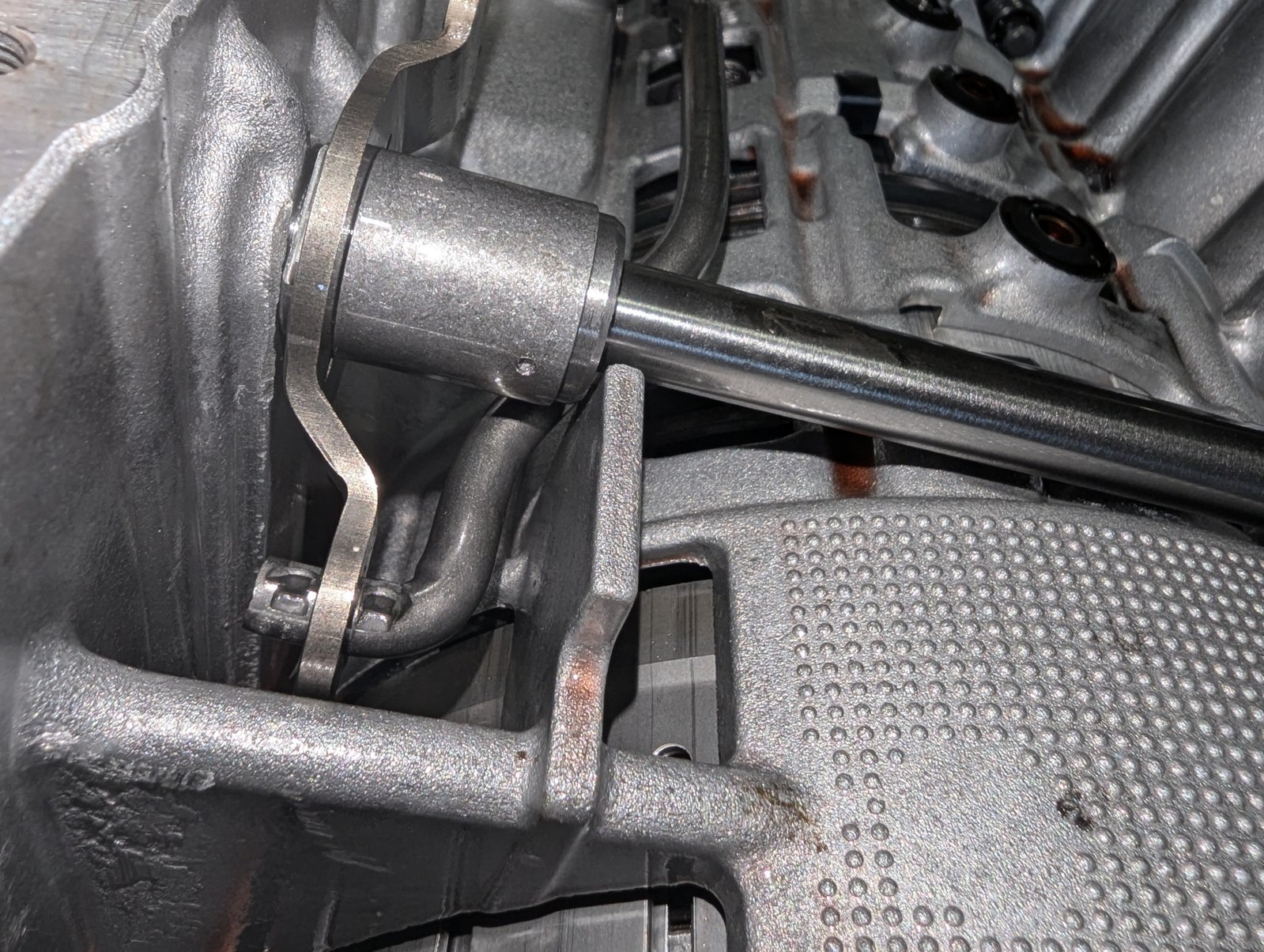

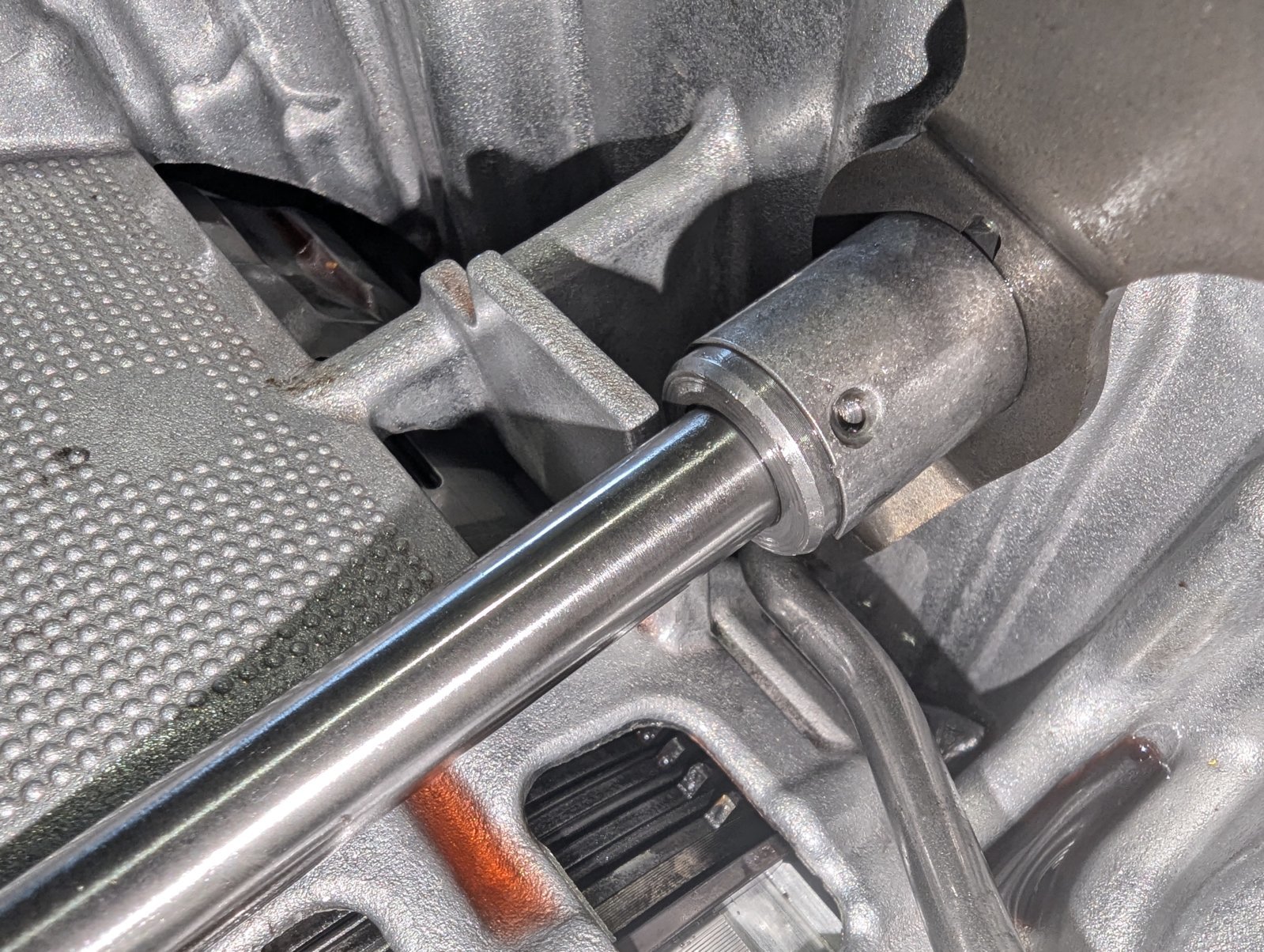

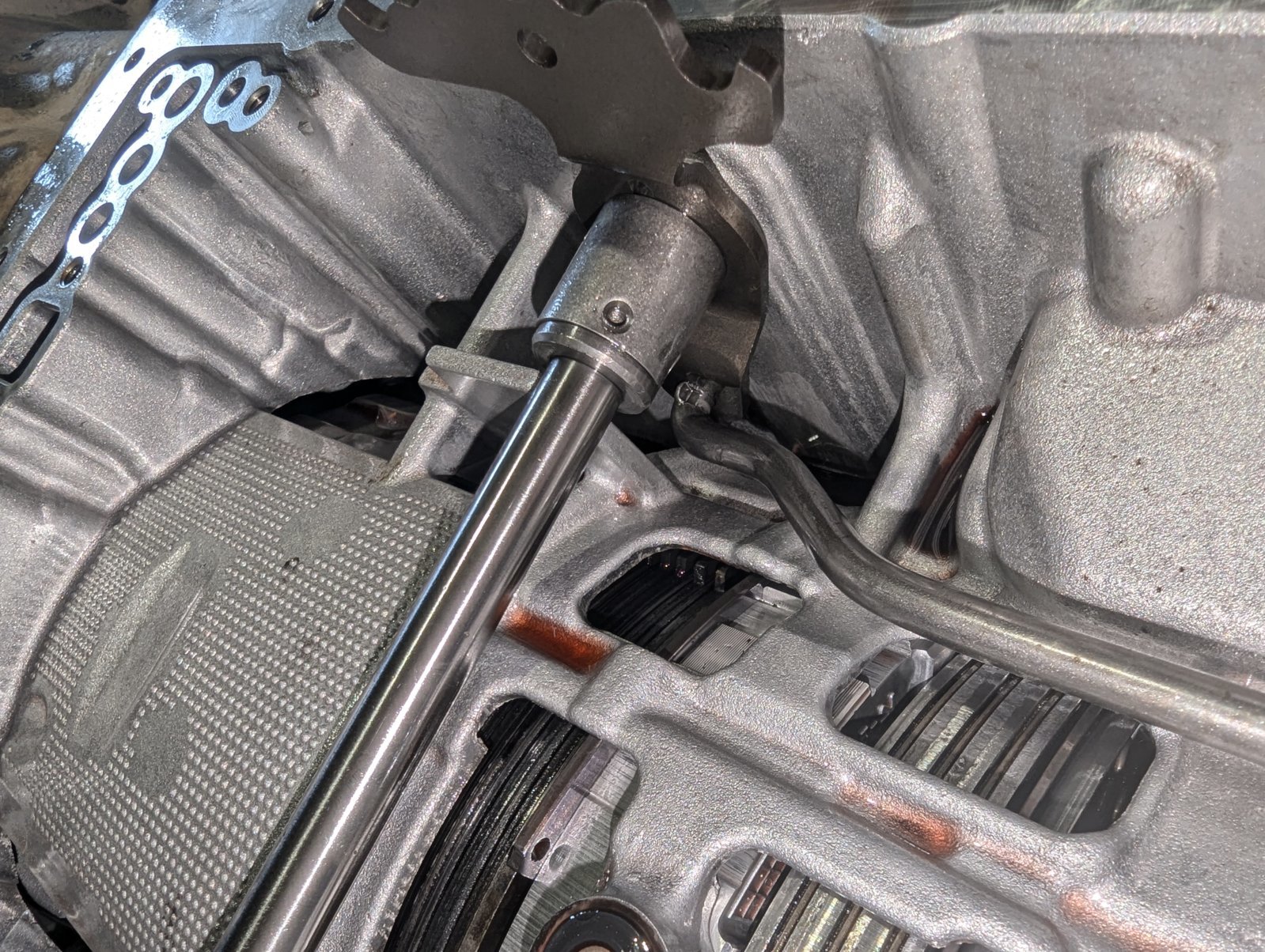

  13. Jul 14, 2024 at 2:33 AM
    Chrisking
    Chrisking Member
    Nov 4, 2019
    #309800
    21
    Kris
    2013 Tacoma V6 TRD Sport
    Hi. Any Update to this problem? I'm in the same situation, just installed a 2020 low miles 4runner transmission into a 2013 Tacoma. And I also can't shift to second and first. Did you have any other problems with this transmission swap? I didn't drive my truck yet, but the valve body solenoids are making some weird nosies even with the engine off, ignition on, there is a constant buzz out of the SL2 solenoid.
  14. Jul 16, 2024 at 5:43 AM
    Chrisking
    Chrisking Member
    Nov 4, 2019
    #309800
    21
    Kris
    I took the pan off on both transmissions and indeed the two rooster cowl are different shaped. Thank you gearcruncher for the hint. That on taco transmission has a "B3" stamped on it and the other is "C10". I removed the valve body on the old transmission to get the rooster cowl out.
    Does anyone know how to separate the rooster cowl off the shaft? It looks like there is a thin metal sleeve on the rooster cowl an underneath is a pin that goes thru the shaft but the metal sleeve is pressed into the hole where the pin goes so that it covers the pin hole. It looks like the metal sleeve would not be reusable after disassembly. Probably I could drill that indented part of the sleeve out, but shavings are a problem, and how to reuse the sleeve. I attached some pictures of the rooster cowl sleeve.
