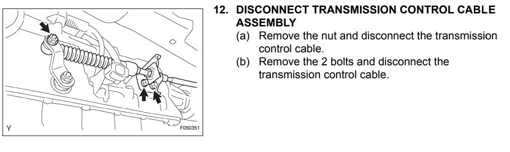

    Unhook the shift cable from the transmission and see if the shifter is still difficult to move out of park.

    I don't know how to do that.
    If you say it's still hard to get out of park even if you press the Shift Lock Override button next to the shifter then I don't think it's an electronic issue.

    Do what Dm93 posted above.

    Again, See if removing the shift cable and manually changing the gears makes a differene.
