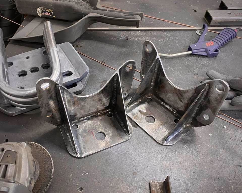

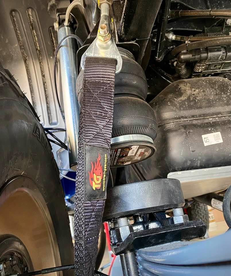

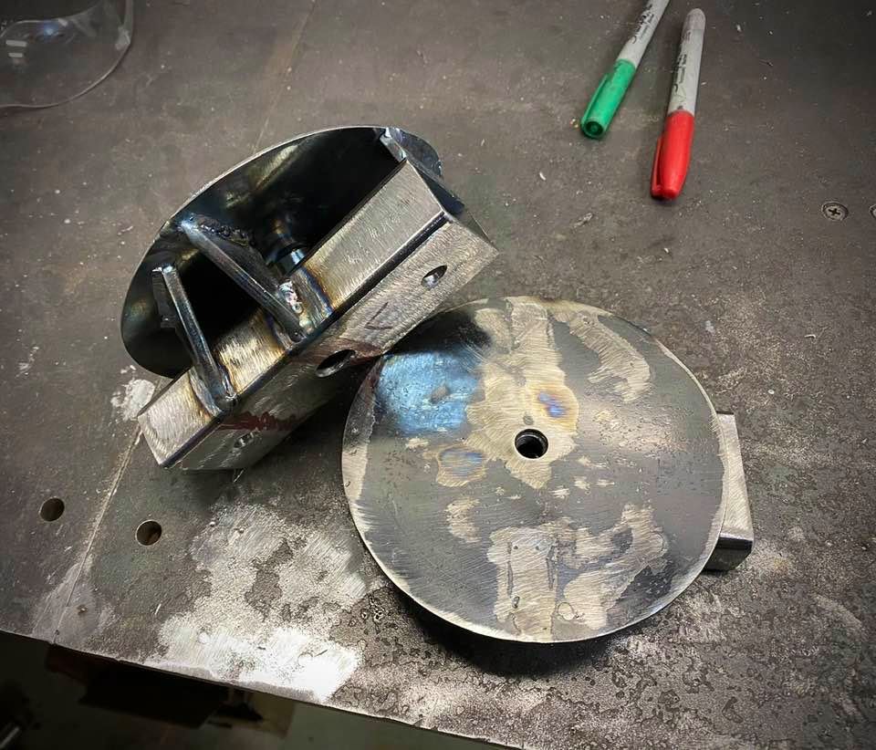

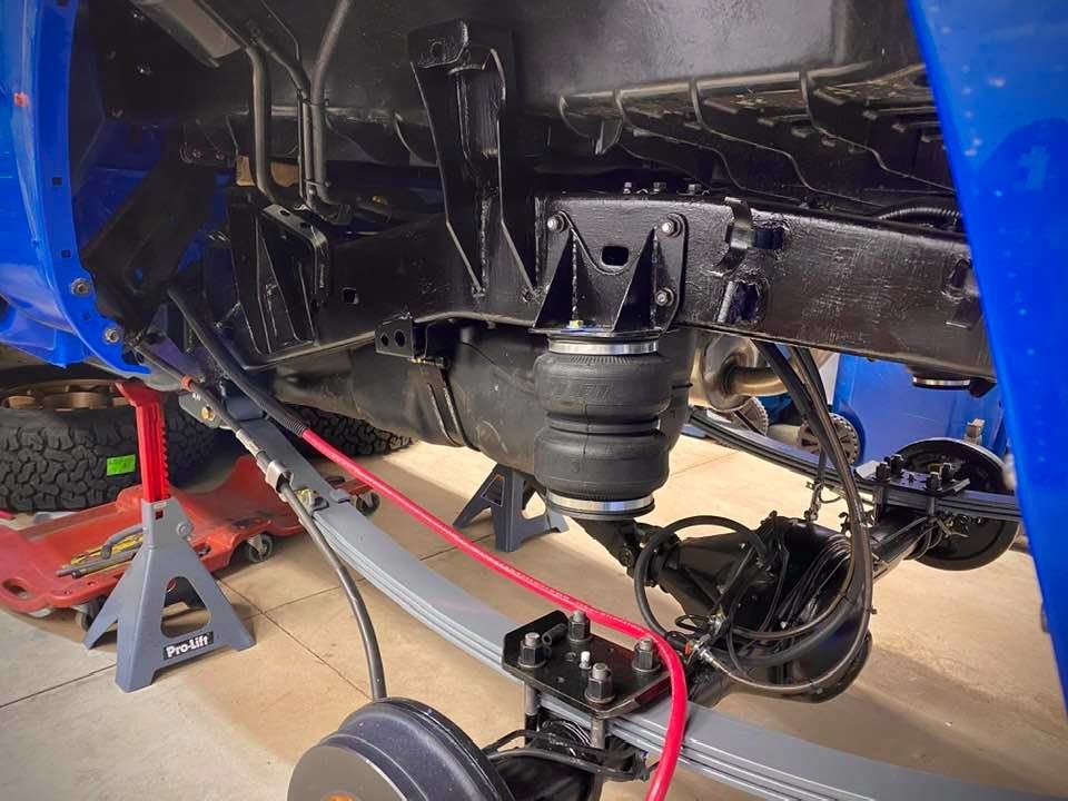

    while designing a cantilever system looks fun, have you looked at how much lower profile you can make the mounts on top and below the airspring?
    if you keep that height minimal, you might get enough up travel.
    also there are various height air springs. Airlift makes 3 different heights in their internal jounce stop integrated product line alone.
    while i'm on 63s so it isn't exactly what your setup is, I had the same concerns but keeping the bracket heights minimal, I have plenty of up travel without having to notch the frame.
    sorry I only have pics from when i was doing the whole rear suspension, so nothing specifically looking at the brackets for cradles and air springs
