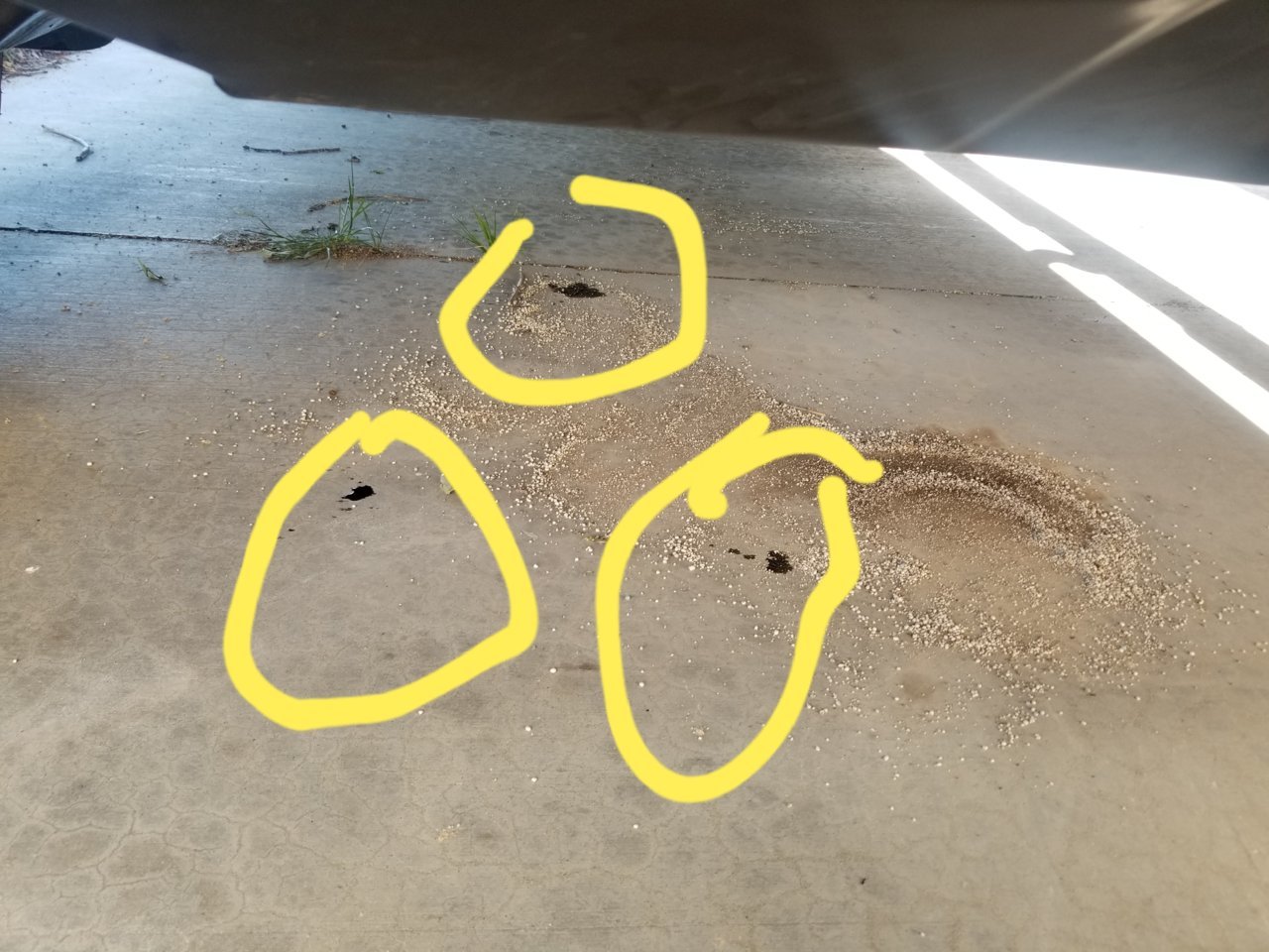

    This is how much has dripped since I've been home... three different spots. Use to never leak at all..:(20190624_192620.jpg

    If he never cleaned it that’s about normal. Think of it as rustproofing.

    Lol, i already have that undercarriage coating lol

    If you guys think it's normal too then I'm not gonna worry yet

    Let it run in the driveway with cardboard under it like Bill mentioned, check on it from time to time. The longer it runs and the dripping stops, youll feel better about going on your trip. Get under there with some newspaper and soak up as much as you can from the frame and bottom of the engine. It'll be kinda messy but if you help it "dry out" youll know if you still have a problem

    Ok, I'll do this tomorrow evening while I'm cleaning it out and getting it ready I guess. Running out of time and so much to do. I'll be driving it to work and back to so hopefully it'll help get rid of excess oil as well.
