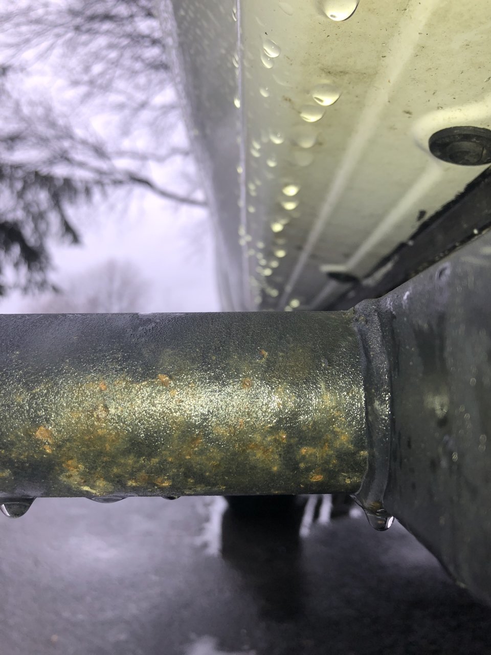

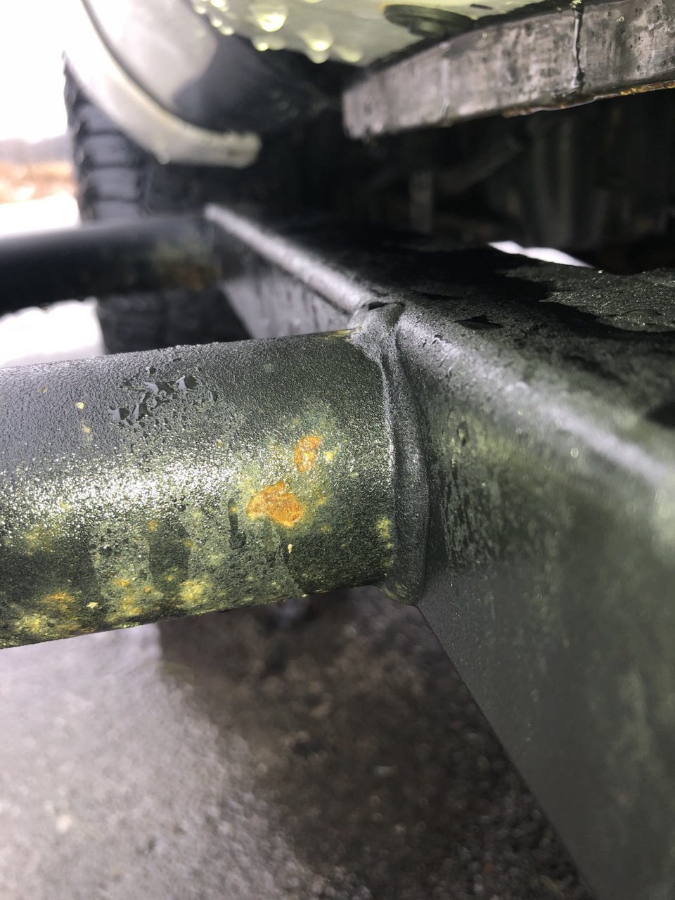

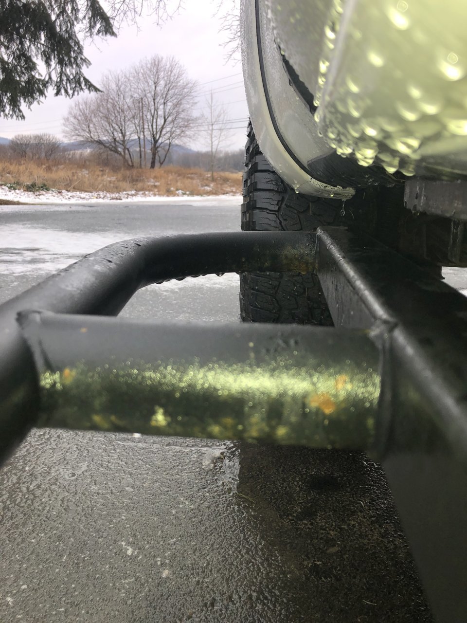

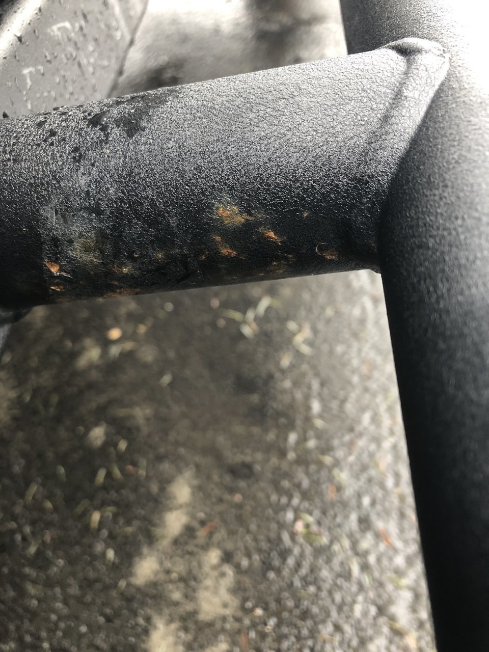

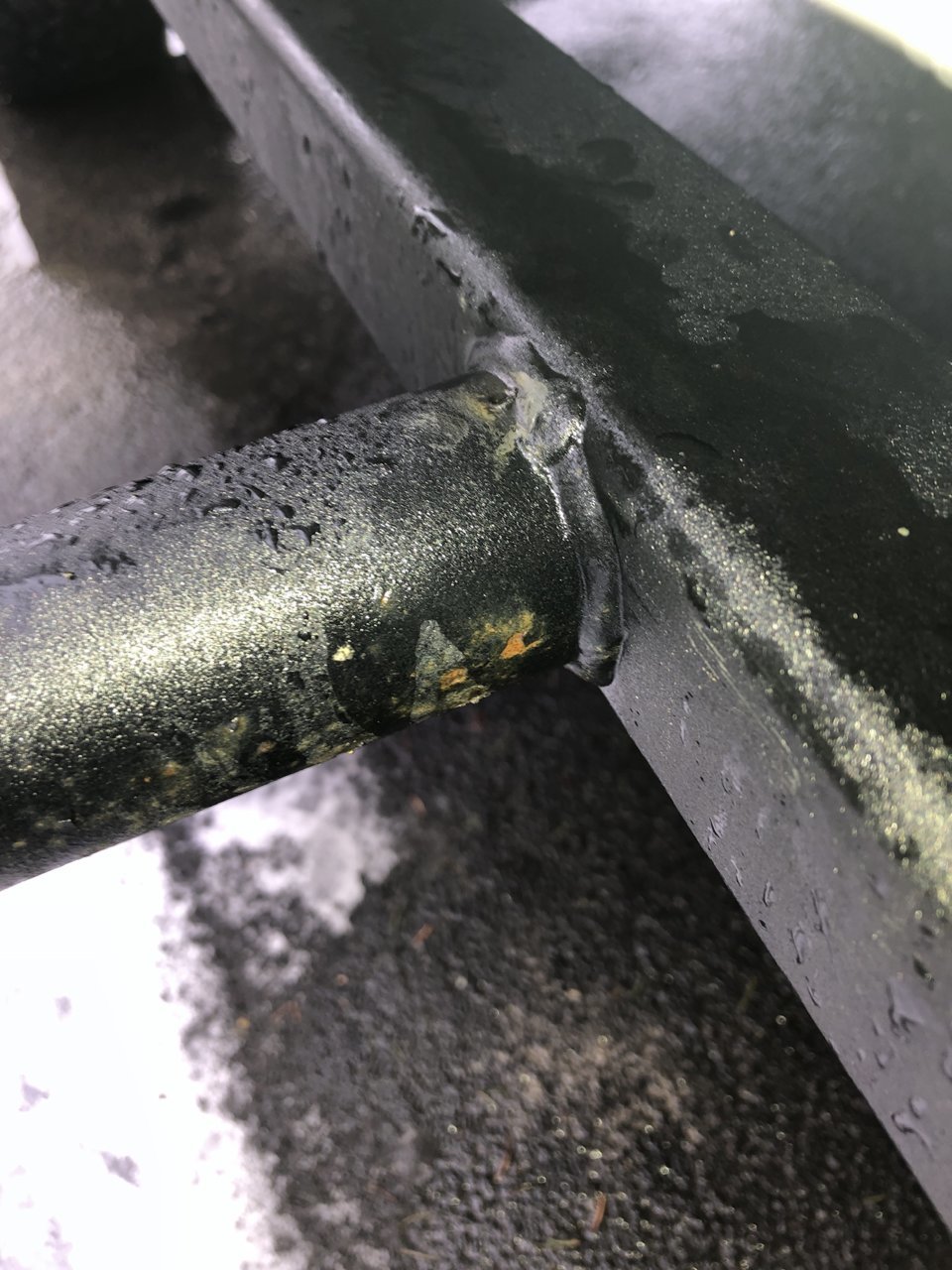

    Looks like some chipping going on ,that’s most likely the problem :(487C2B72-3A26-4823-9A3F-A44D41F5AAF0.jpg0B9A76F0-D096-4399-AECF-83200A047032.jpgDD676C12-C322-4FB3-A613-4447CB38EC97.jpg40358815-BCAD-4678-9110-61FC9EC21337.jpg78C7177F-F8F4-44EE-8C2E-9470C90A0DBA.jpg

    Hey brutha, yeah your right that is from those meaty tires ya got bouncing rocks against them. I have had the same issue before. After looking at your sliders coating, that Rustoleum I mentioned is gonna have a hell of a lot more texture than what you have. I think they make another brush on version that doesn’t have as much texture in it.
    I will look.
    It almost looks like the Duplicolor bed liner I used on the inside of my fj40.

    Ok thanks ,any texture is fine with me . So sand and clean . What chemical if any should I use to clean them before painting ? Just alcohol?

    After a good sanding, lightly hit them with a coat of Rustoleum Rust Killer. Let me find it real quick. Shoots on clear and fades to a dull grey.

    I’ve used the rust reformer that is flat black by Rustoleum .

    Bill, check out this vid. Goes over the basics. Also that POR15 that they are using is nice stuff. I have used it on pieces and frames rails.
    https://m.youtube.com/watch?v=jQppOCOOJGw
    Remember that Prep makes the difference.
