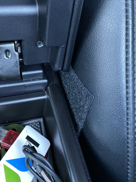

    Well that was unexpected. As it turns out, it wasn’t the lid, but rather the leather seats rubbing the lid. My Volvo had this random patch of soft material on the side of the seat in a similar spot. Always struck me as odd, as I couldn’t figure out what it was for. So...grabbed some heavy duty Velcro at Lowe’s and put the soft side on the seat...no more annoying creaking.

    Nothin’ wrong with that. I mean, they gotta rub somewhere, right?
