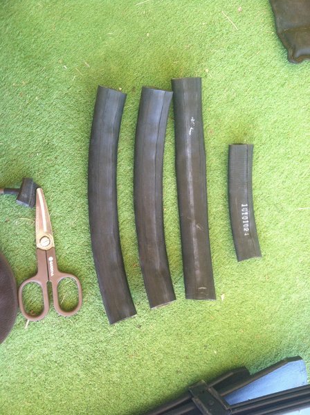

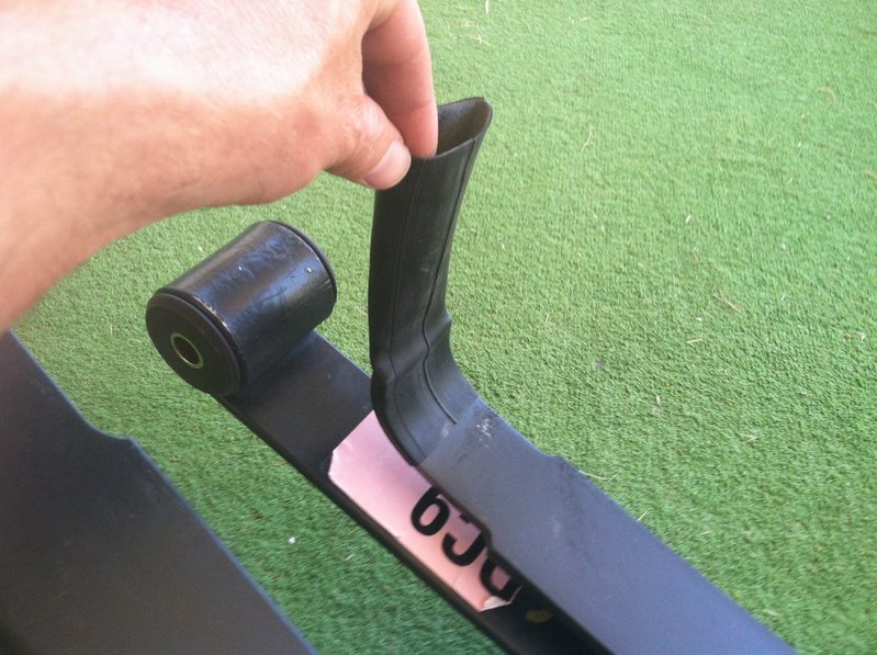

    I covered my Dakars in squeak armor too.

    I need to find out some kind of squeak fix. Did you do this before or after initially installing them.
    House noisy are they before and after?

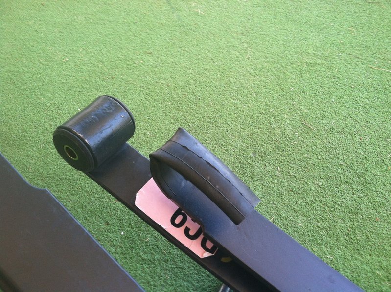

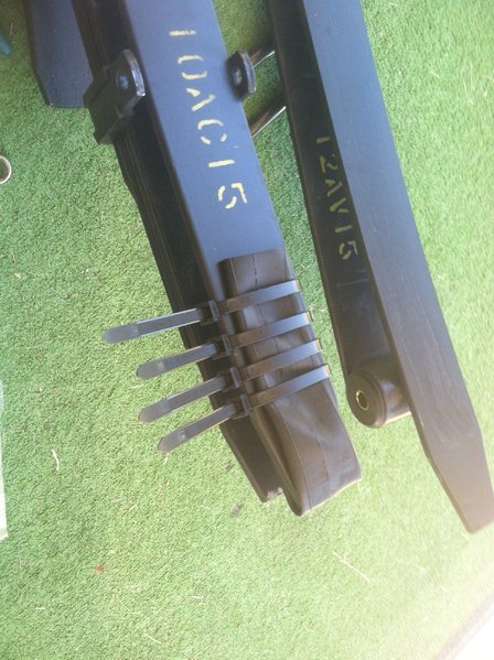

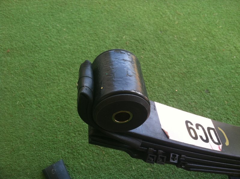

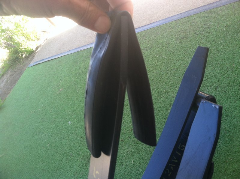

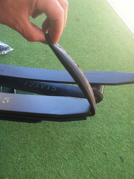

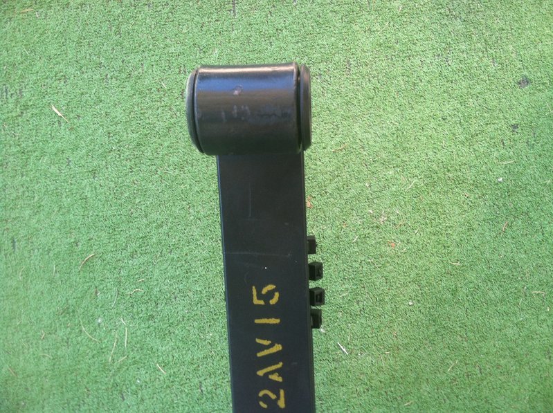

    I think it was @IronPeak4x4 who had isolators installed on the Dakars. That's the real solution. It's disappointing that they don't come this way.

    Isolators installed, 10$ a pop out the door, I had at done at a place that makes custom leafsprings, good luck Chad Im in for 5$ on yer upgrade crowdfund, enjoy

    Thank you very much sir!!! I have seen in another thread where somebody installed the isolators also. Have any squeakage with those puppies on there?

    Zero . Zero sounds from the back end
