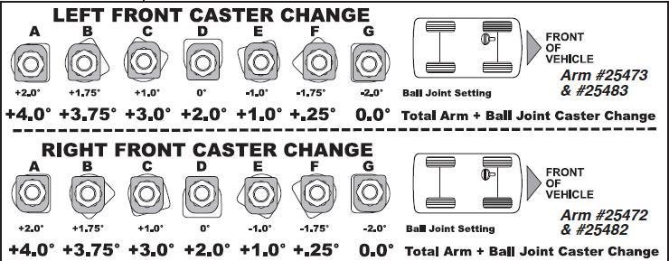

    You mean the shock right?

    Nope. I mean the alignment. You want to get as close to this as possible.

    Yep gotcha no reason they can't get it right with the new UCA's lol. I thought you were talking about the shocks being change from zero or something lol

    The LR UCA's are adjustable. My bad, it's +2 for the UCA. D in the photo below.

    Still need to tell them that you want the caster as close to 3 as they can get, toe and camber as close to 0 as they can get. That's the alignment numbers for a 3" lift on these trucks. A stock alignment will drive like shit.

    I put mine on D +2° & told them I want 3°, damn thing rubbed worse than when I brought it in. It was at 4° when i brought it in so he put it back to 4°, it drives good & better than before but with that 2° on the top it still puts the wheel closer to the fire wall. I got the 1 yr alignment so I think I'm gonna take a degree out of the top & take it back to get put back in spec. He told me to bring it back anyway after my coils settle. I'm at 4° so taking 1 out of the top should put me at 3° & at the same time moving my wheels forward away from the firewall. At least in my head thus will work. Haha

    Do yourself a favor an reinstall the UCA bolts back the way they came out instead of reversing the direction. One of the nuts on mine worked it's way loose and it would have been nasty if they were reversed where the bolt could work it's way out if the nut had come off. I was on the way to the dealer that morning when I felt something different for a split second. Figured I'd check it when I got home. When they were rotating the tires they came and got me to bring me in the shop. Said I think your wheel bearing may be bad and moved the wheel up and down. I asked him to do that again while I looked at something. Sure enough, UCA bolt was loose and the nut had backed off about 3/8". I asked him for a wrench and tightened it up then torqued it when I got home.
