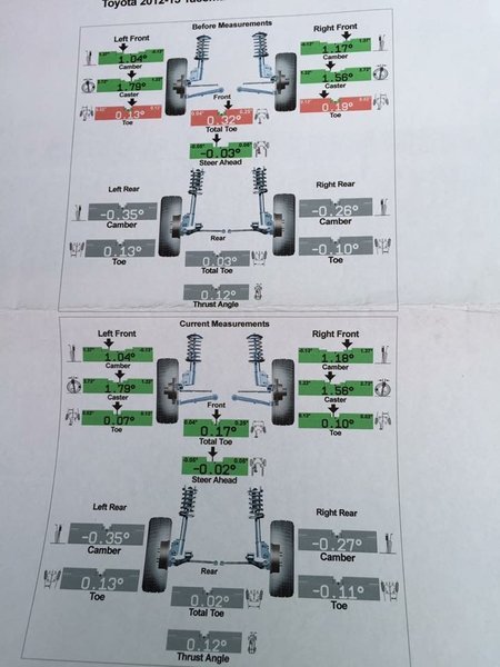

    2.5 to 3 is good for caster, as long as both sides are close to the same. Everything else as close to 0 as possible.

    Another guy told me to try these numbers and he has the exact same 2" lift.

    3/0/0, you will be much happier with these settings. Like others have said, get 0/0, and as close to 3 as possible with what's left on the adjustments. Note that camber and caster are related as far as the ability to adjust, you can't just set one, then set the other, they are adjusted together.

    Ok. I will go back tomorrow and try them again. This guy is seriously getting pissy with me.
