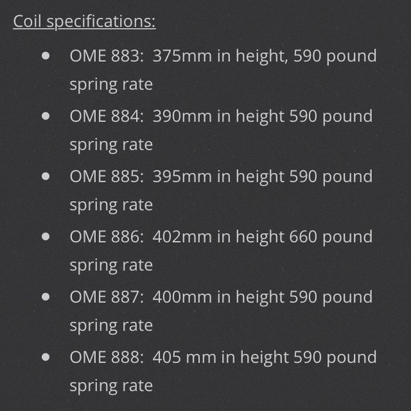

    You peerunner? If so you probably don't have enough weight up front. Not familiar with OME on second gens. For the Eibach springs it's 620# and they ride like pure shit unless you have a winch, front diff, skid plate, and bumper. So since you may not have enough weight it could be lifting your truck higher than intended

    It's a 590lb coil so it'll be a little higher since you don't have about 50-60lbs (or more) of front diff and other things 4wd needs

    makes sense...by chance would you know the spring rate of the stock coils?
    i know i could just search it but since you may know it off top then ill ask
    scottalot and ChadsPride[OP] like this.

    i knew the spring rate for the ome but i never knew what the rate of the OEM stock coil is
