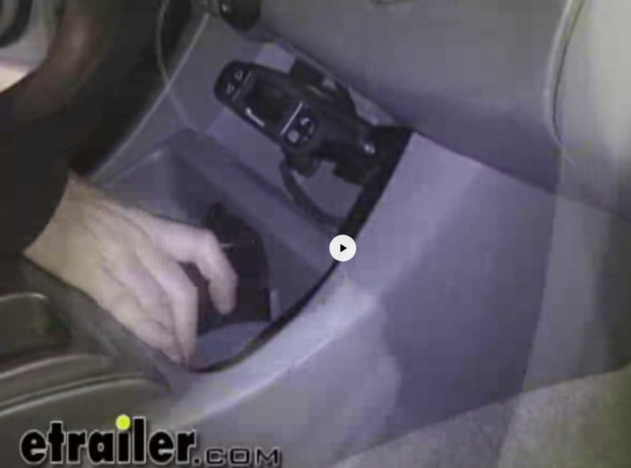

    It should be as level as possible but this is completely acceptable:

    This ^ shown Here v

    I think the P3 is one of the few that doesn't have to be level, just inline with the vehicle. Mine is located below the coin drawer on the left side of the wheel.

    Yea, I agree, I think the Prodigy (newer model) changed the whole level front to back aspect. Mine was certainly not level. I kinda meant level side to side. Actually, to be level level it would have to be on the dash, and in some older trucks you will see that.

    Looks like the price has dropped significantly since I bought mine and now they come with the wiring harness too. Jeeze.

    You mean if installed in the center console will need to be cut and wires soldered in. Think I'll just solder the wires between the pigtail that came with the truck and the pigtail off the controller. Save that $15.

    I'm pretty sure this is completely plug n play. You might have to make a hole in the back of the cubby for the wiring harness but that is it. :notsure:
