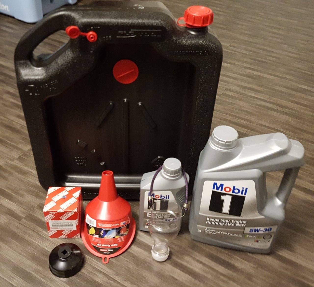

    Had to take notes! I don't want to overfill this thing right?
    Just trying to make sure i don't do anything stupid.
    I know this is probably funny to a lot of people lol

    In my last tacoma I always just put 5 quarts in it. Ran fine till I traded it in at 209k. Was always in the middle of the dipstick when I checked it.

    Trick is to let 5quarts drain out first. :D

    Kinda looks like an oil change Rotopax, Chad.

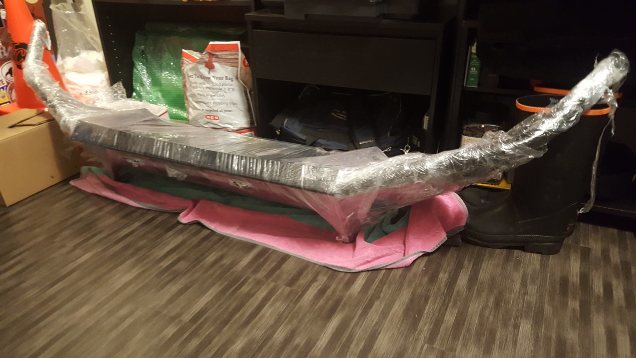

    Almost like almost about to put a bumper on? When is the install.

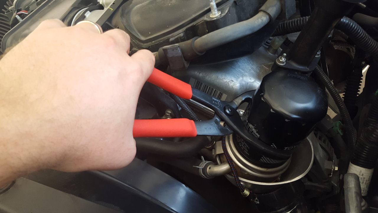

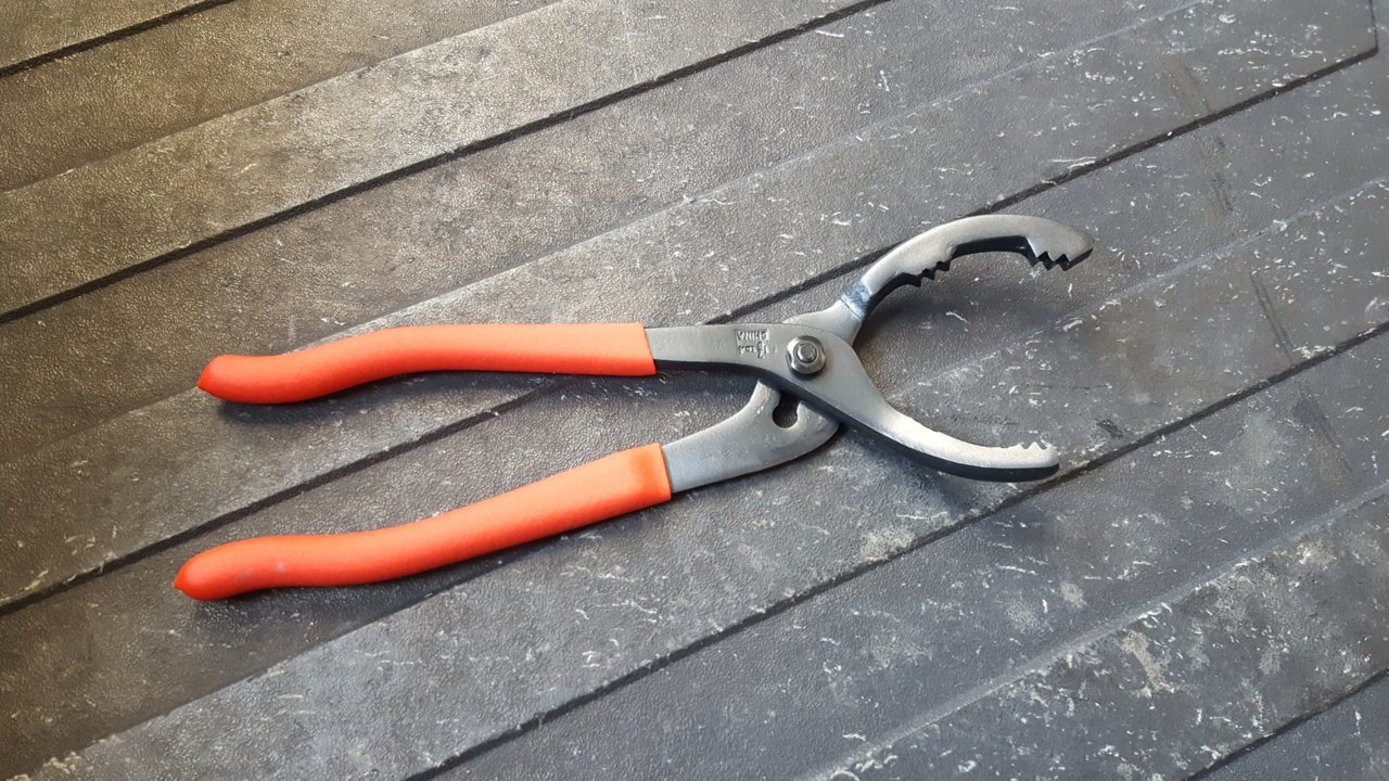

    Couldn't get my damn oil filter to break free so I had to run to the shop and get this tool.
    Letting the truck cool down for a minute. Wish me luck in round 2!

    Just sitting here in the parts room. Havnt even unwrapped it to look at the PC job.
    It'll be installed soon as I get UCAs

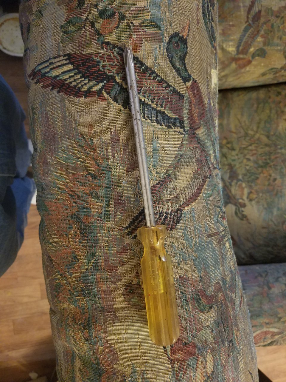

    Pound it into the filter.

    It's stupid how tight some shops screw the on oil filter on. It's not a dang axle nut you idiots.
    Chad, just hand tighten it. It's harder to take off than put on.

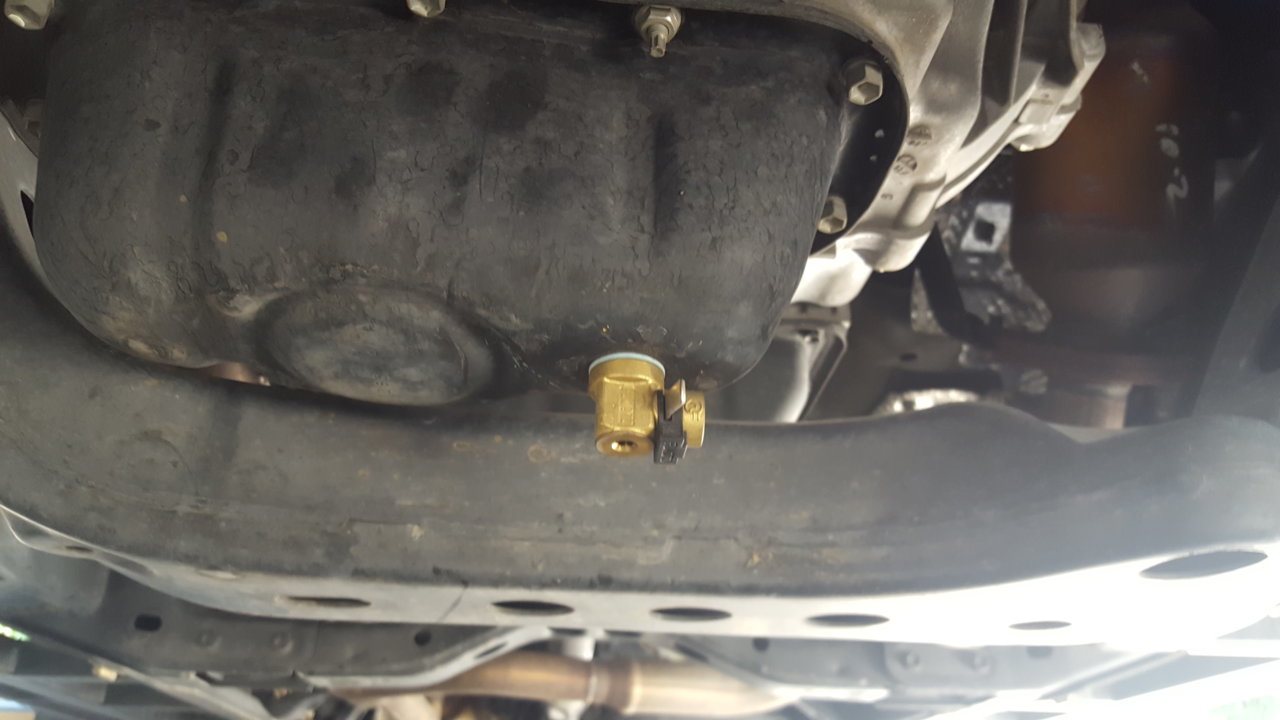

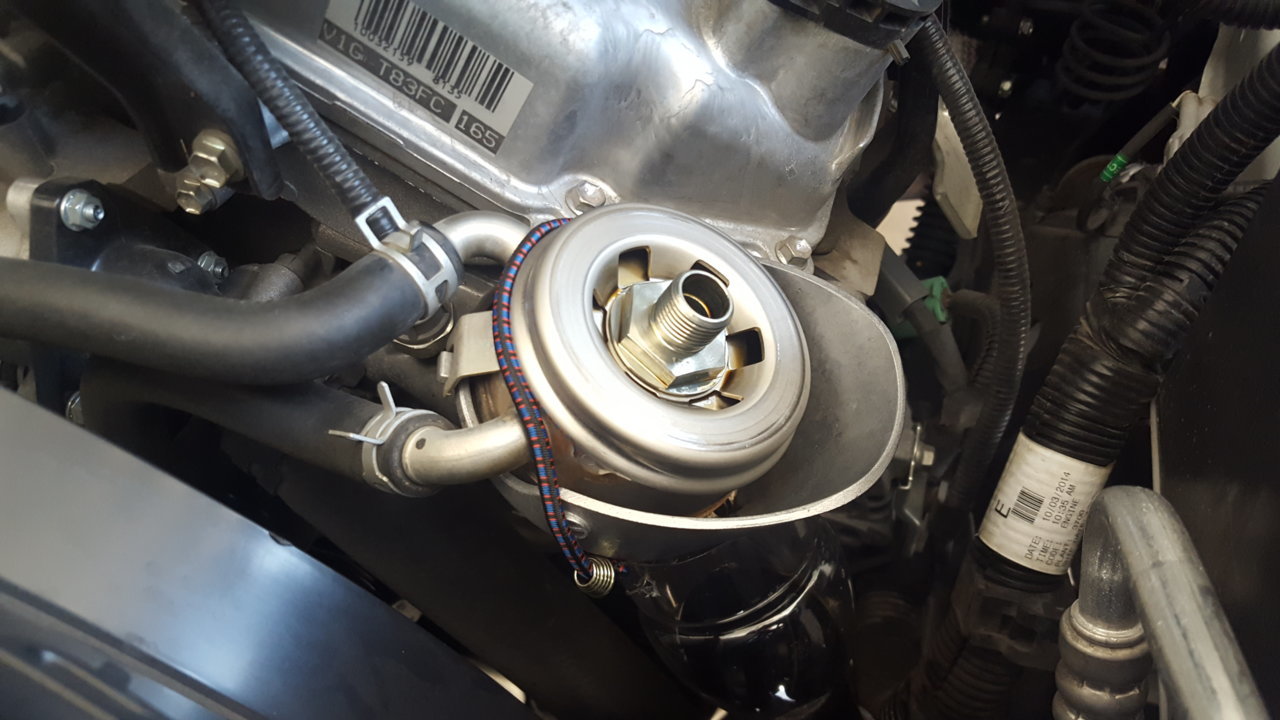

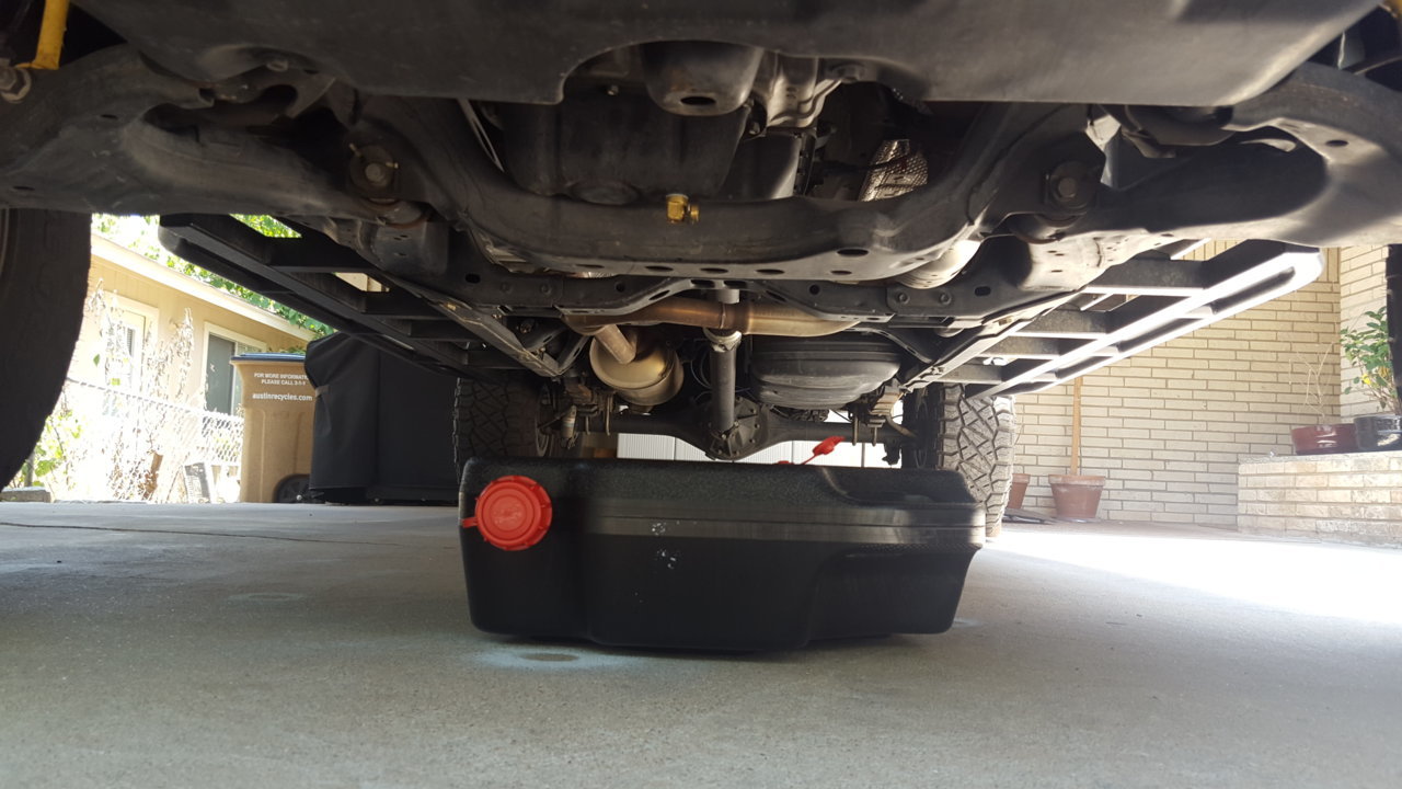

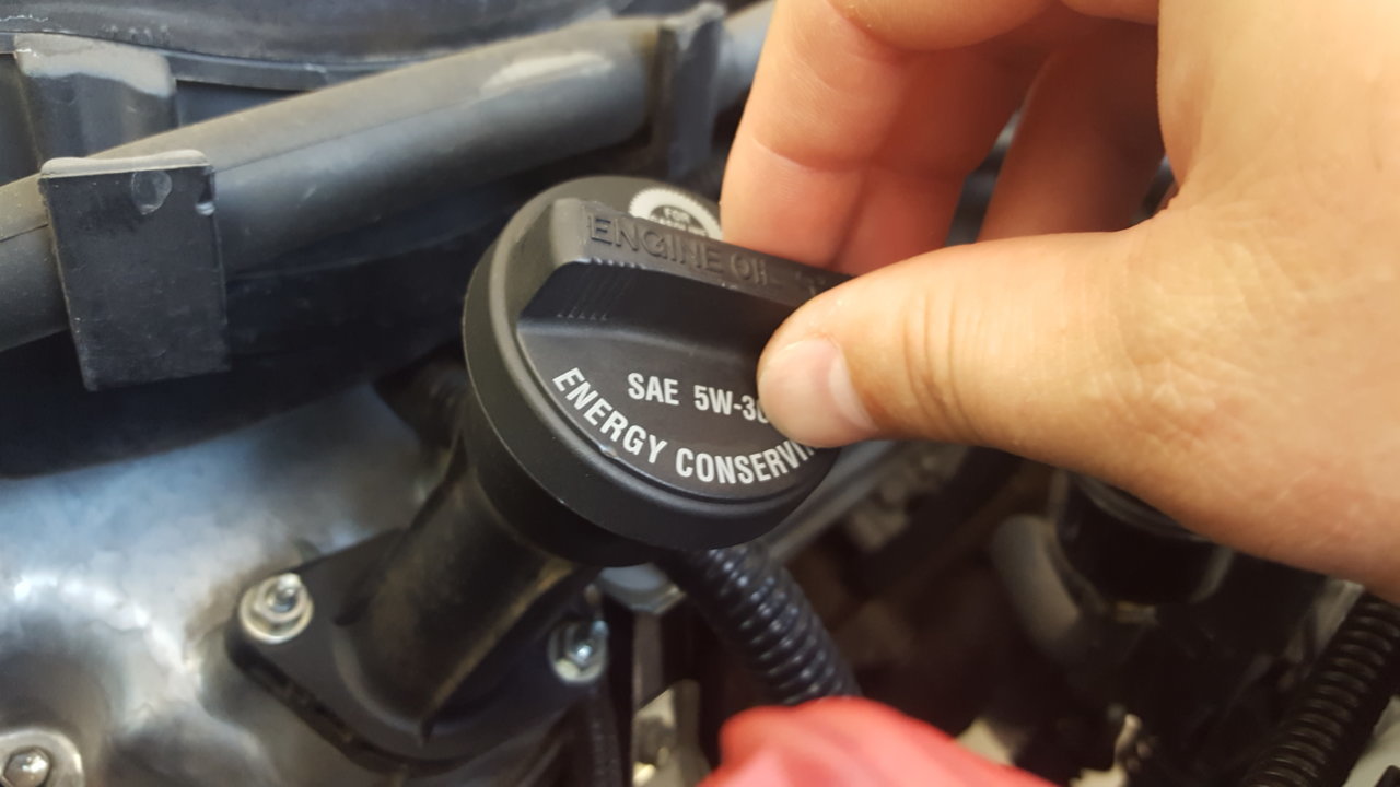

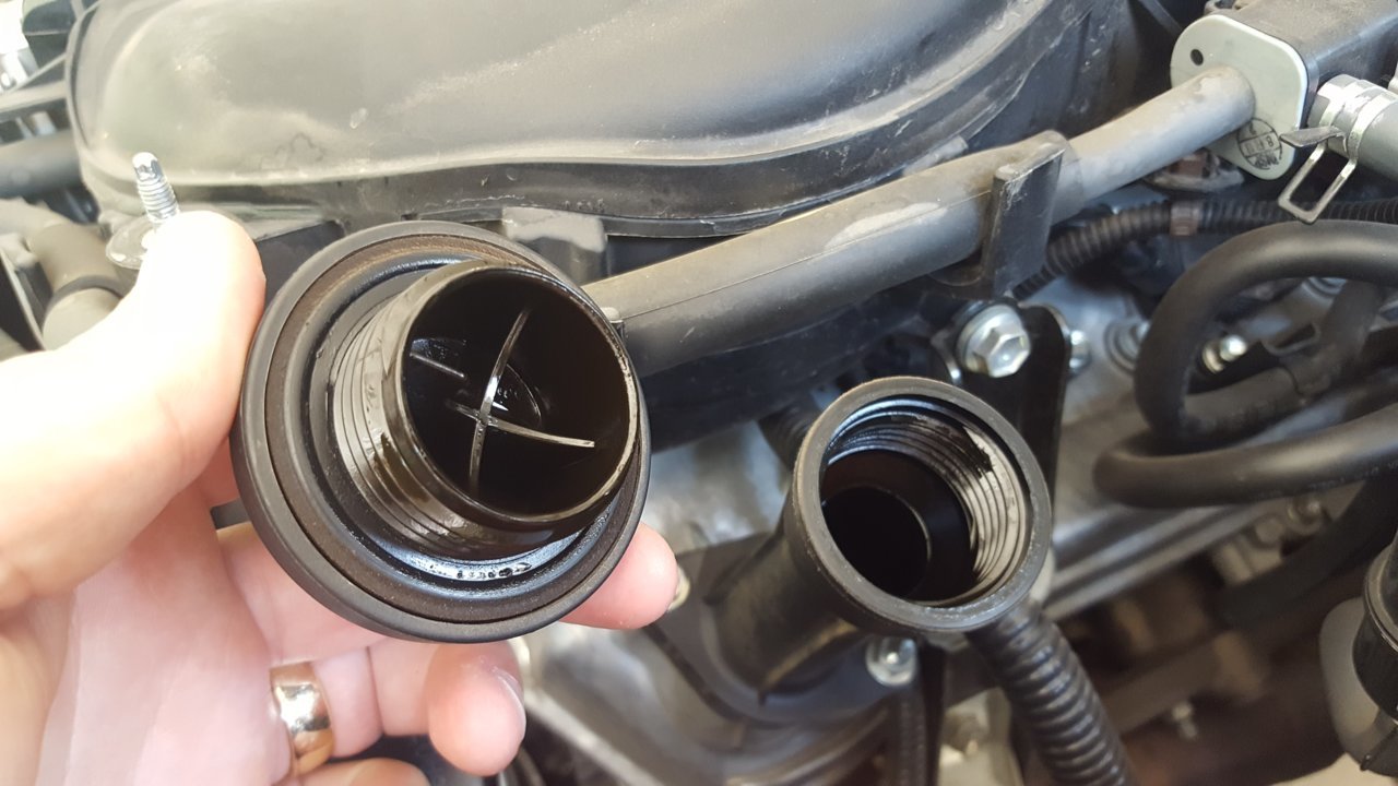

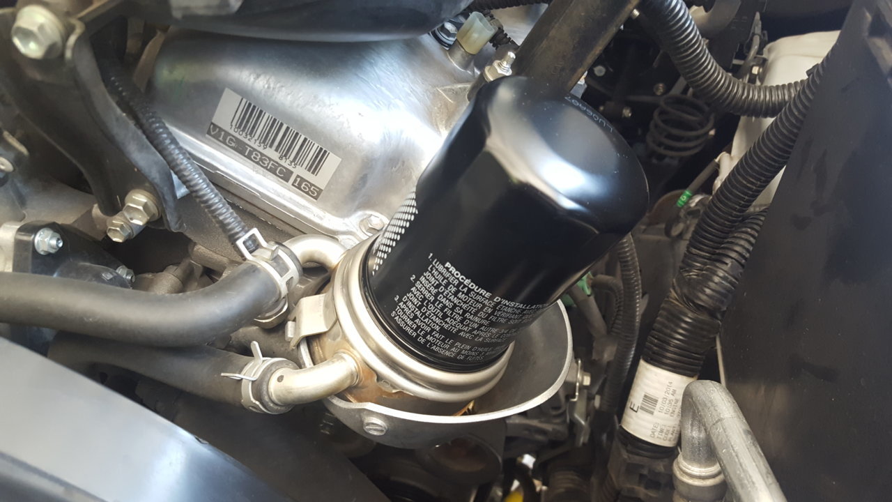

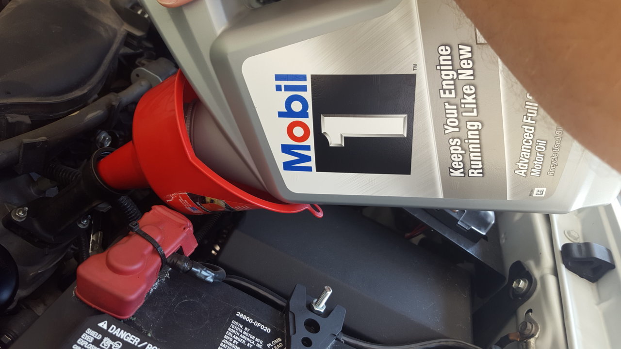

    Wanted to make sure I could get that sucker off before I drained it.
    Since I hand tightened it this time, next time I'll drain first.
    I did it!
    Then let it run for a few minutes and checked the level. Added the full 5.5qrts.
    Does anybody else have a little trouble getting a good read with fresh oil? Mine appears to be close to the full mark, but kinda unclear.
