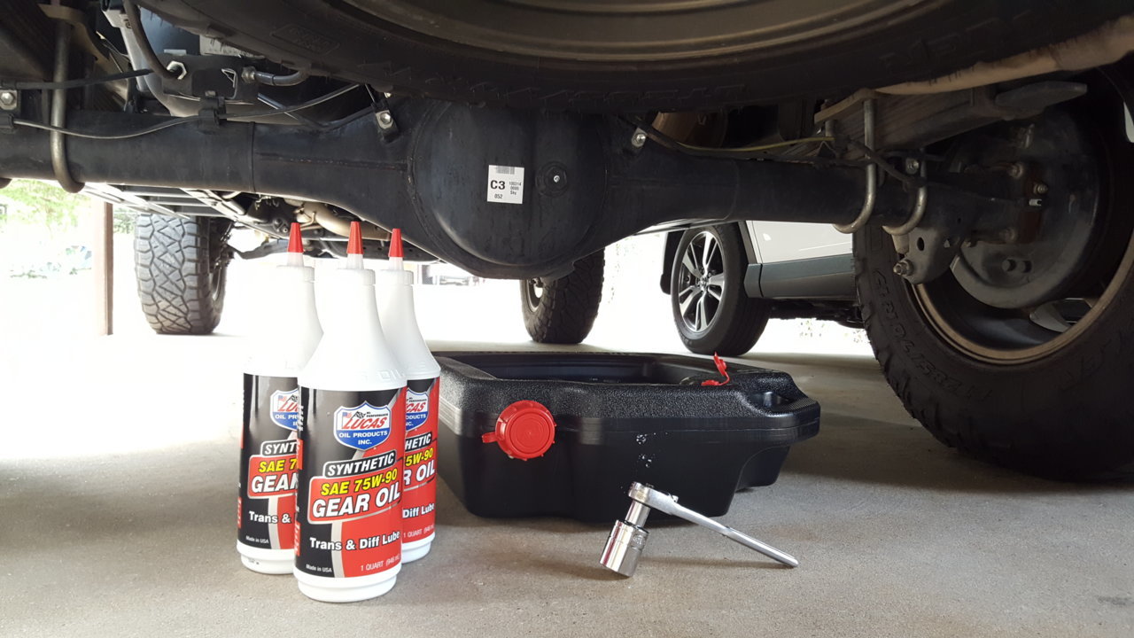

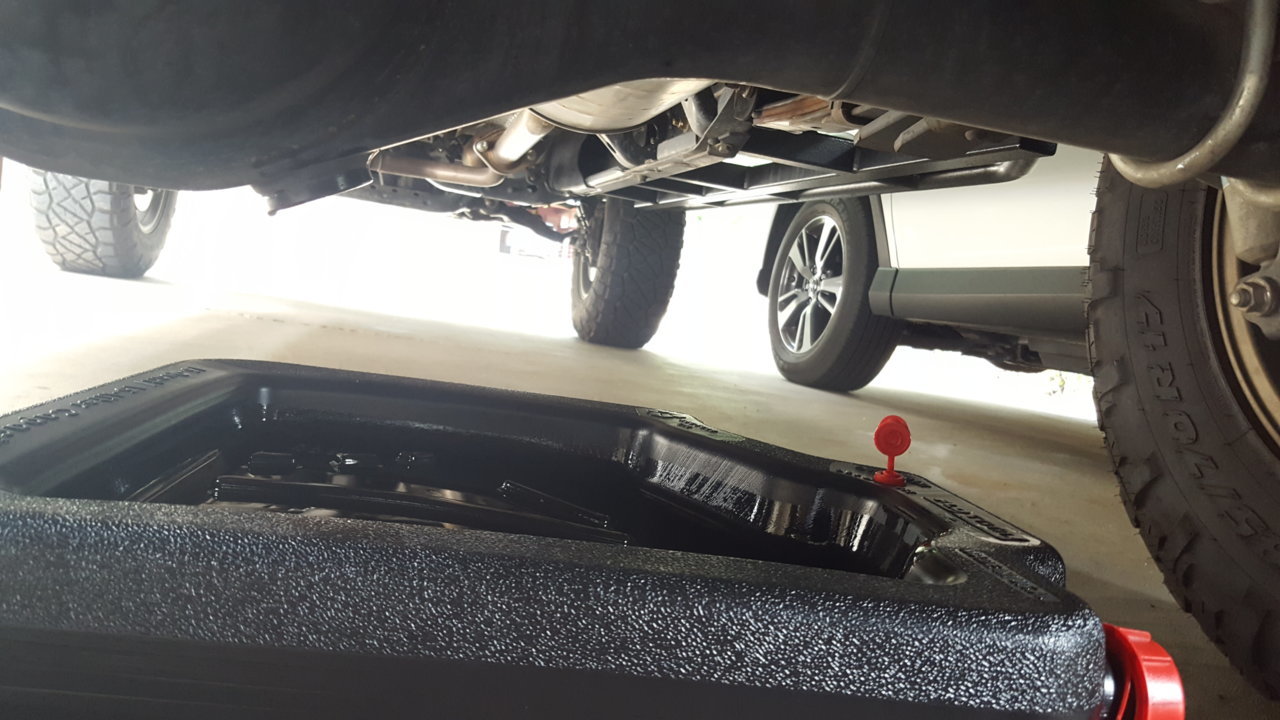

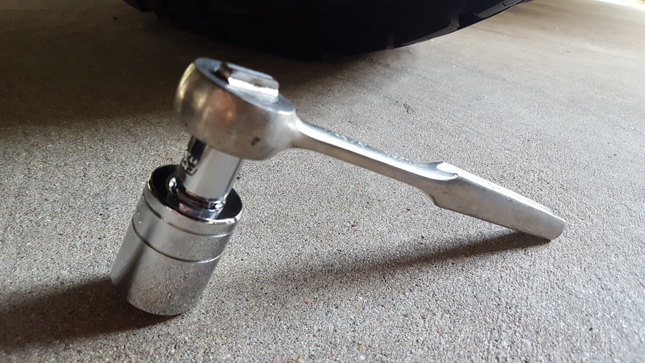

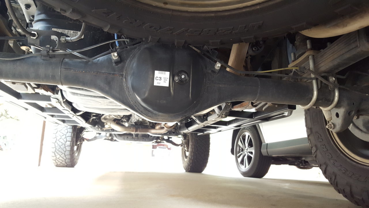

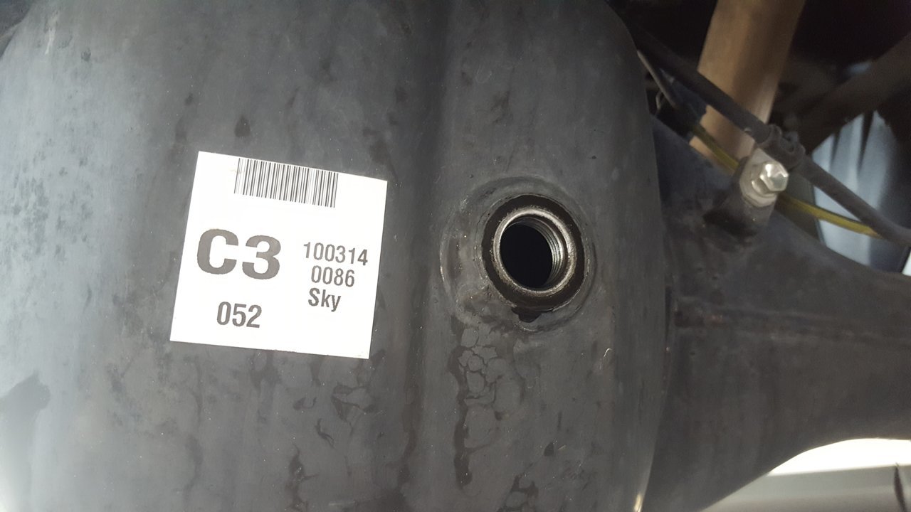

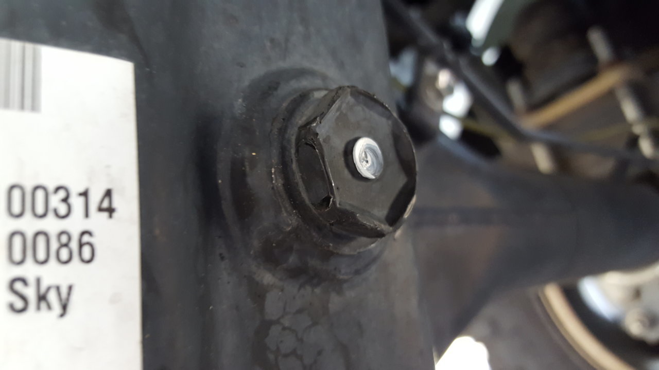

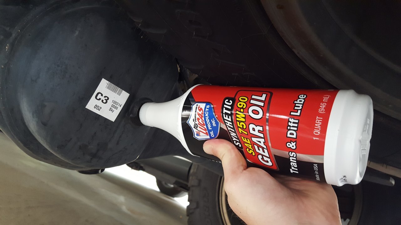

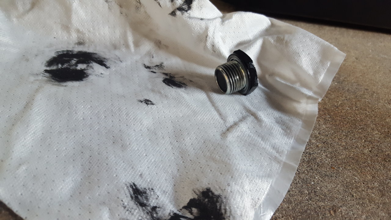

    Did a little work on the truck today, please tell me if y'all can see the pics!
    Changed the oil in the rear diff at 33.1k
    15/16s socket and had to use an adapter because I don't have a .5" ratchet (could have used one with a longer handle too, I need to upgrade tools)
    Remove fill plug
    Pulled drain plug and let it drain until no drips would come out (about 20 minutes)
    Meanwhile I cleaned the drain plug. The fluid didn't look dirty at all but the plug was collecting some crud.
    Put the drain plug back in and started to fill with 2.5 qts of the favorite.
    Put the fill plug in and gave everything I touched a quick wipe.
    Took her for an easy ride around the block. Came home and everythings bone dry and the truck feels good.
