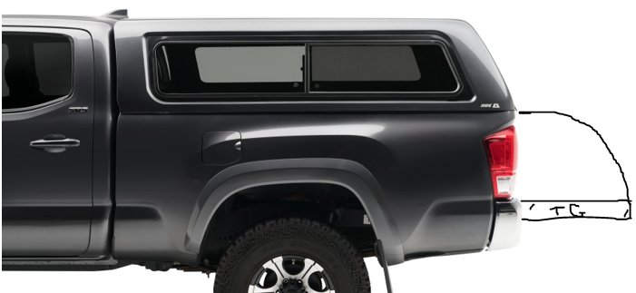

    I always thought it would be cool to build a semi-fixed box that mounted to the tailgate. This way every time you opened your tailgate, the area for your feet would automatically be set up. You could then also have full use of your topper's rear window while inside. And with being fastened to the tailgate, I think you could get a better and more consistent seal around the bed/topper when deployed.
    Horrible crayon drawing:

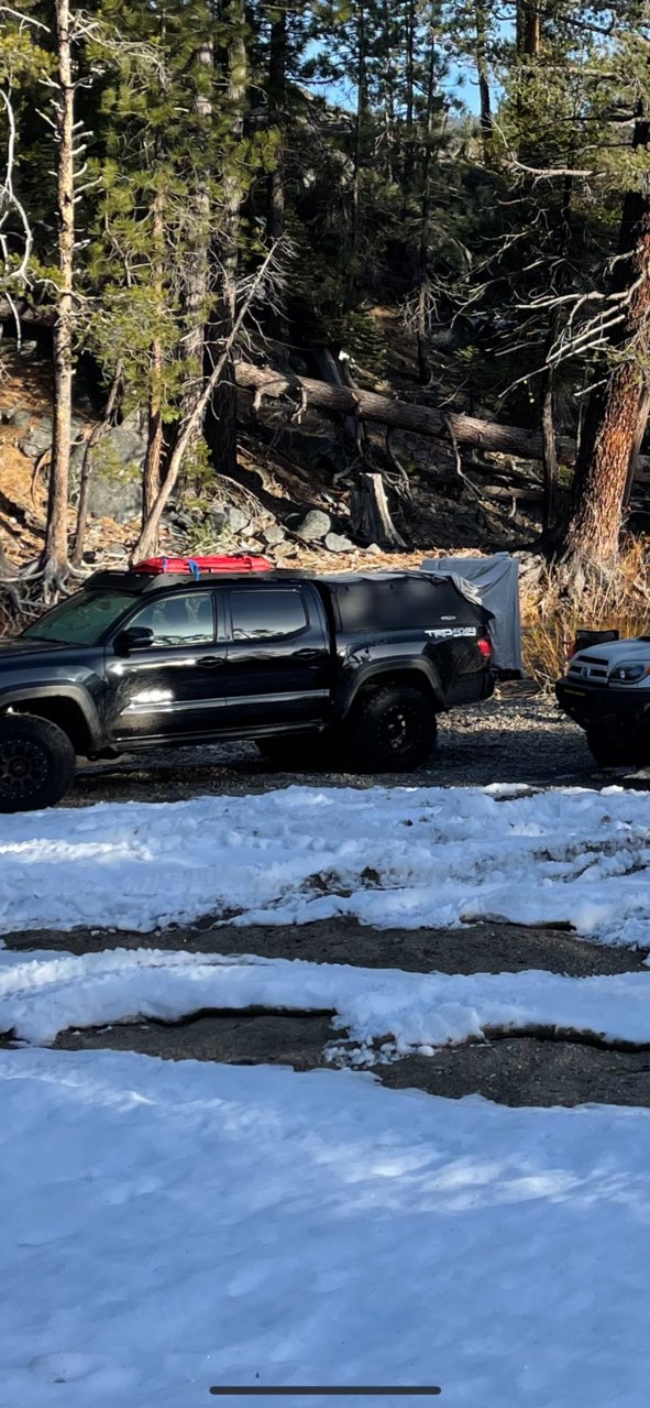

    ben
    2019 TRD Off Road
    New truck and softtopper upper 30's. Still works haha but yeah building a hard slide out would be the better route for snow.
