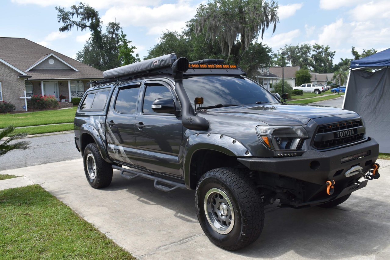

    Side_Shot_APR2020.jpg I put Rhino Tracks on my Leer. You can buy just the tracks or the entire system.

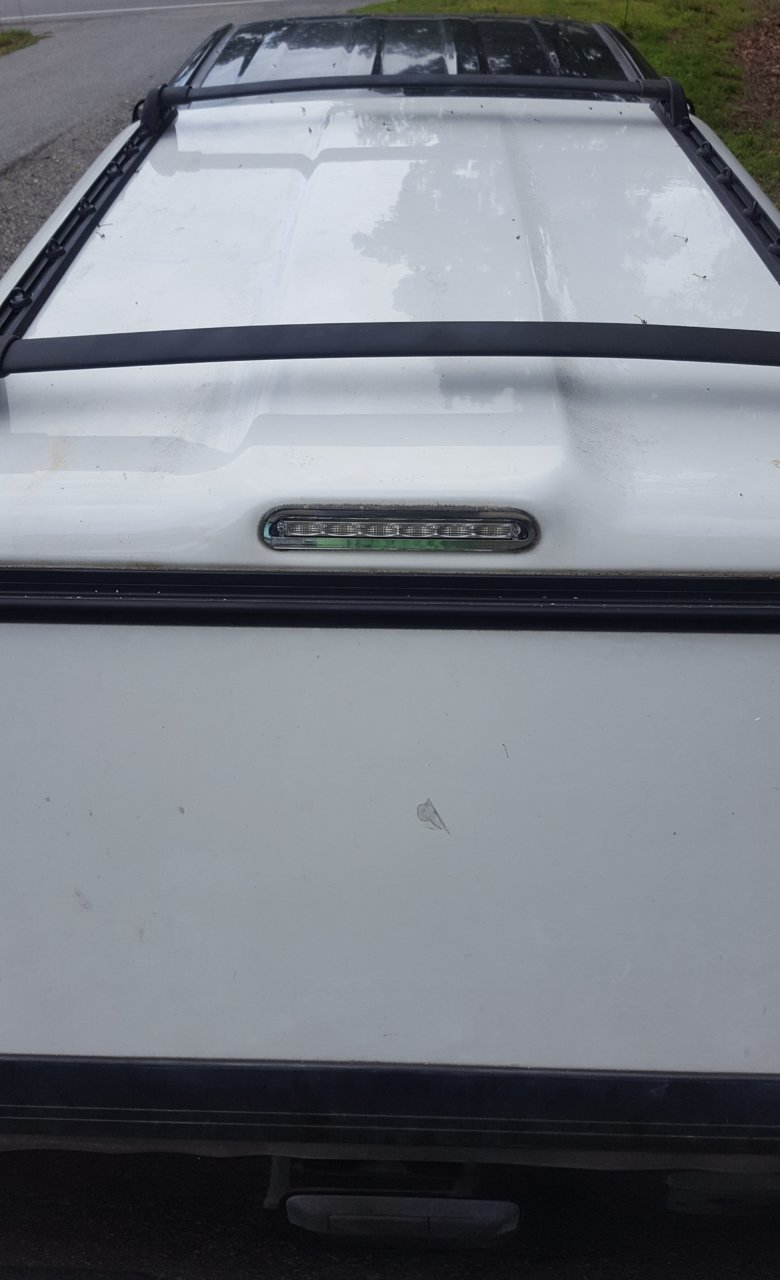

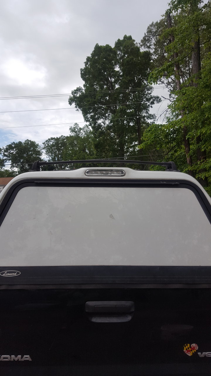

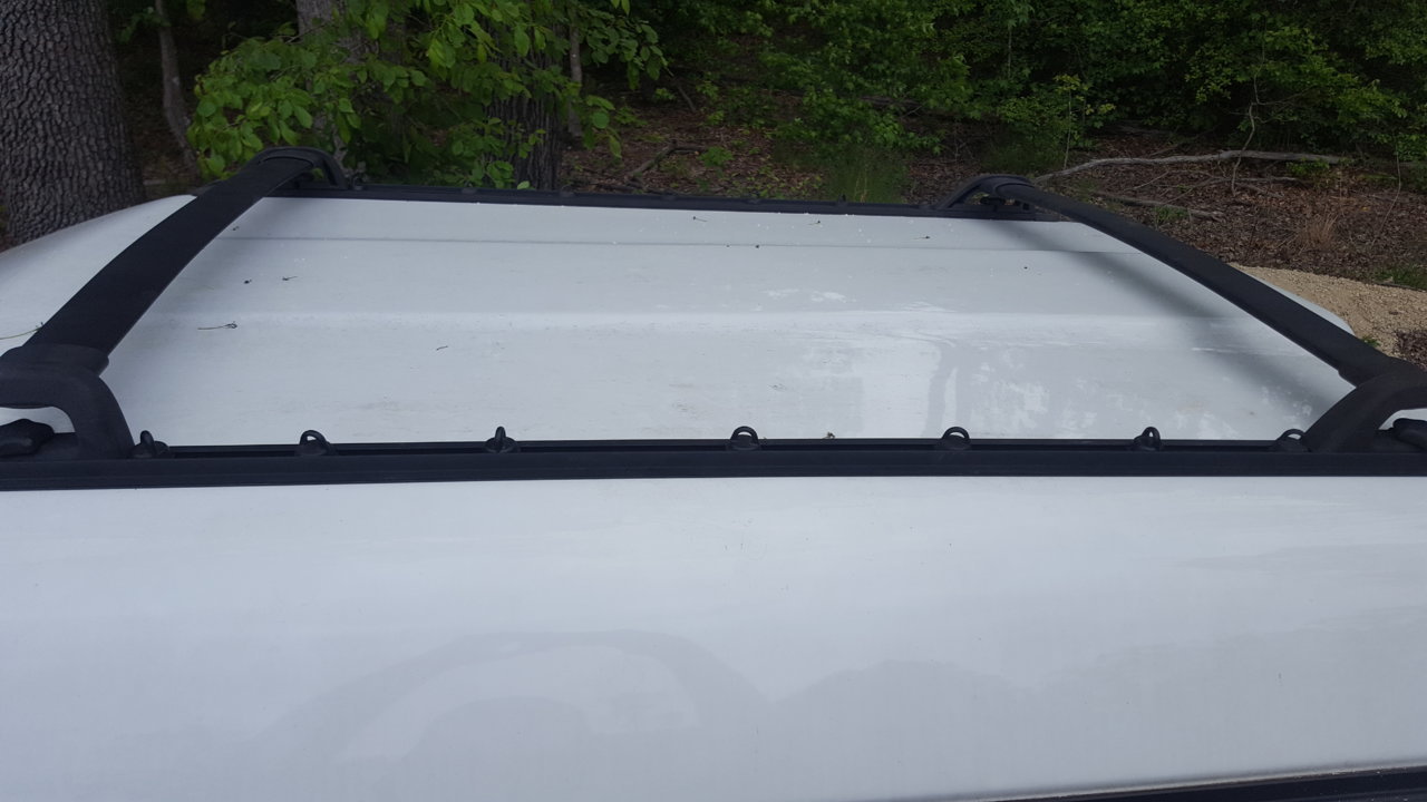

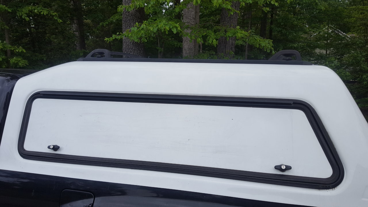

    I pulled a roof rack from the pick and pull this weekend. I ended up using the tracks from a late 90's 4 runner, but the cross bars from an early 2000's Ford escape. I liked those cross bars better and the the t tracks from the 4 runner were heavier gauge than the Ford but they were both compatible.
    There were several SUV's in the yard with flat tops that would have worked fine for this, Ford's, Jeeps, Toyotas, etc.
    I had to get new hardware to bolt it down because it was originally bolted straight to the roof. I hit it with some flat black spray paint to spruce it up. I also had to shorten the cross bars by about 2" but it was easy to do.
    I think it looks really good and now that I have the t tracks I could pretty easily fab wider cross bars or buy them.
    All in all, junkyard was the way to go. I also grabbed several extra tie down rings that for the track from around the yard.
