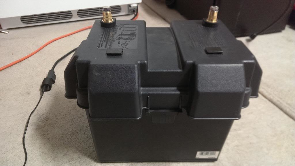

    I am not concerned about winching in the least bit right now. I picked up a set of 8 of these off eBay and they should be in on Thursday the 5th. What I'll probably do is isolate these from the vehicle until the key calls for power at the accessory and ignition position. So essentially once the truck is turned off, it is "dead" per se.

    I am as of right now 50% done with my setup. My goal is to make this a 100% remove/replace, plug and play drop in to fit the stock battery cables and stock tray with zero modification to what is already on the truck (other then the lead acid battery of course :p). So far so good!
