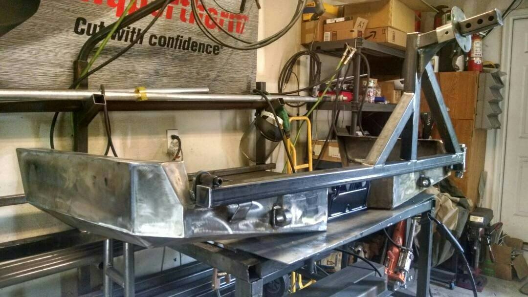

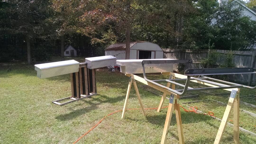

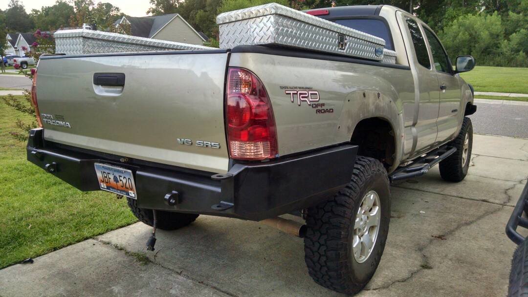

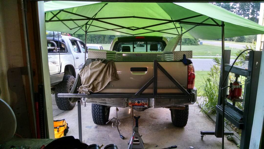

    Bumper is being painted now and should be on tomorrow night. Rack didn't quite get started but that will be Fridays project. Going with a simpler rack design. Basically a two bar rack straddling my side boxes with 3 spreaders and kickers to mount to the bed bolts. I probably won't be able to open to the boxes completely but that's okay. I'm trying to keep the top of the RTT within a couple inches of the cabs roofline.
  3. Aug 17, 2014 at 5:02 PM

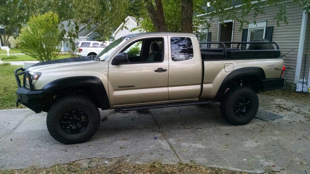

    How did you paint the rims

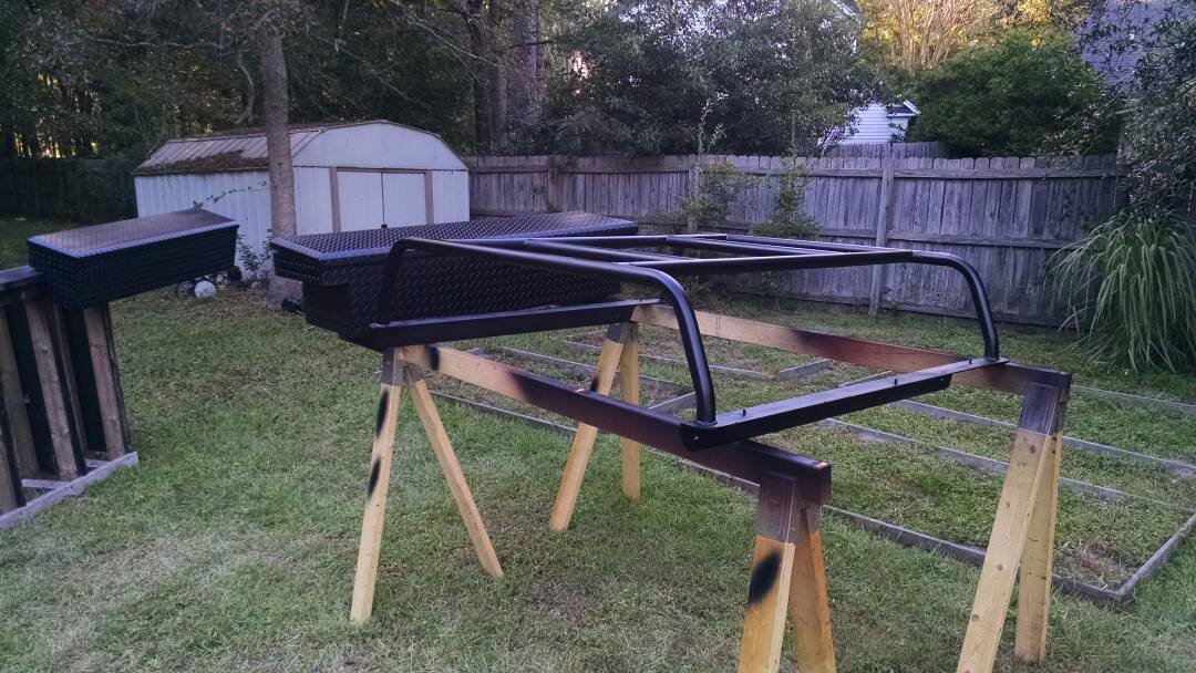

    Pulled them off, cleaned, masked and sprayed them with the same Krylon and Harbor Freight HVLP gun I used for everything else. It was a pain in the ass. I used two quarts for the rims, boxes, rack and flares.

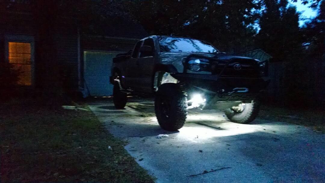

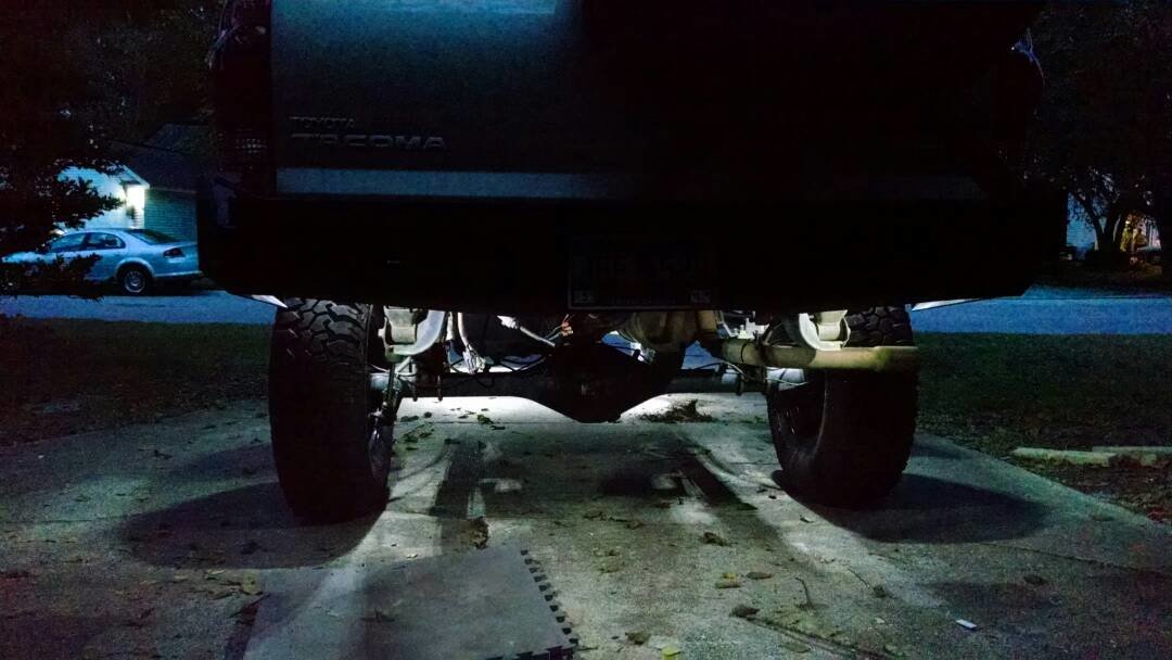

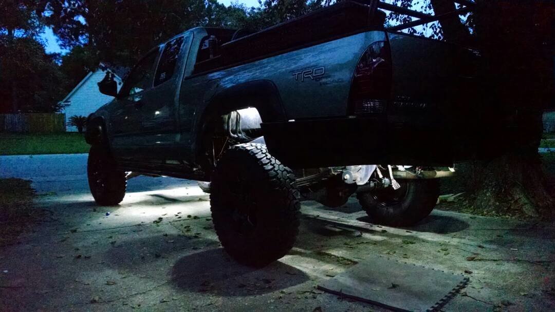

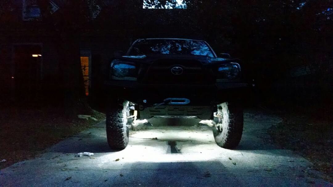

    Rock lights are almost done. Little bit of wiring left to do. There is a long run of wire above each slider that has no lights. I ordered led strips to replace the wires. Should be here in a few days. Hopefully I can splice it in the weekend.

    Pictures from painting
    15ad4ddc0f7e0362a8f7c3c07f288957_35922766effaa19c59b7c66d091369d18eb2bc70.jpg8b6a33015e401626c9276615573aab04_ecc3c1f2cfde559fee66a4a0832f71c3a1d467b2.jpg3b26f59fa8a13cda5ff4443b192f9d97_b66f2348e46937c3719d9ff9a592d3a85244df0d.jpg8c69b5b6e045f8ee06cf15896b1a8844_9e56e03e219937282580a6113772d6ff7bfb2868.jpg
    Gun I used is on sale for $10. The Harbor Freight inline pressure regulator is a piece of crap but the gun is great, even for $20.

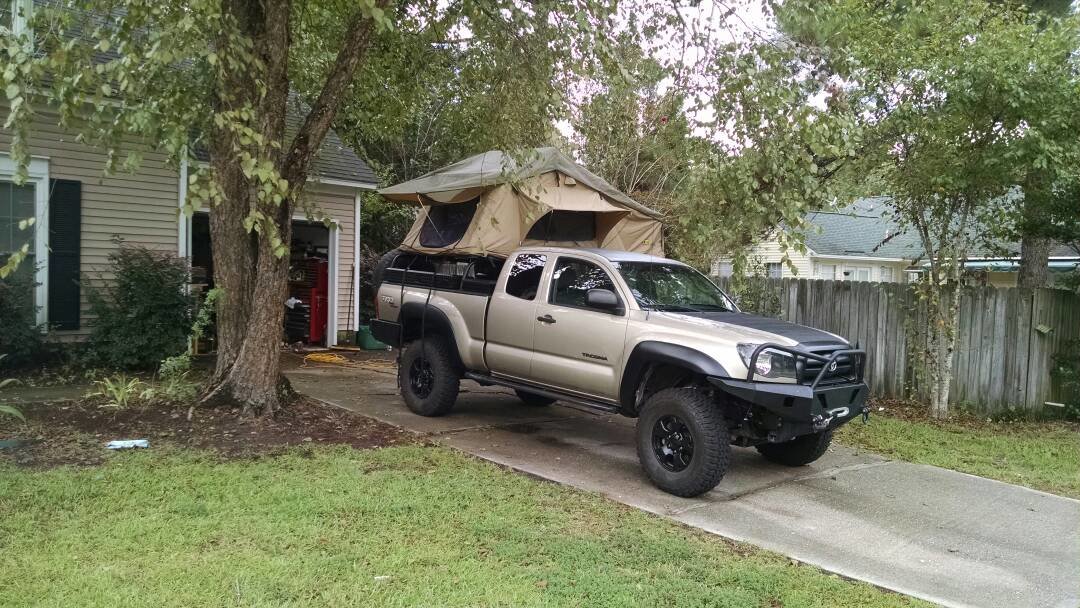

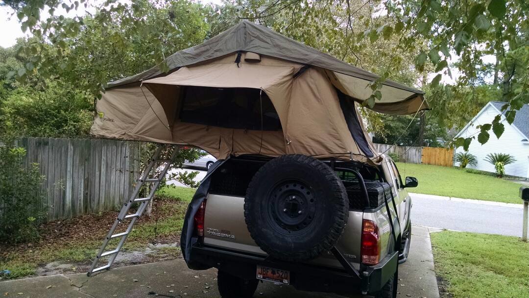

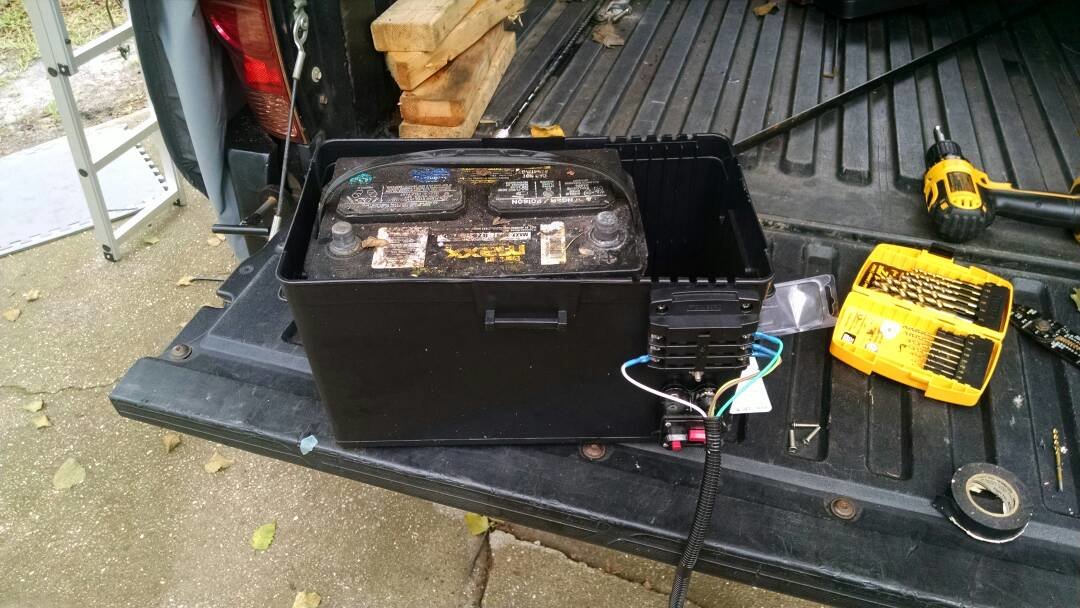

    More work done today. Wiring is done and the switch/relay installed for the rock lights and Offroad driving lights.
    Almost do building my house battery system to power lights and accessories in the bed and RTT.
    Ran wiring to the RTT so I can add LED lights, a fan and a phone charger later.
    RTT is installed and dry. It got rained on during last night's install.
    Picked up a cooler and have it mocked up in place. I have to pull the cross bed box out to put the house battery in place. Debating if I should run a 4g cable from the alternator to the battery to keep it charged or look for some kind of solar setup so it's completely self contained.

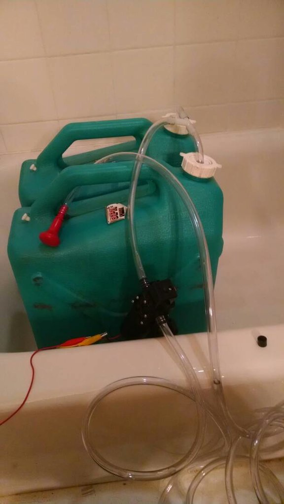

    I'm bench testing my temporary onboard water system now. The jugs are a bitch to get in and out so I'm hooking up a 12v pump I have laying around and a little tubing from Lowe's. This way I can pump water out easily. Eventually I'll have a more elaborate system with a tank under the toolbox, but this will work for now.
    I'm sure I'm forgetting stuff, but onto the pics.

    Here's the truck

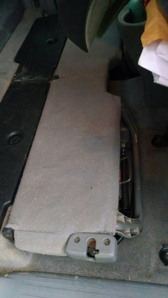

    Under the fold down seats

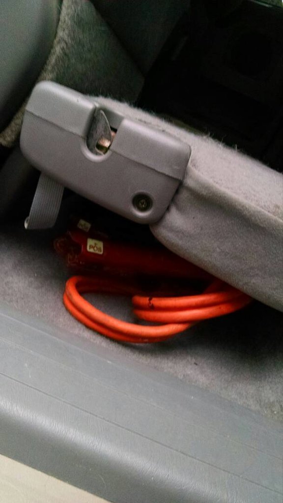

    Bottle jack tall enough to lift my truck. This will be awesome when I get OBA
    ba6e347c4f8710be5574b900184c03ac_97d7fc979470c32fcef1236400d0e5a2caf19200.jpg86174850bab014a6869c1d81875ec9f4_ecb6e87fb95958f7f181da8dfb06dc1a87a9b411.jpg

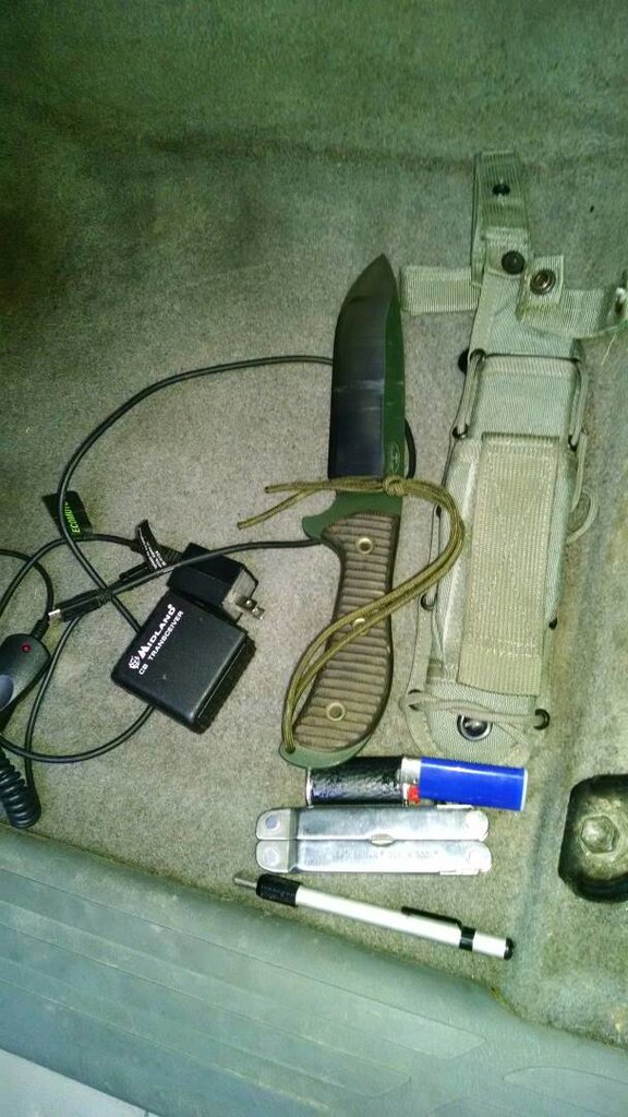

    Driver door pocket: convexed Swamprat Chopweiller, multitool, sharpener, lighter, battery pack and antenna for my CB
