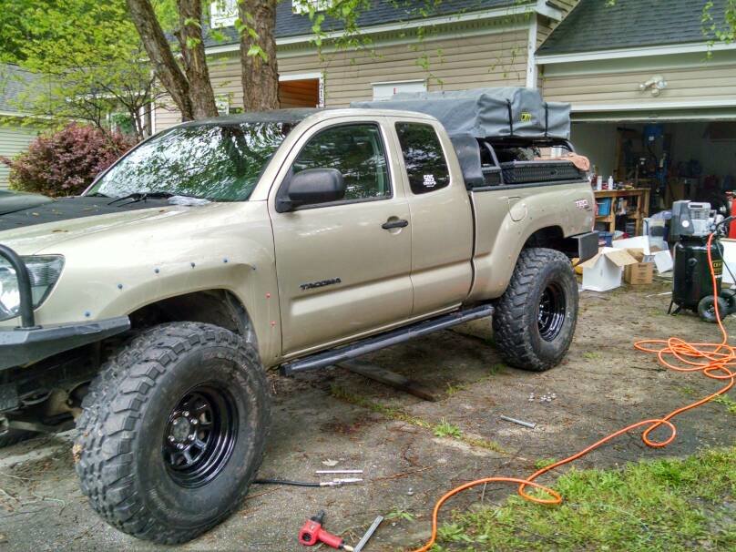

    Had some set backs today but also got a little inspiration
    Had to buy a Cheetah for $200 just to seat the beads. There's grease inside the tires that is a bitch to clean out but will prevent balance beads from working properly. The extended studs I ordered, aren't extended and the lugs nuts only catch about 2 threads. Even with the 1/4" spacer I think I'm going to have to grind on the caliper. Eddy trimmed my rear bumper back 3" which I wasn't expecting him to stop working to do. Probably saved me 3hrs of cutting and grinding with a wheel.

    Next project will be to finish cleaning greasy too out of the tires and get them all mounted with some sort of balancing media in them. Then start sorting out the wheel stud problem. I REALLY don't want to spend $300 on ARP studs

    That. Looks. Boss! :thumbsup:

    IF anyone decides to follow me down this path here's some advice learned from todays experience
    Surplus tires are going to be full of grease. Apperently it has something to do with lubricating the runflat inserts. Not important why it's there, just that it needs to come out. Balance beads, powder, whatever will stick to it and never work.
    I tried brake cleaner the other day. Used two cans on two tires and a crapload of paper towels and newspaper. Didn't work worth a shit.
    Today I went to the local Family Dollar and bought about 5 $1 stiff nylon scrub brushes and a big bottle of blue Dawn dish washing detergent. THAT SHIT IS AMAZING!!!
    I scrubbed the inside of all the tires and they came out MUCH better with less work and less money in cleaning products. The Dawn cuts right through the grease. THe only thing that sucks is getting the water back out of the tires afterwards. I ended up doing tire flips and slams up and down my driveway to get the majority of it out and then a sponge to finish it off.
    Also the $5 tire bar from Harbor Freight is worth its weight in gold. Get TWO. You can mount the tires with just one but you really need a second to dismount them. I only have one so I had to use a prybar as a supplement. It worked but another tire bar would have been much better.
    Also expect a bruised forearm after you finish all the scrubbing. You slam and rub it back and forth against the tire bead the whole time you're scrubbing. Took me a while to figure out where this big ass bruise came from, but that's it
    Thus concludes todays lesson. Now you're smarter than I am. Which isn't saying much
