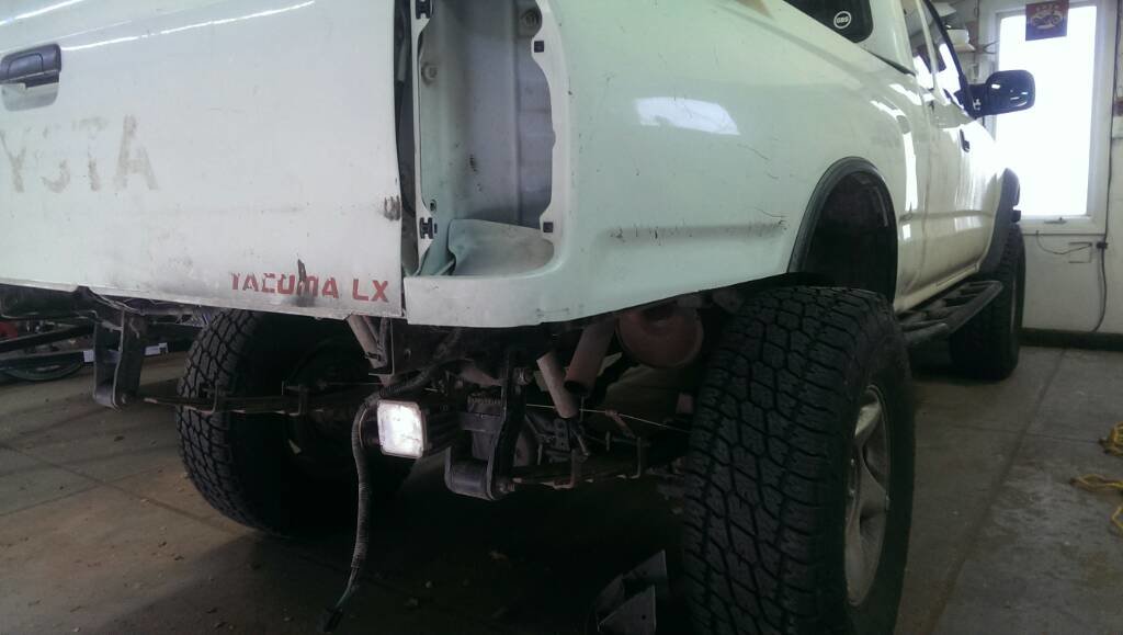

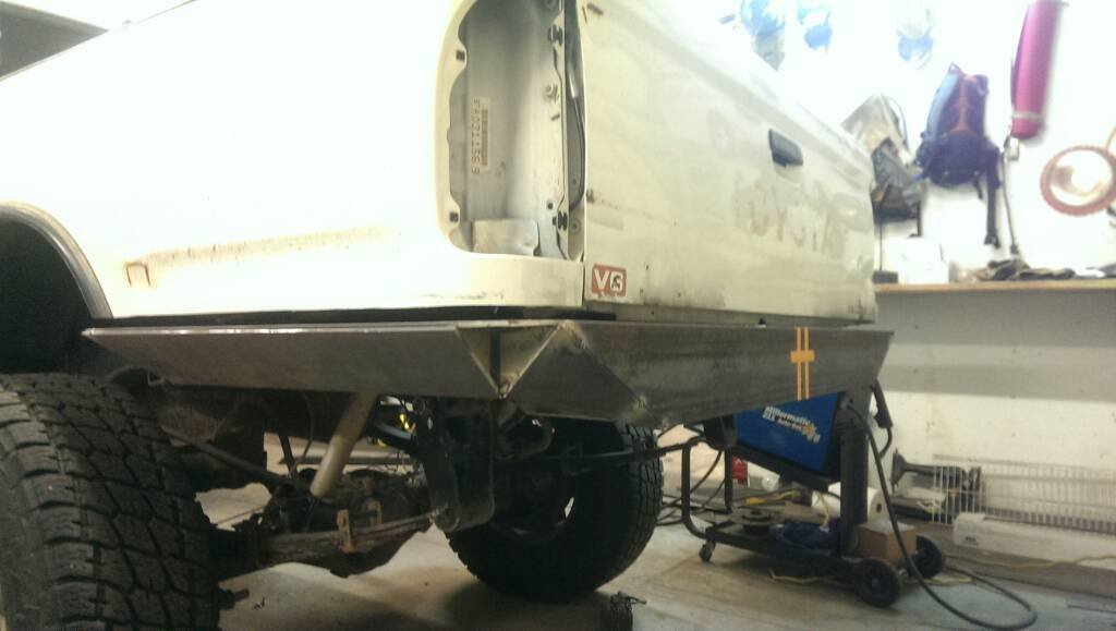

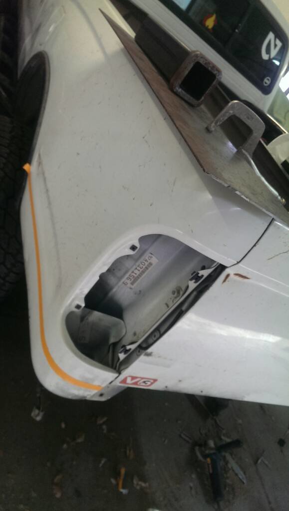

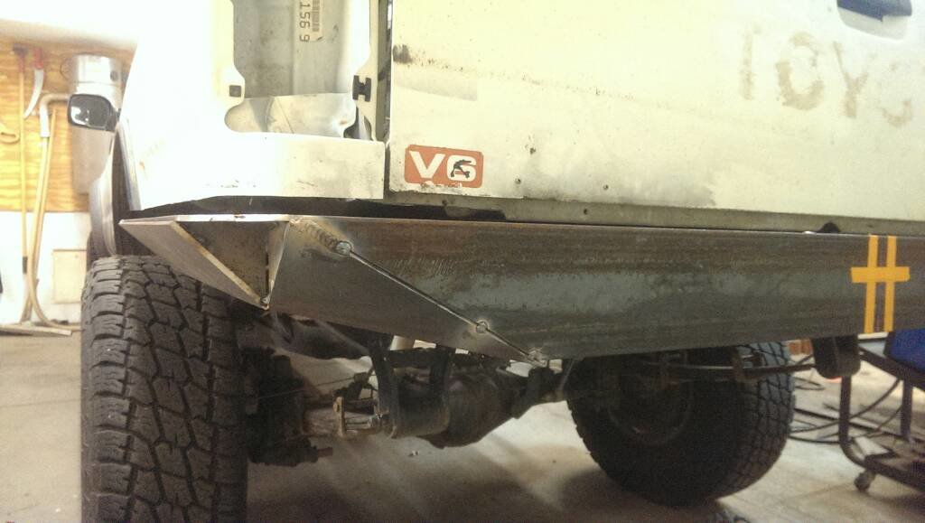

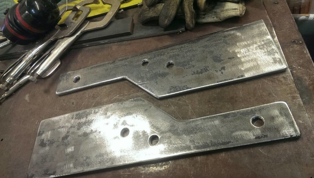

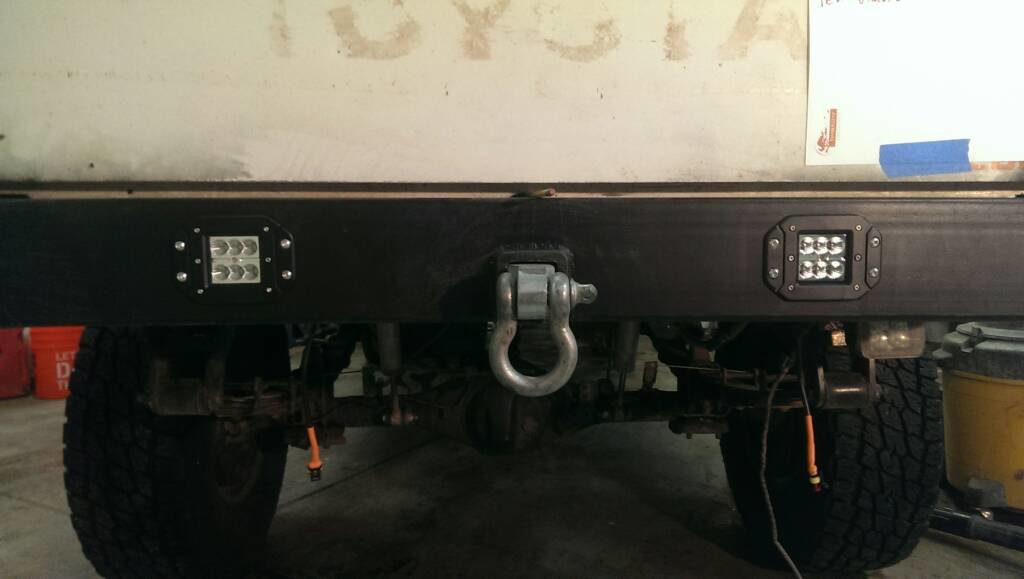

    Didn't take long for me to chop this new bed to pieces.
    Turns out, when you've done it a time or two (or 4) before, the process actually goes reallyfuckingfast.
    The fabrication of bumper mounting plates out of 3/8" A-36 plate, however. Did not go as fast. My drill bits are upset with me now.
    Anyway, new design. Simpler, should be strong and slide off and over objects pretty effectively. Going to finish it tomorrow, it's 90% tacked up now, just gotta add a few small filler plates, install the receiver, and then I'll get to burning it in.
    I may have cut an extra half-inch off on accident...But hey, it's straight.
    Burliest mounts I've ever made. Mostly because I thought what I had was 1/4", not 3/8".
    The tape is there to mark off the hitch location.

    I finished it last night... Took longer than anticipated, but I also wasn't able to get the garage clear for me to begin work till almost noon. I'll take pictures at some point in the next few days, I might just wait till the new lights come in and get hooked up ;)
    On a side note, after some discussion yesterday with a friend, I started wondering about the merits of doing a tiregate style carrier and pulling off the tailgate, reducing the amount of stuff to open to access the bed... Whadda y'all think? I'd build it so the top edge is in roughly the same location as the top of the tailgate, so that a topper would still close on it effectively, as well as skin it with sheet metal so contents can be secured.

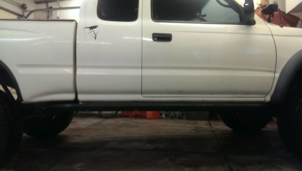

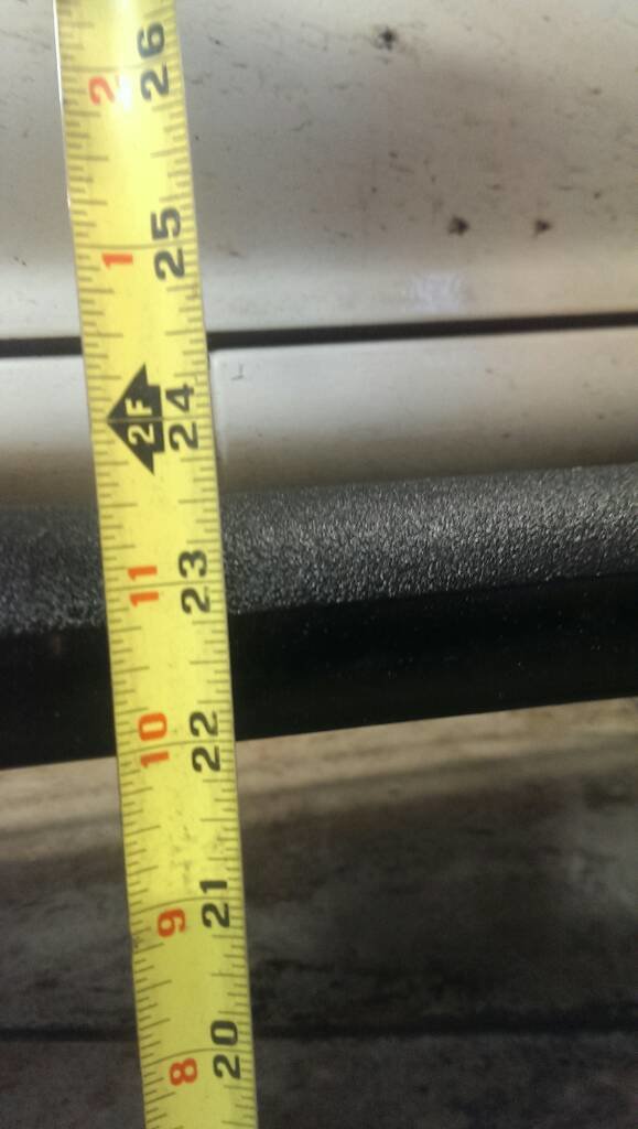

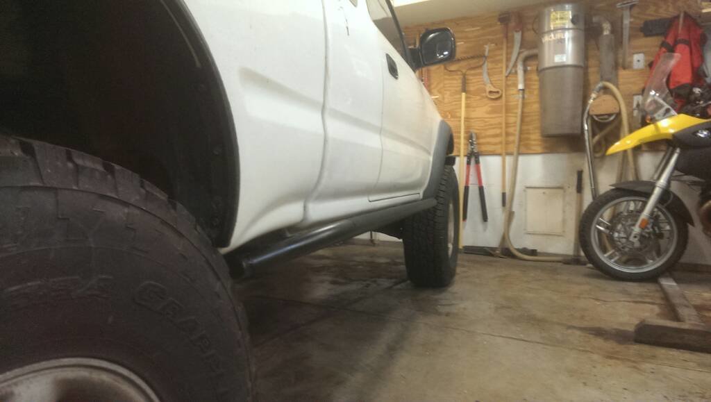

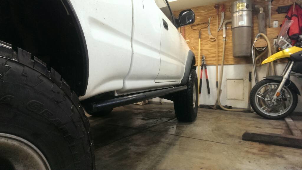

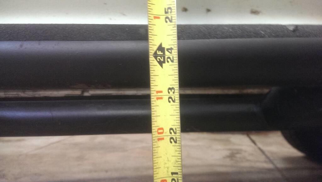

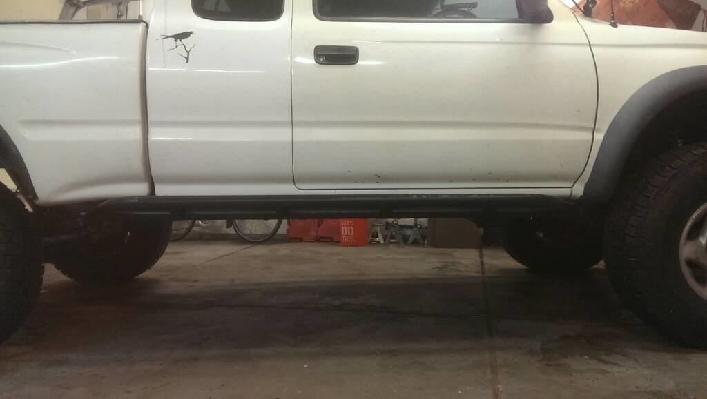

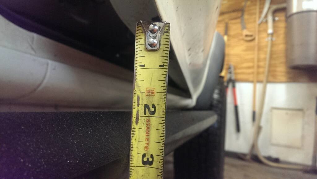

    Was bored today and decided to start on modifying the sliders a bit, they came pre-welded and I'm not a huge fan of the angle they were at. There was a solid 2" gap between the door and top of the tube. So I ran to Denver and figured I'd kill some time.
    Cut off the passenger slider and welded it back on. Closed the gap from the door down to 1/2-5/8".
    Before
    After
    Before
    After
    Before
    After
    Before
    After

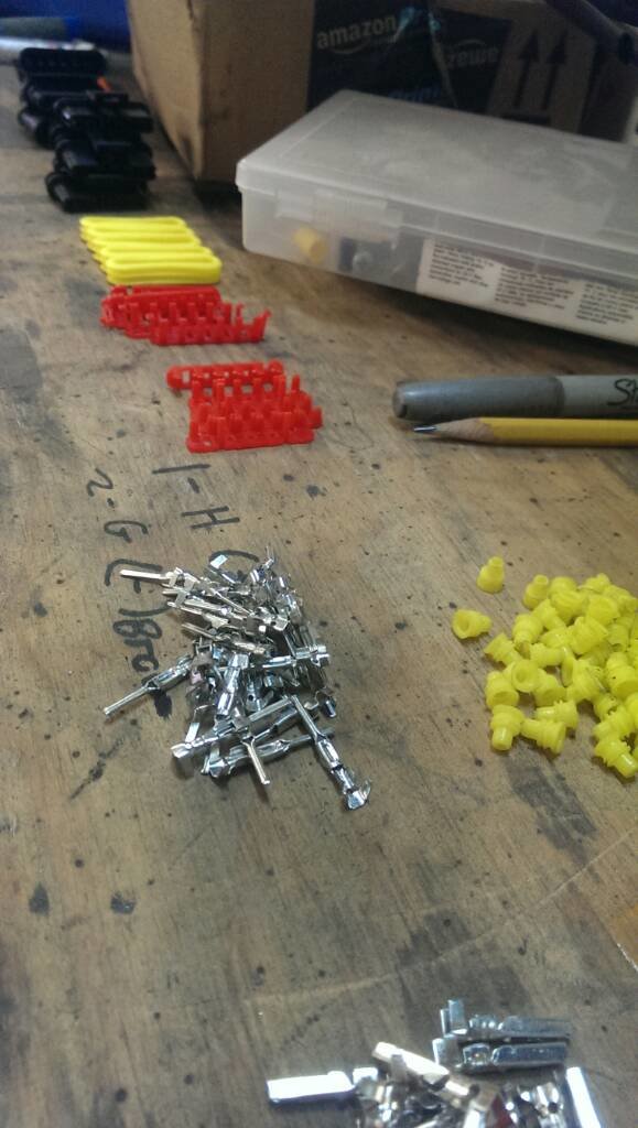

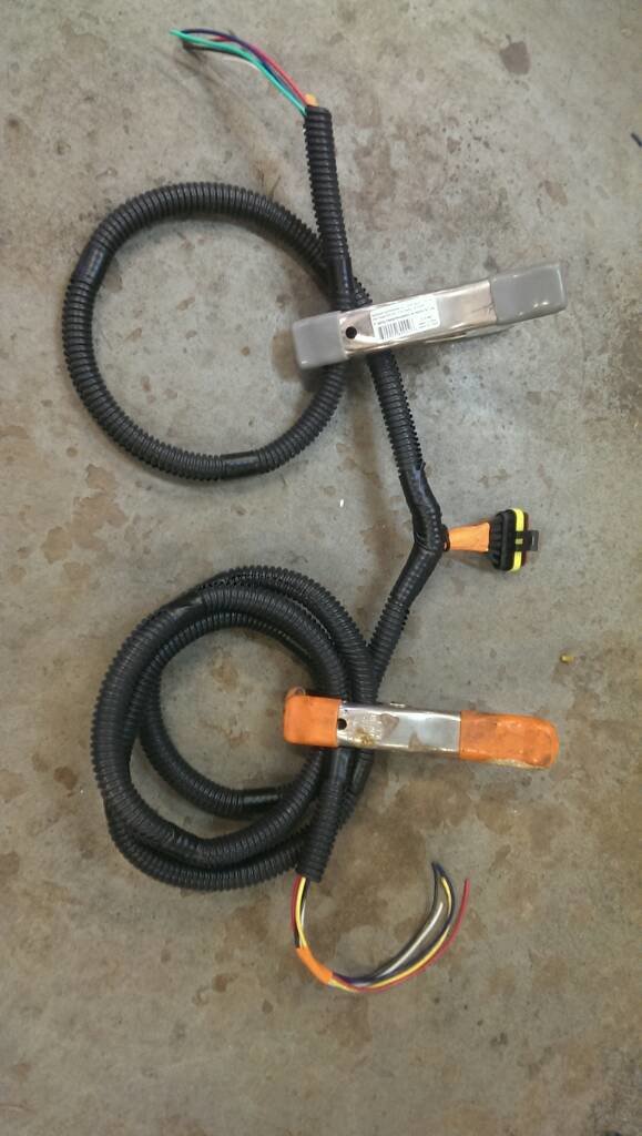

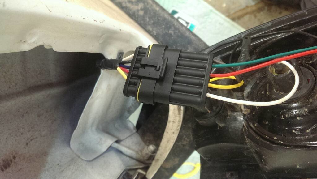

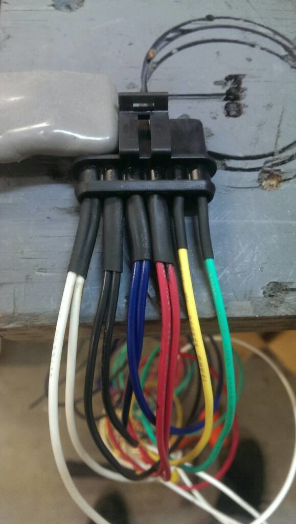

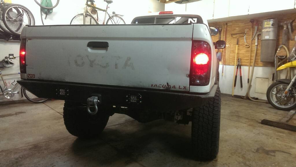

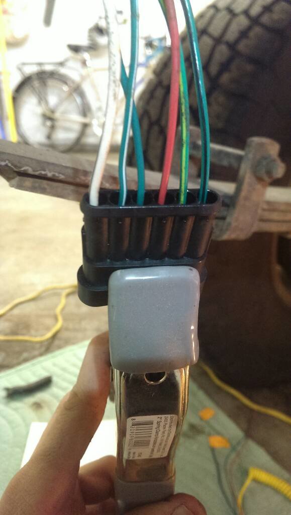

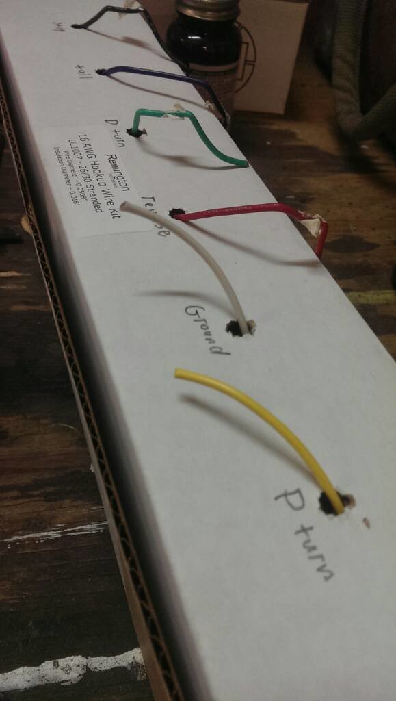

    Finally got around to rewiring my tail lights. After the bed swap I didn't have turn, tail or brake on the driver side, but had very half-hearted reverse. Passenger has most things, but far from perfect. Established a bit ago that the main wires had good signal, but everything down from there got all screwy.
    So I cut everything out and started from scratch. Now whatever corroded wires were causing the problems are gone.
    I don't recommend doing this for the pure enjoyment of it, but it's not a bad way to avoid patching in a bunch of jumper wires.
    Started today by installing the new reverse lights. I had a tap break off in the steel that wouldn't come out, so I cut the head off the bolt that was hoping to live there, and epoxied it into place...you'll never know which.

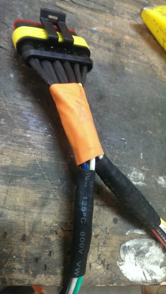

    Weatherpack connectors were the theme of the day. Blessing and a curse, they're reliable and clean, but it's time consuming to get there.

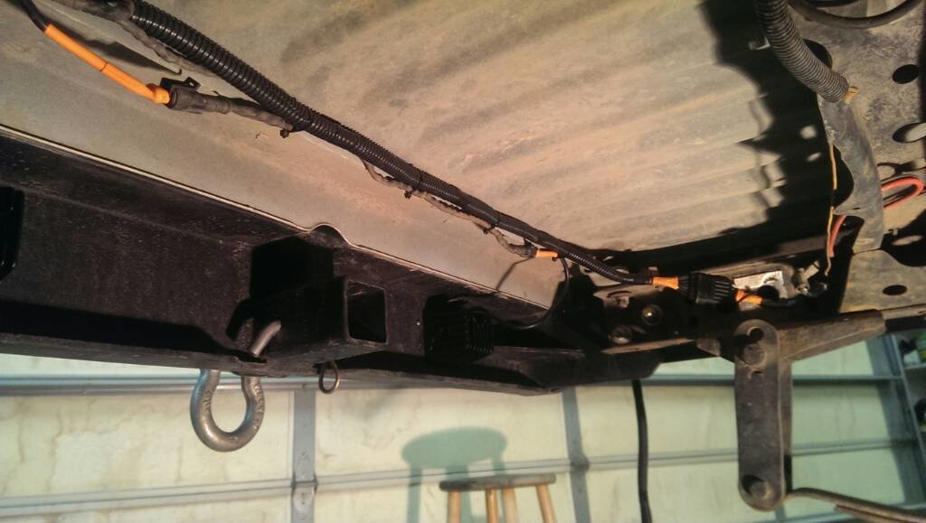

    The wires doubled up are the common connections between both sides, ground, tail, brake, and reverse. The two single wires are passenger and driver turn.
    Ready to go into the truck.
    Connecting to factory wires.
    Nice and tidy! Finally.
    Had to add a connector to the tail lights as well, since I was uncertain as to where exactly the problem originated.
    Woot. All functionally is restored.

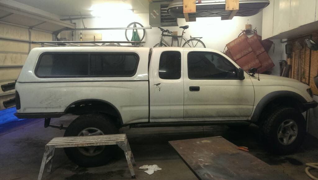

    Craigslist win of the month. $40. Only thing wrong is the rear window glass is broken and door frame is a bit bent. Otherwise it's in terrific shape, even has carpet lining!
    Truck is now too many shades of white, still debating bedlining the whole thing, possibly in white.

    Did you lose width when you cut them off? If so how did you extend them?
  16. Dec 21, 2015 at 7:01 AM
    #396
    capturecolorado
    capturecolorado [OP] Well-Known Member
    Feb 11, 2014
    #122857
    735
    Alex
    Grand Junction, CO
    01 4Runner SR5 with some things attached
    I probably just lost 1/4"-3/8", about 1/8" in curf of the cutoff wheel, and then another 1/8" to a 1/4" from the angle change. It's a subtle change, but it's noticeably better looking, nice to have the sliders a little tighter to the body.
    cynicalrider likes this.

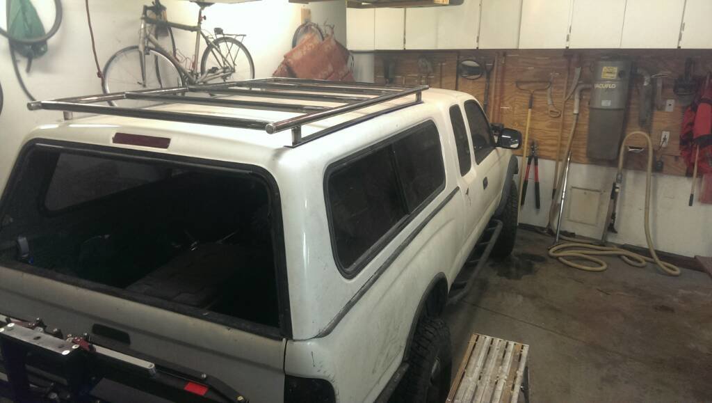

  20. Dec 29, 2015 at 7:02 PM
    #400
    capturecolorado
    Feb 11, 2014
    #122857
    735
    Alex
    Grand Junction, CO

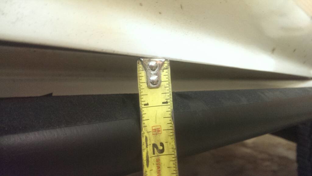

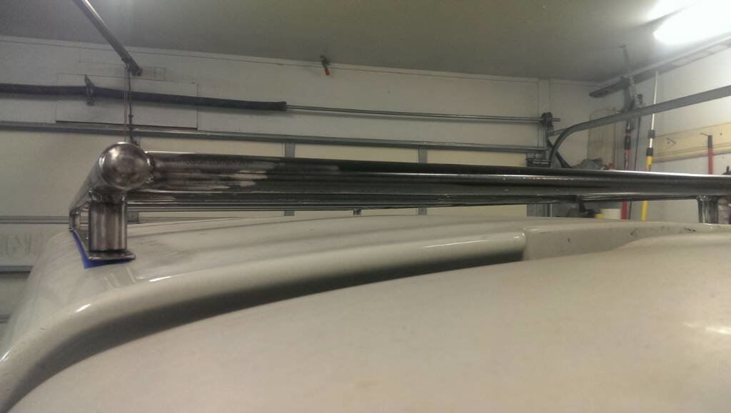

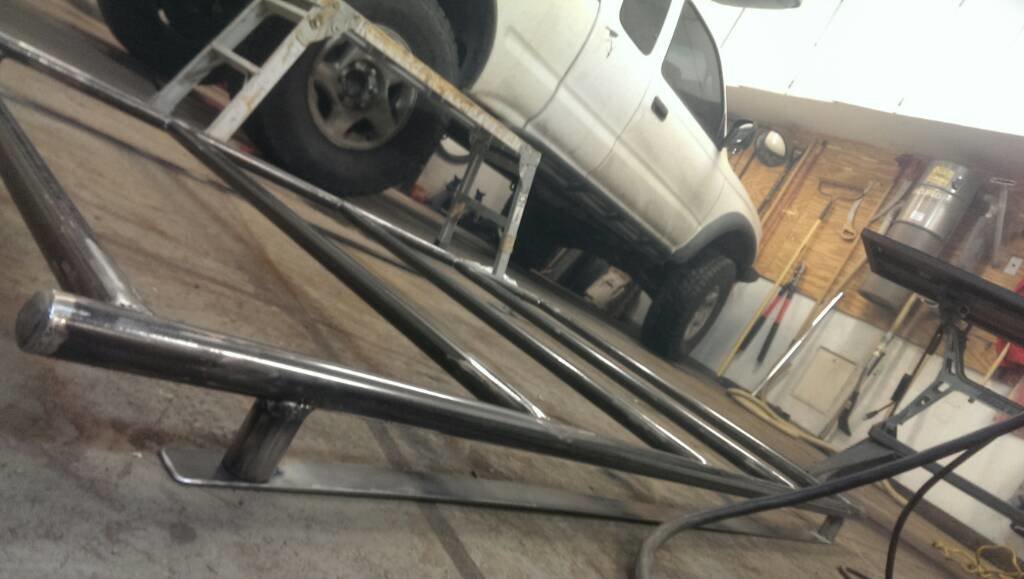

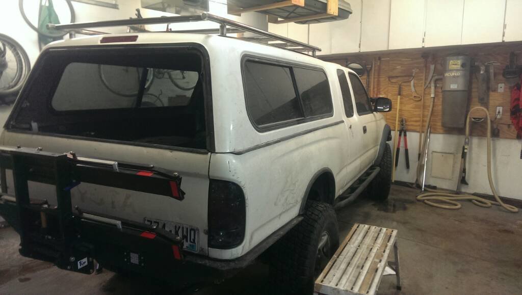

    Started on something new today. It's all 1-1/4" tube, the clearance at the highest point of the roof is 7/8", clearance at the lowest point is 2". Deflection under my weight is pretty much nil, I think it's like 1/4" if that.
    I got the ladder portion burned in as well as the main 4 standoffs, and tacked on the footrail, then cleaned up for the day.
    I tacked the rail on without adjusting for the curvature of the roof, so I'm coming up with a plan on how to handle that.
    Darth-selfie
    My plan is to build a little brother to this that'll mount to the cab eventually to create a nice full platform front to back. The front of the cab rack will also allow for a skinny light bar to be mounted. There's also clearance on the sides for some small led lights for camp/work lighting.
