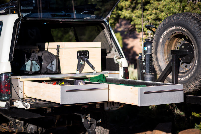

    After extensive thought, planning, and living without the platform/drawers for about two weeks. I've concluded I'm just going to build a better version of the first setup. I wanted to store my bike in the bed, but with my wide handlebars, the bike could pretty much only sit dead-center in the bed with the topper. Not ideal. Plus, trying to stay organized after having those drawers, but without the drawers, is difficult.
    New design is effectively the same thing as the old, just better. I've spent a lot of time studying how TruckVault and Bedslide/Cargoglide build their products to perform as easily and effectively as they do. I don't really feel like building a frame similar to Cargoglide, as it would eat up what little vertical space we have in our beds, so I came up with a solution: drawer slides. Less fabrication, sufficient load capacity.
    The complaints with the old:
    1) Drawers were difficult to open loaded down.
    2) The top was nearly impossible to open loaded with much weight.
    3) If the top was opened, as the "cabinet" that housed the drawers was not enclosed on the top, so crap would fall into the back of the drawers when opened. It was frustrating.
    4) Top, if opened, and loaded, would not support much weight when extended. It was just a sheet of plywood with the aluminum channel.
    5) I don't sleep in my truck, I just want to store and carry gear efficiently. Don't need the edge-to-edge platform to sleep on, but rather would like to be able to pull out whatever is in the bed without losing it into the abyss of nothingness.
    Solutions:
    1) Bearings, bearings, and more bearings.
    2) More bearings. 60" long, lock-in/lock-out drawer slides. Even though the bed is 74" long, and the slider will be 72", I don't need full extension (and a 72" drawer slide doesn't exist, 60" is fine). 60" heavy-duty slides are labeled as 500lb capacity, but in reality that's for 18" slides. The 60" model drops down to 350lb capacity when evenly distributed. Which is plenty for my purposes. I won't extend it with that much weight. Drawer slides also save space, and a lot of time, over building the more commonly used method of roller bearings and square steel (see here).
    3) I will be building a full cabinet to house the drawers, with a closed top to prevent crap from falling into the nether regions of the drawers. The platform will also have mini-walls to attach tie-downs to, and to keep stuff on the top.
    4) The plywood platform will have an aluminum sub-frame to strengthen the plywood. This will prevent bowing inward under weight, and then also add strength to the platform when extended.
    5) The new top slider will be wider (approx. 53" wide edge-to-edge, basically as wide as I can get that will fit through the tailgate opening). The old was about 42" wide, then had fillers on the side to create the full-width platform.
    Materials (so far)
    - 1 pair 60" locking drawer slides.
    - 20, 3/4" drawer rollers.
    - 3 sheets 3/4" plywood. (TruckVault uses MDO, which is basically an easily-paintable version of what I have). Might need a fourth, but to get started three will do.
    - Giant roll of 2.5mm vinyl diamond-pattern to cover the top.
    - 12' 3x3x1/4" angle aluminum.
    - 5-6 pieces of 54" long 1" square aluminum 1/8" wall.
    - 1, 5' piece of 2" aluminum angle
    - Paint
    - Two locking compression latches (maybe), or just some bar latches. I like the look of compression latches more, and my dad has some sweet ones for the trailers that are similar to what TruckVault uses, kinda goes with the look I'm after.
    - Four recessed spring-loaded grab handles, black.
    - Tons of wood glue, biscuits, nails, screws, and clamps.
    It's 'uuuuuuuuge.

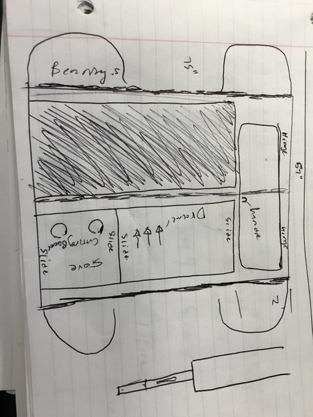

    very good points for sure.. i was originally thinking of making the rollers out of a 3/4"x1" hard maple or something like that, like you said, im hopefuly im going to just have minimal weight in these drawers, so im not constantly lugging around useless crap, but i cant imagine the load going over 100#
    this is kind of my shitty notebook drawing of my set up.. that back part is just genna be a deep storage sort of hatch. for spare parts and oil and such, the front drawers is just for random camping gear, then the right drawer will be for cooking material and have a cutting board and a 2 burner stove up front.

    I've never seen anyone doing hard maple for the sliding part for those bearings, I'm sure it'd work, but I kind of think I'd personally prefer to have them roll on metal of some sort. 1" square aluminum is actually pretty inexpensive, internet price is only like $17 for a 6' long piece of 1x1x1/8", and you don't have to cut/machine any wood for that. Plus, bolting metal to the wood will be stronger than screwing/gluing wood to wood if you use enough fasteners & use machine screws with nuts and washers to attach the metal to the drawer.
    I say do the bearing thing, just toss some metal in there and you'll be golden!

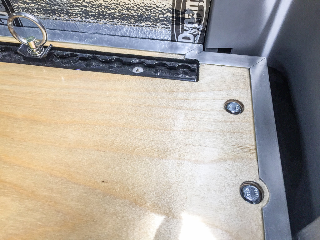

    Primed & painted all the important surfaces... Then I started painting the top after priming, only to remember it's going to get covered in vinyl, so who cares about paint?
    Bolted together the frame. I don't really think any welding is needed, the bolts really just attach one thing to another. I might double up fasteners between the angle and square, not sure if it's needed, but it won't hurt... mostly just a lot of work to remove the top decking now...

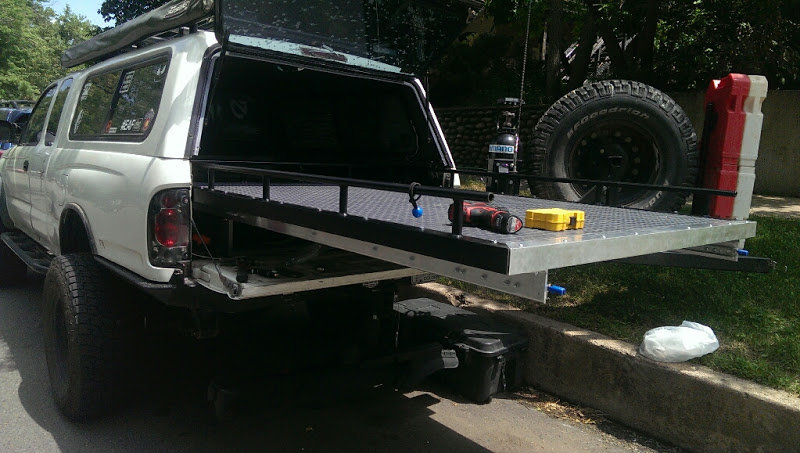

    Weight capacity (theoretically): 350lbs extended.
    Tested weight capacity: me. extended. (155lbs, plus a drill)
    Locks in. Locks out. Has a sort of intermediate half-way lock that keeps it from closing itself all the way...doesn't always engage, depends on how the slidey bits roll together while opening or closing.
    No drawers yet, didn't have time to button those up last week. I'll deal with that later. This top part has been enough of a pig unto itself.
    Built some side and rear rails yesterday. 1/2" sch.40, which is about 0.840" OD, which is a good fit for most tie-down hooks. Strong enough to keep things from falling off the deck, and not super heavy. Welds aren't my best, but I kind of threw them together, knowing they didn't have to be perfect to perform their duty, I just wanted to have it done.
    The top is covered in 1/8" thick diamond-plate-pattern vinyl, bought a giant roll from Amazon for $60, and it was 5'x9', plenty to trim down for this, and it's waterproof. At first I tried using hot glue to hold it down. That doesn't work, don't bother. So today I peeled it back, scraped the glue off, and applied two good coats of contact cement... hopefully that holds.
