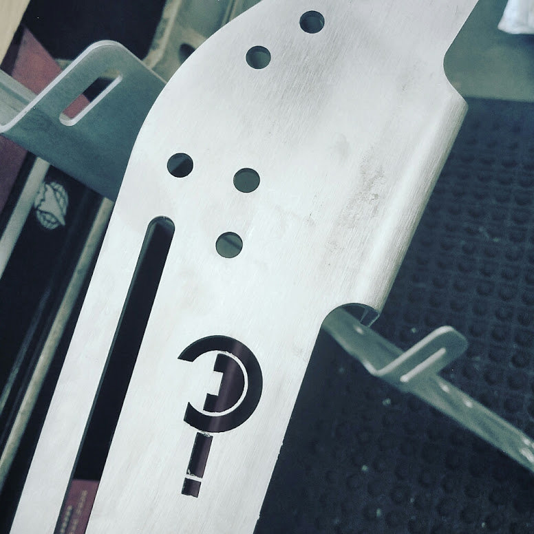

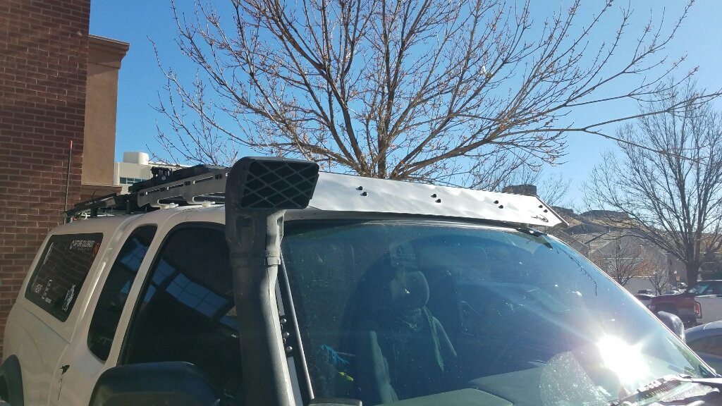

    Can I be one of the cool kids yet?
    n2TmR18PfOsu8JcfaZfSu7CbggcY9e1A2BPOraK2_e41af3d78c00d4a5575953eda3ce6f90885096f5.jpg
    rM2LYeP7xN5uZvwajqjH2ruD0l3HwVWA-Z5gVb4r_13e84ad8904648276ab27748cc1810377b9d238a.jpg
    Paint & rear rack to be sorted out tomorrow. Also some custom machining that I'm hoping to pull off on the cross bars because #tweaker :spy:
    TheSpeediTurtle and BYJOSHCOOK like this.

    Is it installed yet or just chilling there?
  20. Nov 10, 2016 at 2:54 PM
    #560
    capturecolorado
    capturecolorado [OP] Well-Known Member
    Feb 11, 2014
    #122857
    735
    Alex
    Grand Junction, CO
    01 4Runner SR5 with some things attached
    I installed it this morning... I was tired of waiting! Went into work early and laid everything out on my bench. I still need to go over everything with silicone, and one of the plusnuts isn't very happy, might need to just weld it in place... it kind of snagged one of the roof supports and went in kind of crooked.
