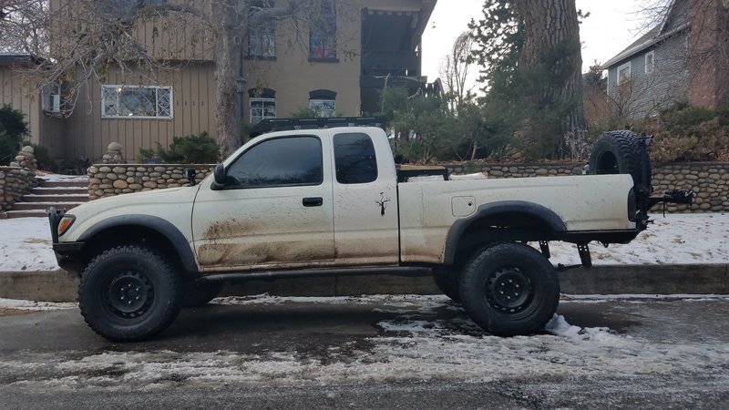

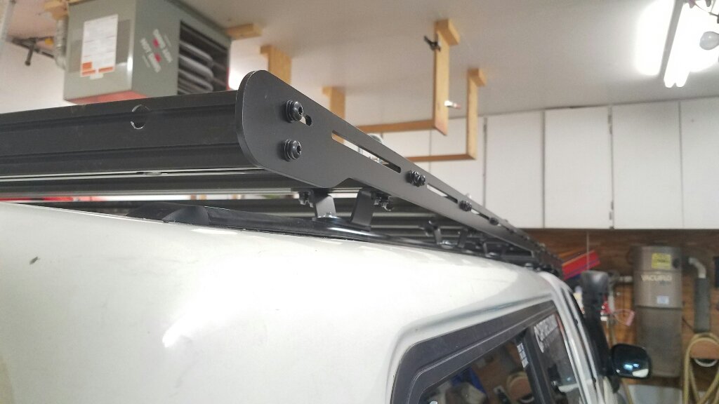

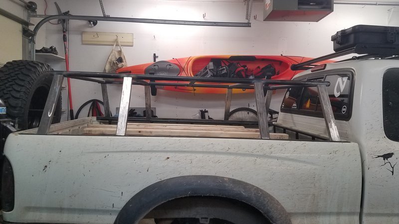

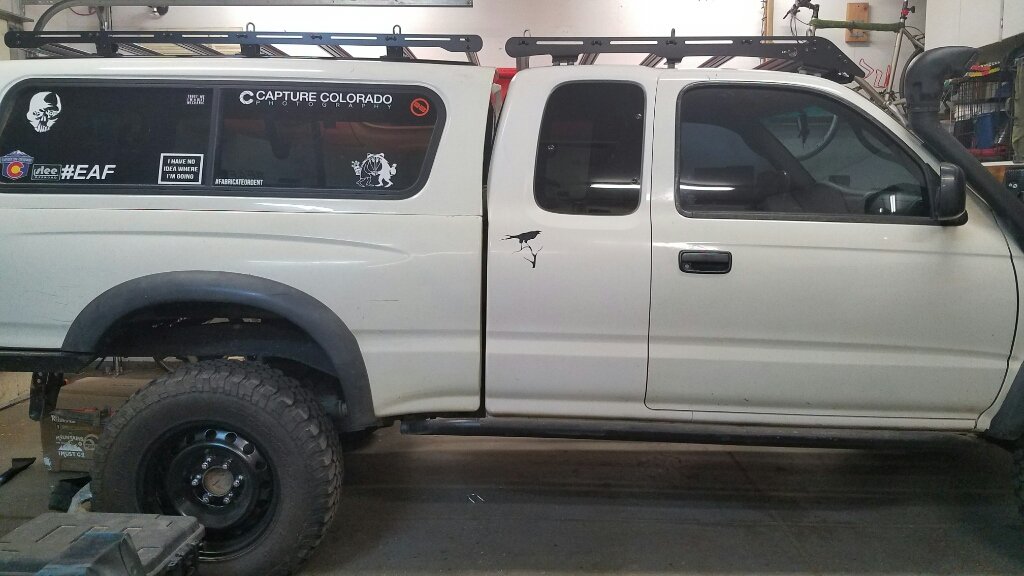

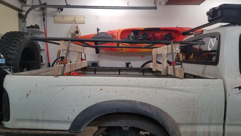

    Prinsu time.
    Still have some tidying up of minor details on the topper mounting, but otherwise it's good to go.
    1No_eRLXq60l_mKiIgUE5zE5avT8uFxpgzP4CXtF_ad5d6e9c340d3c89e74da2c9d715f926c7798137.jpg
    _w3KmurcnhnDs3oPjjifeW3jF2DJvq_jW_DDTgp__7694b6adfb05ccd69869b8c9760c58d860bc9552.jpg
    XuglKWajpNmKnWbkLkhWpvYbYP41e0a-LxkqaNEo_f196975877790cad7f7388fcd6917acd272b7f0d.jpg

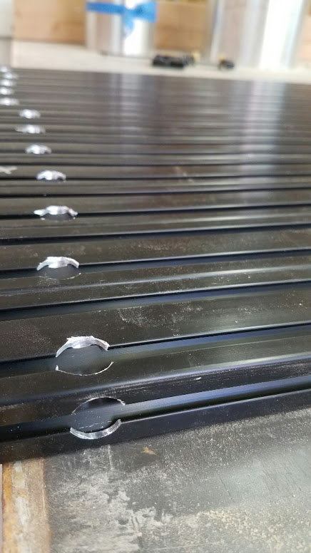

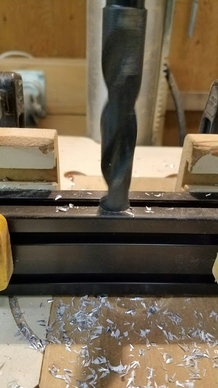

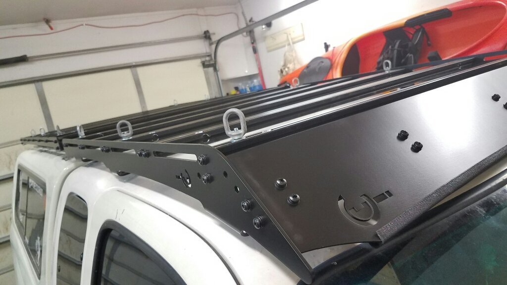

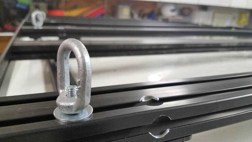

    I don't think I've seen anyone do this on anyone's Prinsu, but one of the features I love about the Rhino Rack and Front Runner racks, is the access holes for hardware. I didn't wanna have to unbolt the cross bar any time I wanted to add or remove a tie down, so to the drill press I went. 5/8" bit, stopped just past the shoulder worked out perfectly.

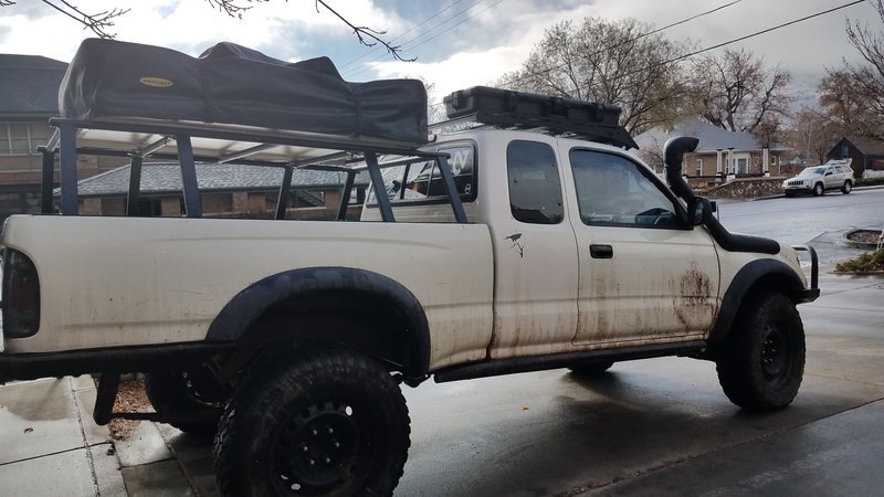

    Digging the new rack setup. How high above the topper does your bike sit now?

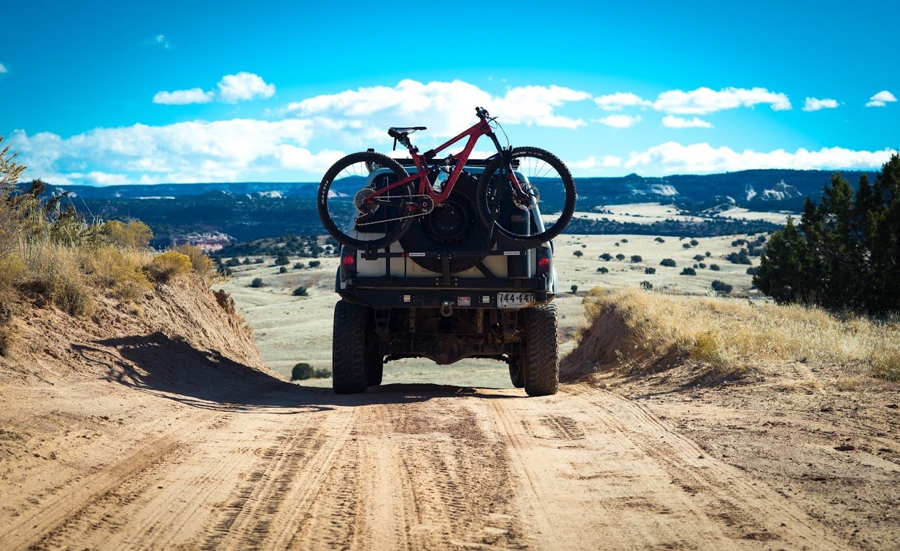

    I haven't actually measured... It's definitely higher than the last rack, which wasn't my intention, but I'll take the clearance! I'd say it's probably between 6-8" above the rack.
    On the bottom is Grand Junction's light... upper right corner is Moab. MOOOAAAAB.
    Every now and then I think I don't need the topper... then I drive through rain, or mud, and watch my friends dealing with their stuff all caked in mud, and I feel differently ;) Although I do miss being able to have stuff on the front side of the bed easily accessible.
