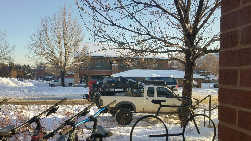

    I'm digging the way the truck looks these days.
    DtzU3E73yLTCWWpM19dyFNsNYQYjaPxrEHeXsjd__46373619957aeca32f25f6d0d3928285fdfb191e.jpg
    I don't actually remember the last time I saw the truck clean...
    gk64M9rh31nb-IoEHVlBGfHZoU0TvHVe5qy_QfC2_f128830e8d27bfa3aa6e098d354aa5b0b2bd3a51.jpg

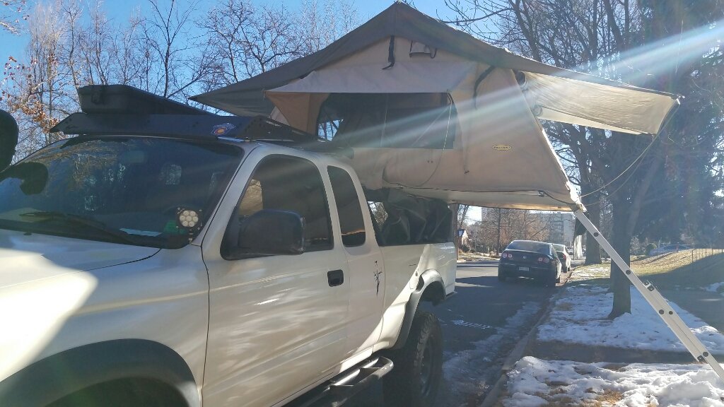

    My family wanted to see what this tent thing was all about, so I opened it up while the temps weren't abysmal.
    2jJ_e7J1kQQMAU3lhjoNrOXrAIHYKAk2RIahi8NE_9d08a14d1c11e1888ca9901e497da3fcae5587ad.jpg

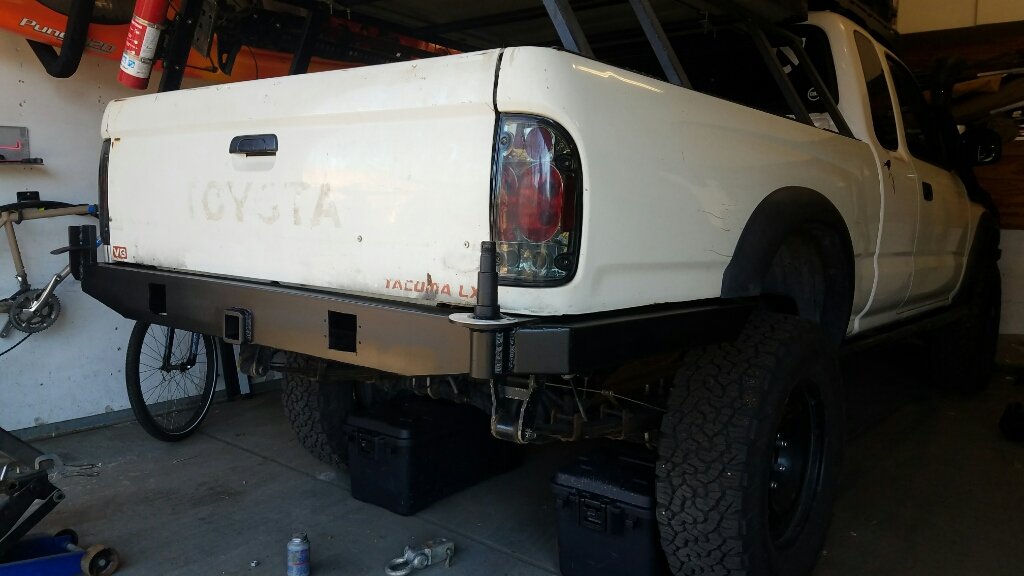

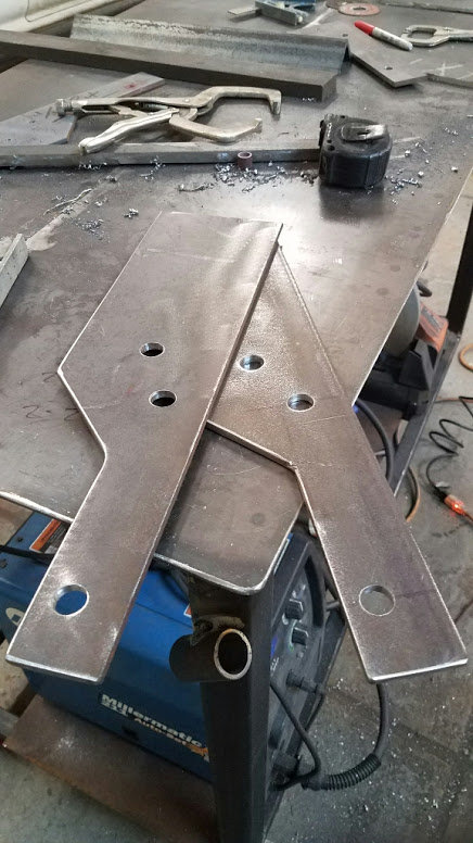

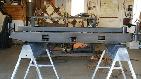

    Updates.
    New bumper, changed some dimensions of stuff, but mostly wanted to add a piece of 2x2 1/4" tube to reinforce the bumper for towing, as well as relocate the spare to the bed, and have the ability to put two bikes on the swingout. So rather than modding the other one, I decided to start from scratch.

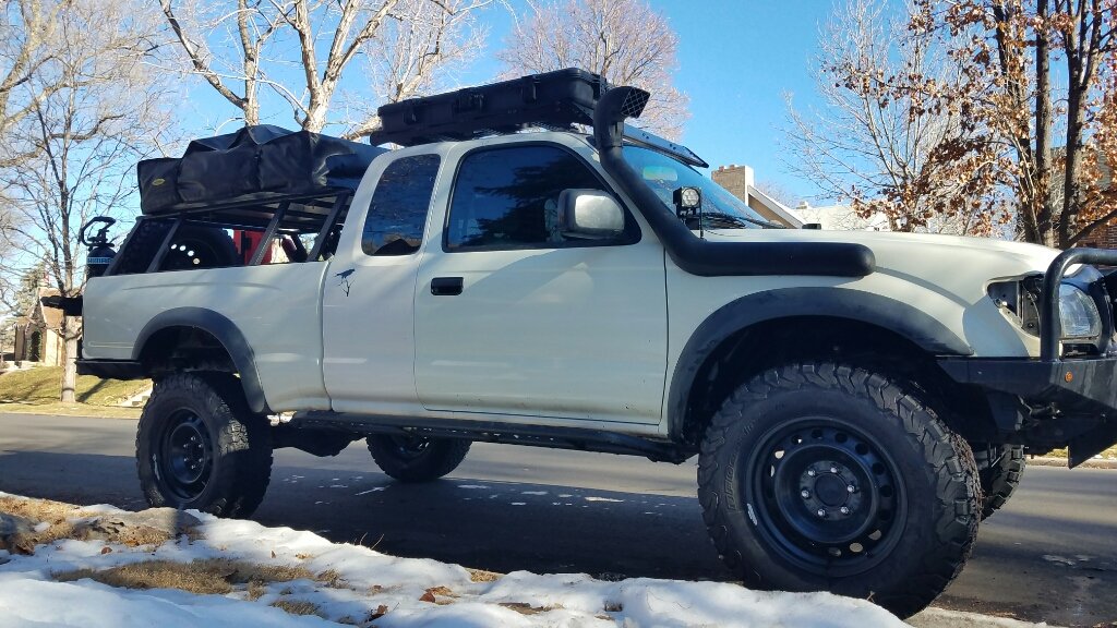

    Man, I need to paint the tailgate.
    And repaint the doors/fenders/hood.
    7mydDRV2WLZivotiniVV0mDo_5ql5udv1y6iYCpy_118d8065fc52874aa3e4479f456a766702a857b0.jpg

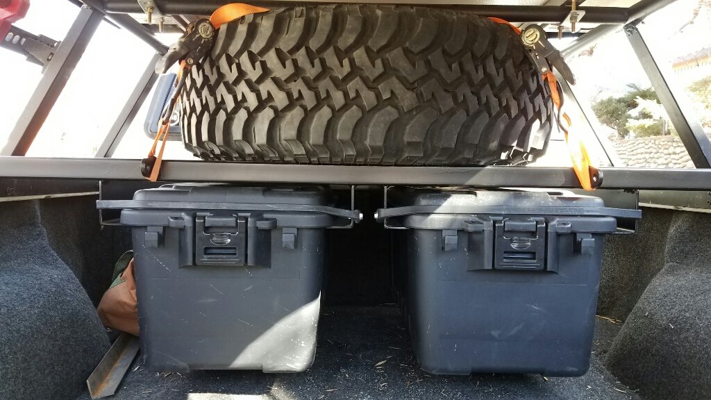

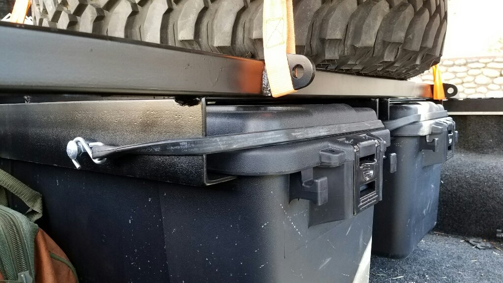

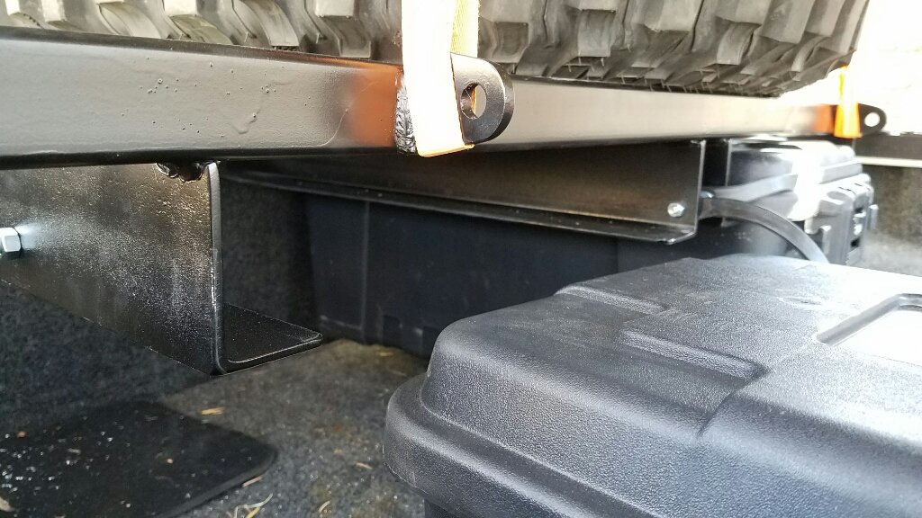

    I debated for a long time what to do with the spare. Put it on the floor? Stand it up (it doesn't fit)? I finally decided the best option would be to put it up high, so it doesn't take up bed space if I need to carry long stuff. Then I wanted to be able to stash the containers somewhere without having them rattle and roll around, but also not have the brackets eat into cargo space too much when not in use.
    The solution I came up with was simple and straightforward, two pieces of 24" long 3x2 angle, set apart just far enough for the bins to slide into with ease. They butt into the front of the bed, and then I used a rubber bungee across the front to keep them in place. Sometimes the simplest solution is the way to go... I had grand plans of draw latches and other crap, but this does the trick nicely.
    I've got space on the front passenger side for a 7-gallon water jug and a 12v pump that'll run a line out to a Front Runner tap on the back of the bed rack for drinking and cooking.
    ALz7BlxY1CEzG3altAg6qUQaCDP3iJoulPp-Ijll_208b2094fc282ea5af52ea1bde84926f13a8e9ee.jpg
    HTmRVcjJs_yEqpDS75XLCCa7P37IgCF0A4uZmvLK_45ad8ecd37309064967d492963904db8d72b996d.jpg
    Yes I know the ratchet strap isn't through the hole. It's too long, I'm gonna fix that later.
    P0z9chUCCPvYICWOA2PG-nxzyRKV_QD_M62Bp1ZT_e9f5f24cbc2eece5ef5ce24250fcc2888115a9c5.jpg
    Not bad for a poorly thought out project.

  12. Feb 5, 2017 at 8:11 PM
    #612
    fiziks
    fiziks Well-Known Member
    Sep 4, 2014
    #137619
    451
    Isaac
    El Paso TX
    01 DC Prerunner 4x4 5pd Conversion
    5 sp 4x4 conversion, OME lift, SCS F5s
    Doing anything with your old rear bumper?
  13. Feb 5, 2017 at 8:13 PM
    #613
    capturecolorado
    capturecolorado [OP] Well-Known Member
    Feb 11, 2014
    #122857
    735
    Alex
    Grand Junction, CO
    01 4Runner SR5 with some things attached
    It's going to @alee891
    jubei and alee891 like this.

    Two questions about the new rear bumper:
    1. Will you be adding provisions to hook safety chains up for towing?
    2. How will you be attaching the two bikes to the swingout? If I recall correctly you had adapted some Thule trays to an upsloped design. Sticking with that configuration?
  17. Feb 6, 2017 at 8:56 PM
    #617
    capturecolorado
    Feb 11, 2014
    #122857
    735
    Alex
    Grand Junction, CO
    I'm either going to drill two 1" holes in the bottom of the channel for hooks, or weld on a loop for the chains to the receiver itself. I'm leaning toward the former, since it's less of a hassle (except for the drilling two holes in 1/4" plate).
    I stopped using that thing a while ago, but my plan for this is to get the folding mech for a Thule T2 rack and attach it to the swingout, which would allow the rack to fold up and out of the way, and requires very little creating of any parts... even though it costs $190.

    Love that idea for your spare. It's funny because I've been agonizing over where to keep mine as well. I really don't want the weight of a 315 hanging off the ass end of the weakest part of my frame.
    I like your solution because it preserves bed space and also allows the spare to sit right over the rear axle. Very nice!

    Thanks! I'm pretty happy with it so far. My biggest complaint is kind of a given... kinda difficult to see :anonymous:, but I'm used to not being able to see right behind me anyway, this just limits the blind spot check area a little more for backing into parking spots and such. It's nothing compared to driving around with a Softopper anyhow, ha!
    I think it's a great option to the other solutions I've seen, especially with bigger tires. Easy enough to build and try out.
