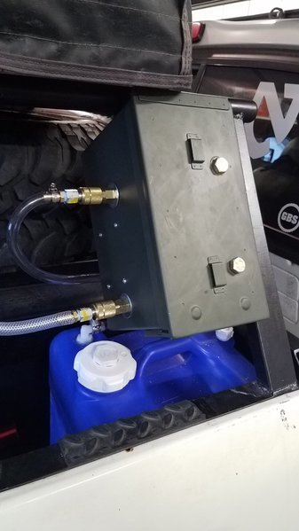

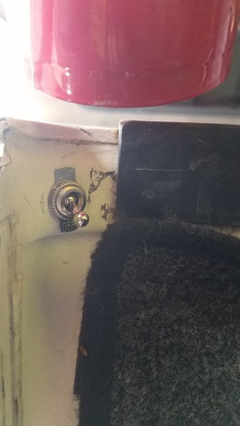

    The last several weeks have been filled with various major maintenance, trying to thwart the steering vibe at speed. I replaced front wheel bearings, upgraded the clamshell needle bearing to the ecgs bushing, then discovered the rear wheel bearings had started to develop play... A lot of it. So add that to the expense list.

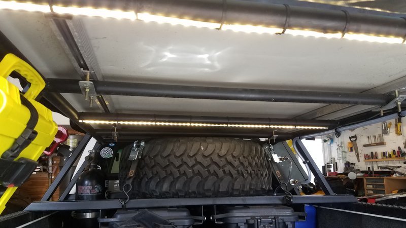

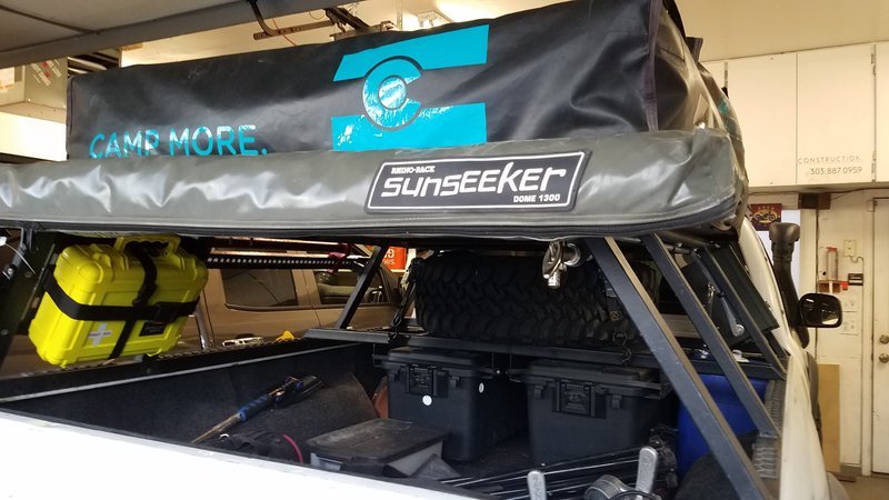

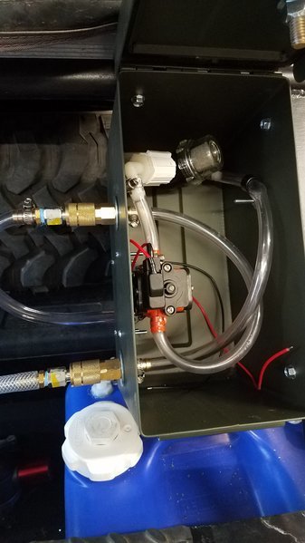

    This weekend I had to house and dog sit for my parents, and since the trails were muddy Friday, I decided to tackle a bunch of little projects that I haven't been doing as a result of maintenance taking up my time.
    On the list was:
    - install vents in bike gear box
    - plumb in water tank with frontrunner spigot and 12v pump
    - install bed LED lighting
    - mount CO2 tank in bed
    - deck plate mod
    - install LED lights in the tent (turns out my plan was thwarted by available technology)
    - contemplate where the hell to put my two Rotopax 4 gallon cans
    - mount rhino rack dome awning off the back
    Most of these got done. The RTT lights almost did. I had planned on powering them from a lipstick USB charger, but I discovered that the 5V output is insufficient to power the lights . So I had to scrap that plan until I come up with an alternative power source.
    As far as the Rotopax situation goes, I can easily mount one on the passenger side of the bed rack, and make it hinge out so it doesn't permanently block side access to cargo. But I don't necessarily want to stack both on that side, it might be too thick. Option B is to attach the two to my swing out, blocking the tailgate. Anyway, I basically want to be able to carry 8-10 gallons of firewall before making the trip to overland expo, without putting them on the roof.

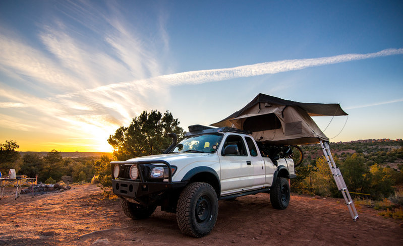

    Moab! Three more nights in the RTT.
