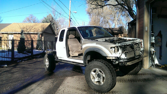

    Yesterday (I didn't get any pictures) I got the engine bay 100% back to factory spec, I didn't put my relay panel back in yet, but I did take a minute to drill a nice big hole for the cabling to pass through the firewall, and used one of the old drain plugs from the tan body to keep it mostly sealed. I'll get around to that later. I also got the dash entirely back together, carpet in, and will start on the headliner and remaining trim this morning.
    I believe the only things remaining to do that aren't interior prettyfying things, are bleed brakes/clutch, and connect fuel lines, then battery. One thing I overlooked, is the original fuel line on the original body used a flex line that slid over the end and secured with a little clip dingus... the donor cab had fuel lines already on it - which I left - and the main line uses a nut and flared end.. not sure what to do on that. There's also one line on the old cab that was 10" longer, this isn't the case on the donor cab, I'm sure I can just get a longer flex line and call it a day as far as that goes.
    And finally: I'm going to see if I can get some 045 paint mixed up for me locally to spray the doors, fenders, and hood. If possible I want to paint on Monday.

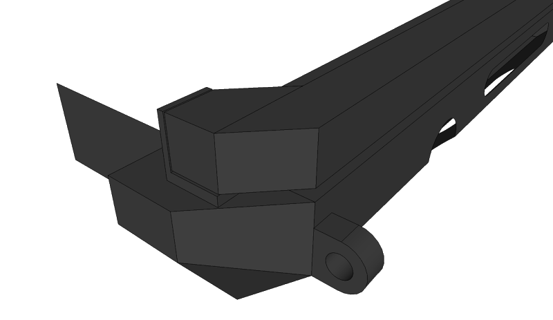

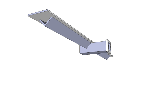

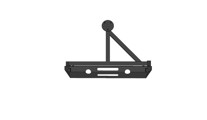

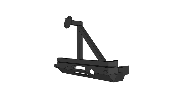

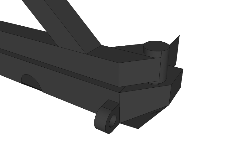

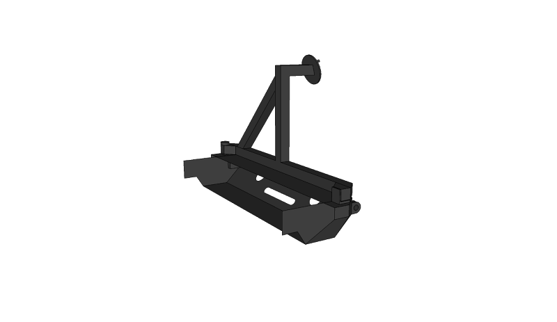

    Got a head start on designing the rear bumper... Probably going to get something mocked up on the M416 box tonight as well to kind of dial in dimensions.
    Basically I wanted to come up with something that'd be lighter weight than the tube-based design I've got right now, and would work well with the way the M416 box will integrate onto the truck with a flatbed. This also reflects some of the details from the front bumper nicely for continuity front-to-back, as well as beefs up the hinge mount and located it almost directly on the bumper's mount itself, which will help stiffen things up a bit - this design could easily be adapted to full-width as well, however some of the angles on the side would change slightly to keep the back of the bumper a little tighter to the truck bed (if anyone were to, say, give me money...to build...one). As far as overall kind of shape - I took some inspiration from companies like Poison Spyder and JCR Offroad for their Wrangler front bumpers...
    I didn't reflect this in the sketch, but this will likely utilize the same dual-sheer mount that I have currently, possibly just bolted straight to the side of the bumper, though, for a simpler setup.
    And the latch, will be a straight-pull De-Sta-Co latch, rather than a 90* bend, just simpler that way. (didn't draw this out because that's too much work, you can use your imaginations)
    :taco:
    I'll likely do something like what Poison Spyder offers for their JK swingout bumpers, which is a small tierod dingus to allow the tire carrier to pull the tailgate open (the new bed will have a side-hinged tailgate).
    Thoughts?

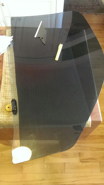

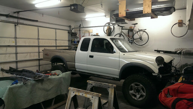

    Recap of the week... Not a whole lot went according to plan, problems kept popping up, all of which were annoying and/or expensive (like paint).
    I took the opportunity of door apartism to tint the windows, got some 20% film from O'Reilly's, then had to go buy more, because I overcut the first piece. So now I have extra, I could up the tint on the rears a little more for more privacy back there, might just leave it.
    Got everything up and running, took it for a test drive.

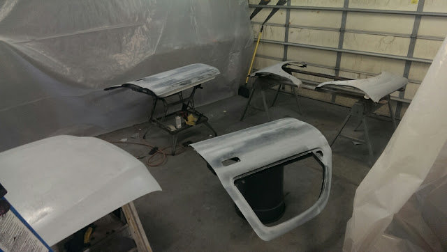

    Got all the pieces sanded down and primed, here they are ready for paint.
    Sprayed them down. The first paint we tried, I used the wrong reducer, killed a quart of auto paint. The second quart, I bought the correct reducer, went a lot smoother. However I should have had 2 quarts mixed to spray, 1 didn't quite cover. I'm ok with it, because the color is wrong, so I'll be going back through and repainting all the pieces when I can.
    Tri-colored truck... not that sexy.
    Got the bumpers on today, the driver's side door panel replaced, and took it for an alignment, and drove it home.
