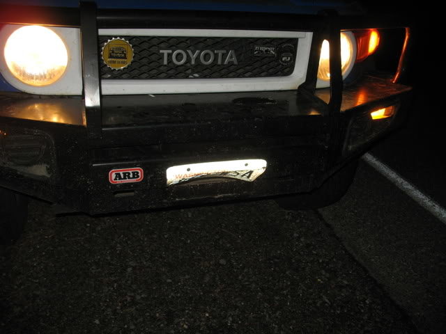

    My wife rear ended a minivan several years ago going around 5MPH in a FZJ80 with an ARB on it. Not a scratch on the ARB and the minivan needed a few thousand to repair.
    I hit a 6 point buck in my FJ62 with ARB around 8 years ago and there was no real damage done except to my Hella fog lights.
