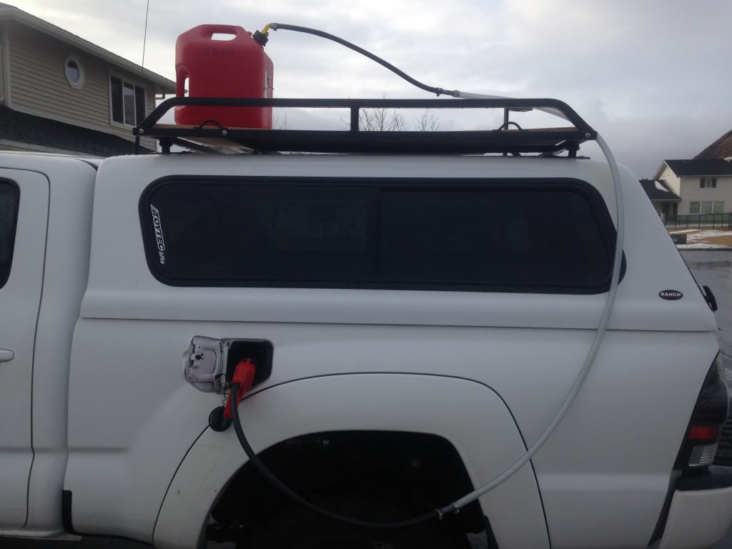

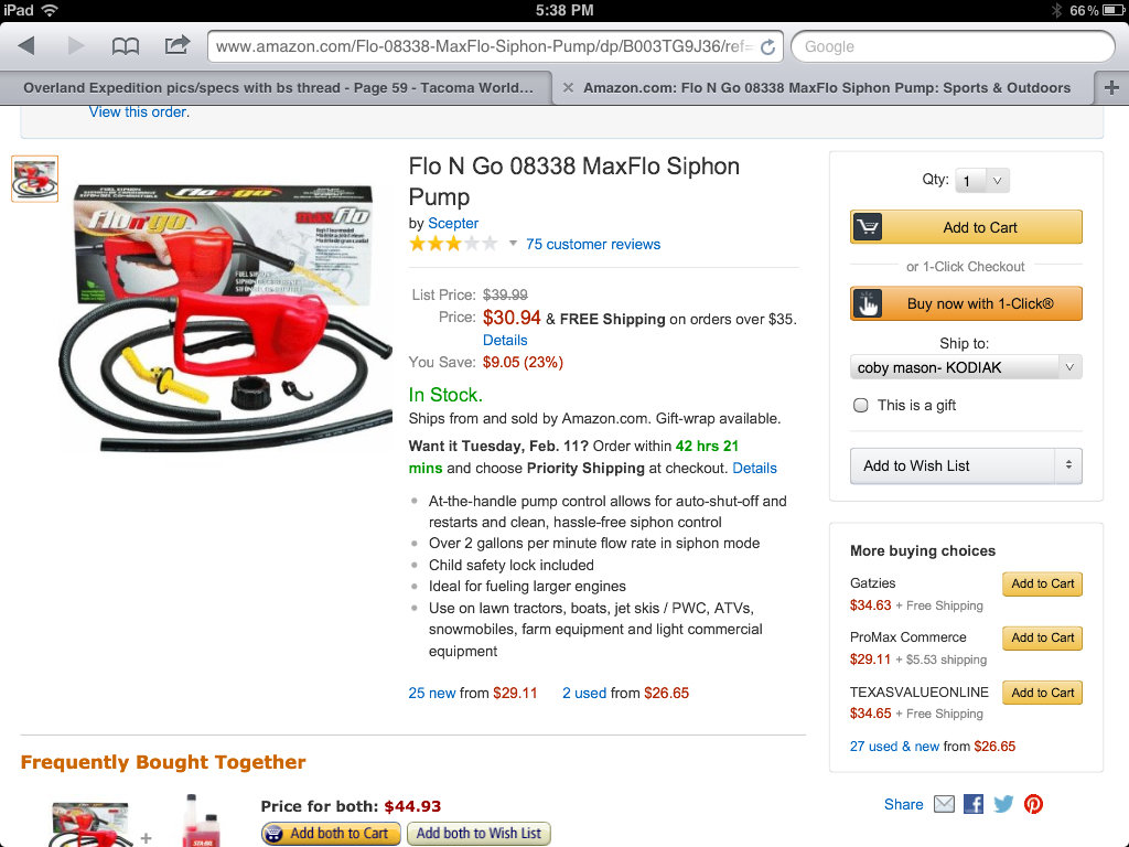

    Ok so I started with a flo n go max flo that I got off of Amazon
    914249513591619acc6a0154e3eb8e48_zps4404_8861380eaf5aea411580992114da44c4469603b8.jpg

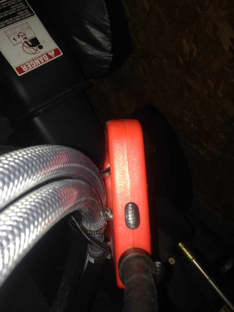

    The hose wasn't quite long enough so I went and got some 1/2 in hose to extend the length out ( I need to cut it down some now it's too long :rolleyes:) also got some 1/2in plastic junctions and some tube clamps
    Ended up with this
    3f641ec924f7ae2637a6a75373b4ee50_zpsd204_3ada79707da35e3490c37332ba451f4e653156e8.jpg

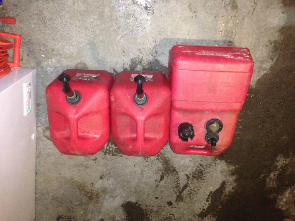

    So I have 3 fuel tanks that I can use (2) 5gal tanks and (1) 6gal boat fuel tank.
    8982254379599856b1946f818727d990_zps8ee8_f6721642c3b749dd9755440f85451ddddecb6ab0.jpg
    I trimmed the fuel pick up tube so it would be just above the bottom of the 5 gal tanks and for the boat tank I just put it in at an angle.

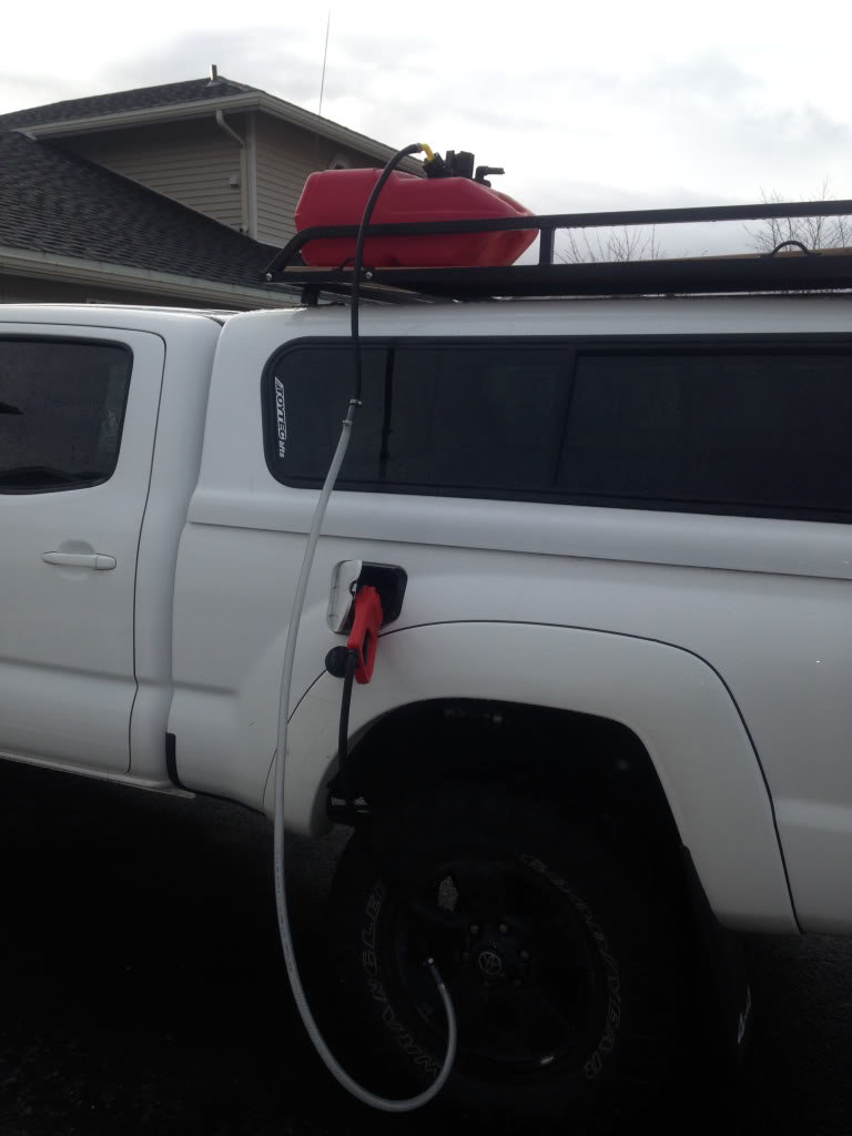

    All 3 will be mounted on the front side of the rack. 0f2421762f87992249e8fa3f4bff0ac5_zpse9b4_5b98663e1ac67cb687bf6307b26ecc350f00b153.jpg
    And to get flow started just push down on the black tab and give the handle a few priming pumps and then just hold it open. The flow is pretty good once it starts flowing. Now I just need to make some thing to hold the handle full open so I don't have to hold my hand on it.

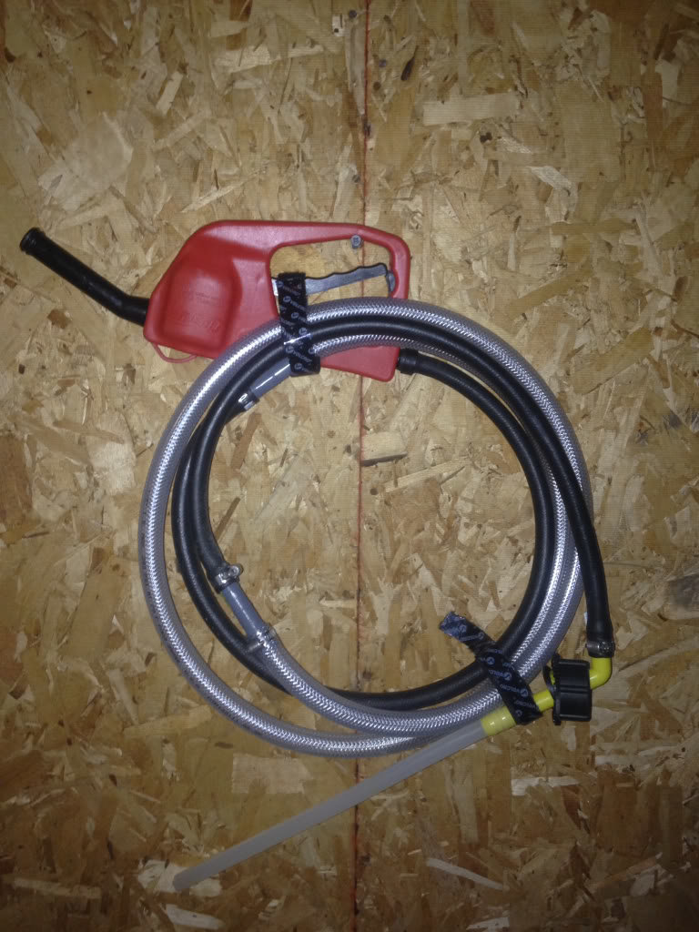

    Obviously there is enough slack to just leave the tanks all strapped down and just remove the caps and just insert the fuel pic up tube. All done and coiled up.
    7a5701a4bec45b4ad88efaee28536e60_zps637d_1fba76325b3e40138f9947073343fe403d653157.jpg
