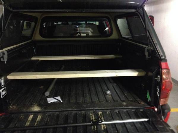

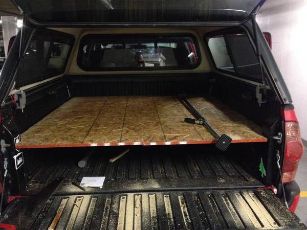

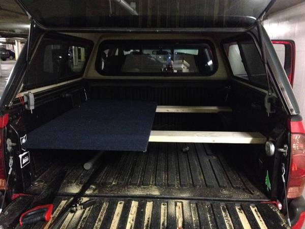

    I was looking a couple of pages back today (statistics class was not too interesting), but I had a few questions:
    1.) With these sleeping platforms is there anything holding the platform down to the bed or do you just let gravity take care of that?
    2.) Does the platform sag at all with only the 2 beams supporting it?
    3.) How much weight do you think it can support?
    4.) Any reason you split the plywood perpendicular to the tailgate instead of parallel to the tailgate?
    Thanks for your help!
  11. May 5, 2014 at 5:44 PM
    #3511
    5280Transplant
    5280Transplant Well-Known Member
    Jul 18, 2013
    #108564
    358
    Luke
    NoVA by way of CO
    05 TRD Sport SR5 Rad Red
    1) The two sections are snug, so they aren't loose at all. I don't have it screwed in or anything. Just gravity.
    2) No sagging at all, I'm not an engineer, but it would take a lot of weight in between the two supports to sag.
    3) Again, not an engineer, but it holds my wife (115 lbs) and me (190 lbs) just fine. I would probably draw the line around 400 lbs, but I don't have that much stuff back there.
    4) Parallel to the tailgate wouldn't work without additional supports. My goal was to have this as light as possible and, down the road, if I wanted to take one section out all I would have to do would be to add a center support. For example, if I wanted to haul something taller, but still sleep back there (bikes, etc). Overall, this was the simplest design and I cannot take credit for it. It was nvwiggins' design, I just adapted it to suit my needs.
