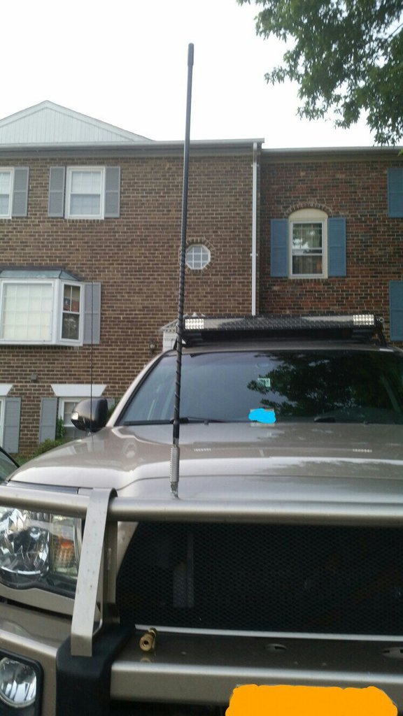

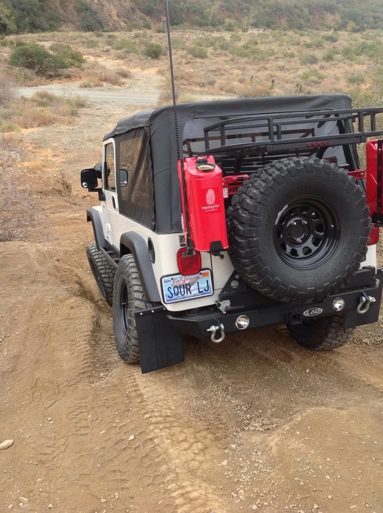

    Thats a pretty awkward place to mount the antenna but meh, i've got mine on the roof.

    I like it there. I see jeeps with there's mounted on the swingout not even clearing the roof!

    If I'm not mistaken, that's what the tabs are meant for. Look at ARB's Facebook or website and they almost always have their HAM/CB antannae a there. It's where I'll be mounting mine when I get an ARB. It's also better for reception. Having them close to the body will interfere with range.

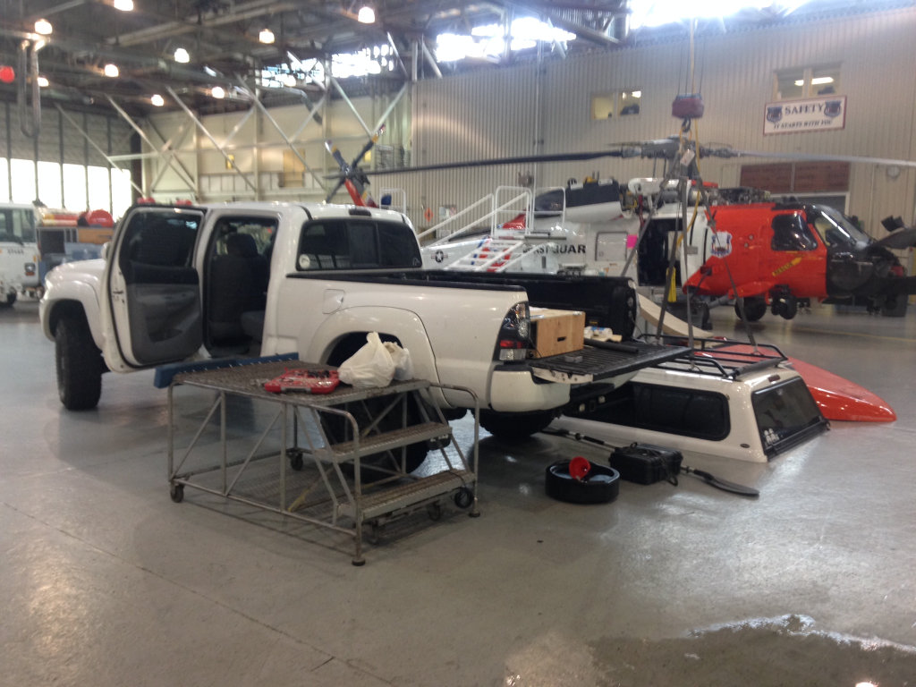

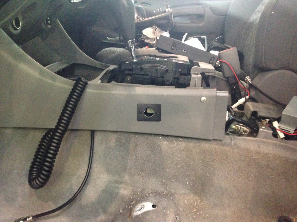

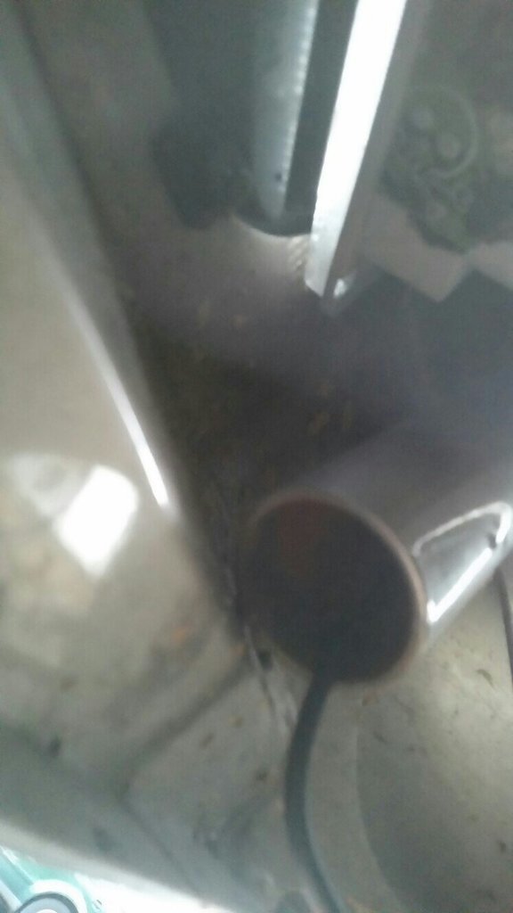

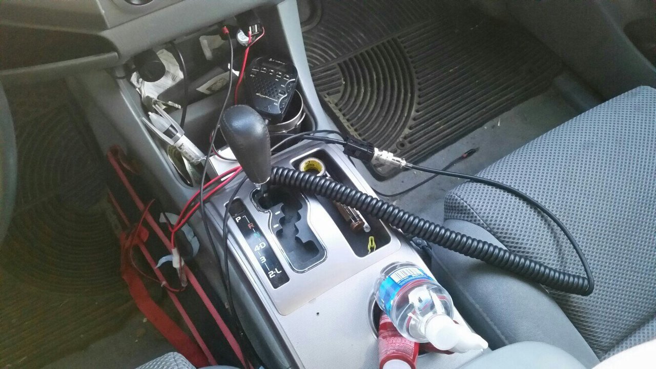

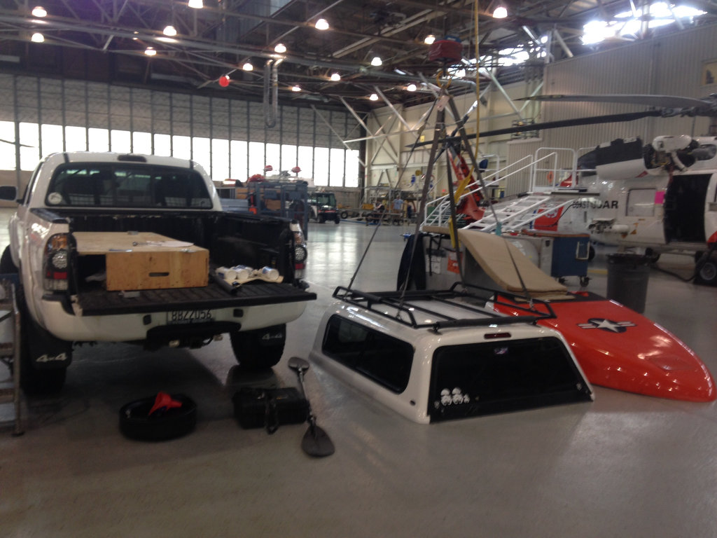

    Had a productive day. I changed my rear diff and transfer case fluid. I added some more gasket material under my topper hopefully that will stop the little leak I had upfront. Mounted my new cobra 75 and mag mount antenna and I bent up a panel to hold my blue seas aux fuse panel.
    My truck looks weird without the topper on it. But thank god for using the over head crane in the hangar made it pretty easy.

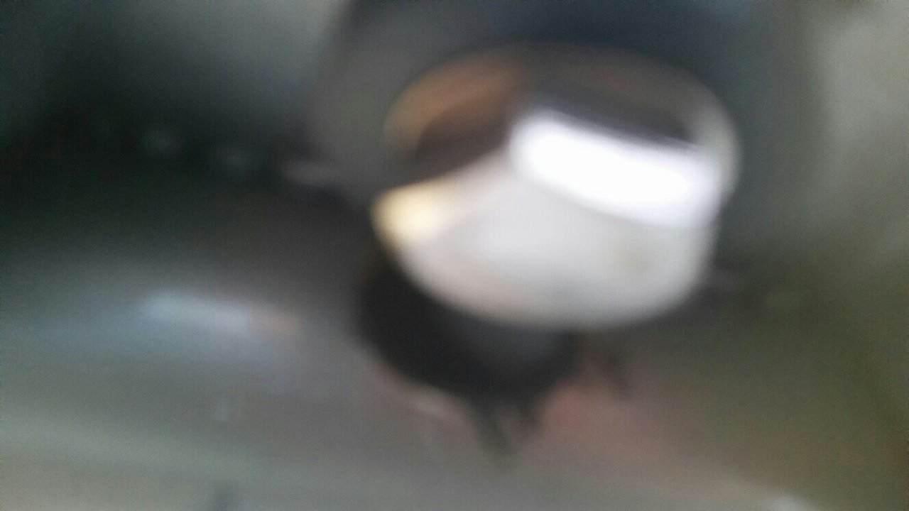

    Ran the coax the same as my last antenna

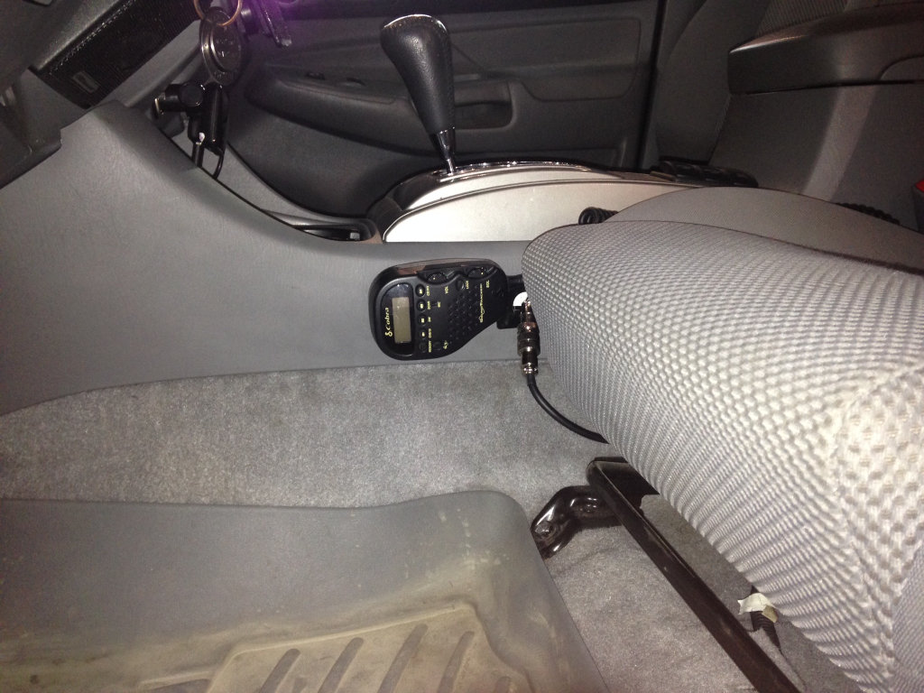

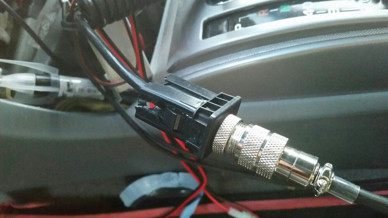

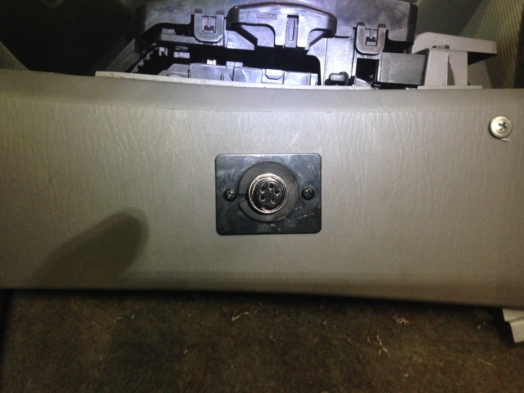

    And where it will be plugging in and in its holder when in use. But I will just keep it in the center console when it's not in use .

    Get install. I have that same CB and put my antenna on the corner of my ARB by the headlight right behind headlight hoop. The antenna doubles as a corner guide. :)

    I use mine as a roof guide for entering garages.

    False. An antenna mounted in the center of a roof is well documented as the ideal location for an excellent ground plain.

    The only thing worse than the jeep example, would be to do some kind of mount to the tow hitch, which would place the antenna even lower, increasing ground losses and introducing more obstructions.
    Yeah basically, what Trump said, antenna mounted on the roof in the center of the vehicle is ideal. You want as much metal directly under the base of the antenna and no adjacent metallic obstructions.

    I don't think he was saying that the front bumper is the best location, just that its better than up close to the body. Which is true.
    On the roof has the least interference but a lot of people don't like to use magnetic mounts or have the antenna wire loose along the roof. So after that, the front bumper is the next best option IMO.

    Hmm...maybe I should have been more clear. Having it on the front bumper is better for reception than where Jeeps typically have them or behind the cab of the truck on a bed rail like have seen as a common mounting place on Tacos.
    Also an example of a less than ideal mounting place would be like where colinb17 has his in that GIF ^^^.

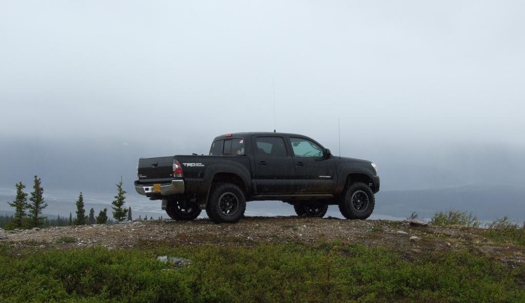

    Hunter.V.White
    Hunter.V.White Well-Known Member
    Jun 1, 2010
    #38199
    583
    Hunter
    Fairbanks, AK
    2013 DC 4WD TRD-Off Road
    Pelfreybilt Steel Armor, Famous Fabrication Sliders, OME 3" Lift, 886x coils, Dakar Leaf Packs, TC UCA's, Fuel D551 Wheels, 285/70/R17 Toyo Tech RTs, Warn Zeon 10s Winch, Rigid Industries 20" E2 Flood, RI 20" SR Spot/flood, RI Duallys, SwitchPro SP8100, Uniden Bearcat 680 CB Radio.
    I've got my antenna mounted on the roof. It is a Browning base with a stainless steel whip, cut down to 45.5", screwed onto a permanently mounted base. It may not be the ideal spot aesthetically, but I have a radio for reasons other than aesthetics and I want it to work when I need it. When I was in this picture, I was picking up radio traffic from the highway; I was close to 6 miles off at that point. Granted, I was on high ground, but the weather wasn't clear either. I do want to test my setup's range for both receiving and transmitting, as I do know that those are different.
