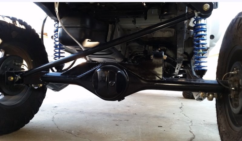

    Mounting a larger fuel cell under the bed is not difficult at all, you just have to have someone machine an adapter to reuse the stock sending unit and replumb the evap stuff. There are a few universal fuel cells on Summit Racing that would fit. I just finished a 3 link set up on my truck and plating the frame etc so the tank is next on my wish list.

    Pics please!

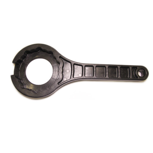

    I picked up a few of the Scepter MFC's late this summer. I barely made it between towns before the supercharger and a lot of the smaller gas stations along the highway don't have 91, so I need to pack a lot of extra fuel with me.
    The cans seem to be very good quality.. but all of mine leak. I checked the gaskets and they appear to be the correct ones and flanges are in good condition so I think I might not be tightening them enough? They seem pretty tight, but perhaps they need to be guerrilla tight.
    I've read that scepter has two gaskets they use, one for diesel and one for gas (which sounds like it also works for diesel). I've also read that if you use the diesel ones with gas the gaskets can swell and crack the flanges on the cap. I've verified that the gaskets I have are indeed the ones for gas and that my flanges are okay (I bought these brand new too). Anyone have a solution for me to try, other than putting them on tighter?

    Sorry, this is the only pic I have and it was taken before the bumps and straps were installed

    I have several Scepter MWCs (which use a different gasket), and they have to be quite tight to not leak.
    Have you considered a cap wrench? Several companies sell them - I've seen it at LexingtonContainerCompany.com

    Buy a MFC cap wrench. They sell them for the MWC too.

    I have a couple MWC's as well. The MFC's use a different cap (and different wrench), but I might pick up one of the cap wrenches next time I'm near a retailer.
    Heading south next week for Christmas. If I can't get them tight enough on my long drive down, I'll be near a store that sells the cap wrenches. :)

    I have 6 Scepter MFCs for emergency fuel storage and camping. They are stored outside and experience wide temperature swings. I've been using a cap wrench and have never had an issue with them leaking or 'venting' when they're not supposed to. Supposedly they're made to swell and contract and it won't damage them but I release pressure every other month or so.
    I also have 6 MWCs and have ordered accessories for the MWCs and MFCs from JAGMTE. I think he's the actual supplier of the cap wrenches that most places sell. I've been extremely happy with everything I've ordered from him.
