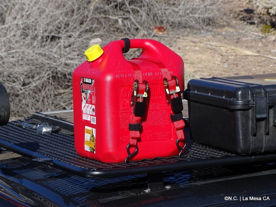

    A month or so ago we were talking gas cans. I just completed one of my biggest trips of the year, Death Valley.
    On this trip I always carry reserve/emergency gas and had an opportunity to take a photo of what I'm using.
    Midwest 5-gallon gas can - $18.99
    Ez-Pour Solid Base Replacement Gas Tank Cap - $3.00
    Ratchet straps ~ $5.00
    • Throw the CARB spout into the trash upon exiting the retail store, and replace with solid cap from Amazon.
    • User a super siphon to transfer gas into gas tank.
    Simple, clean, effective, no leaks, not one drop.
    Just goes to show you don't have to spend a fortune solving off-road / back country / expo challenges.

    are you stopping to release the pressure in that? id imagine with the temperature swings that can happen out there that that can make it swell or contract enough to maybe damage the container and cause leaks? ive never travelled with any of those things so im naïve to what is the norm

    Venting modern gas cans is totally unnecessary according to what I've read from various manufacturers. They are designed to be blown up like balloons and the can contract and walls can even go inverted. Manufacturers are starting to print on the consumer labeling that this is normal and not do dick around with venting them on hot days. Just leave them the hell alone, and it's all good. :thumbsup:

    Nice. One note: I'd put some sort of rubber anti-chafe material between the metal ratchet strap buckle edges and the plastic can. Hard to tell from this pic, but it looks like they are in—or could shift into—contact with the can.

    Good point. I'll check/monitor for any rubbing from the last trip, but so far about 500 cumulative off road miles and no problems that I've seen. I make them ratchets pretty tight. :)
