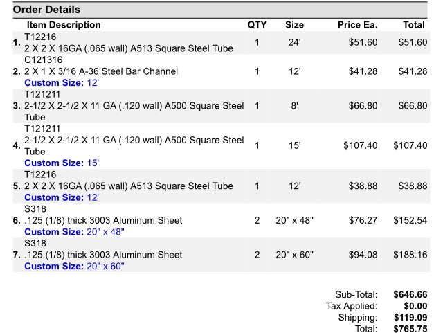

    A buddy and I are planning on doing this, what size tubing are you using for the frame? I was thinking about 3/16" wall 2x3 or the like.

    I used 2.5"x2.5"x11GA for the base frame. The tounge that is running down the center is 2.5"x2.5"x3/16". The vertical pieces and the top rail is made out of 2"x2"x16GA. The tailgate is made of 1.5"X1.5"x14GA. IT IS SUPER SOLID and not to heavy. This is my initial order list. Hope it helps. PM me if you have any more questions.

    Nice! Thank you!

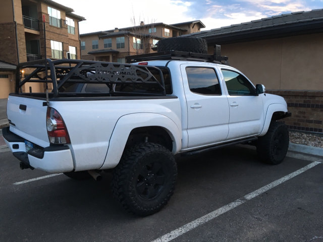

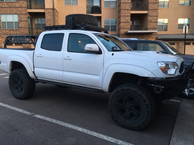

    Dont poke my head in here to much but thought I would share. Got my bed cage from billy @ BruteForce installed yesterday loving it. Hopefully getting the RTT on this weekend.

    That is nice man love the design! Does it mount to the bed or the side bed rails?

    It mounts into the bed, uses the bed bolts so none of the weight is on the side. I had bed bars and was trying to get away from them.

    I want that cage so bad! Looks awesome man. Is that the standard height for his cages?
