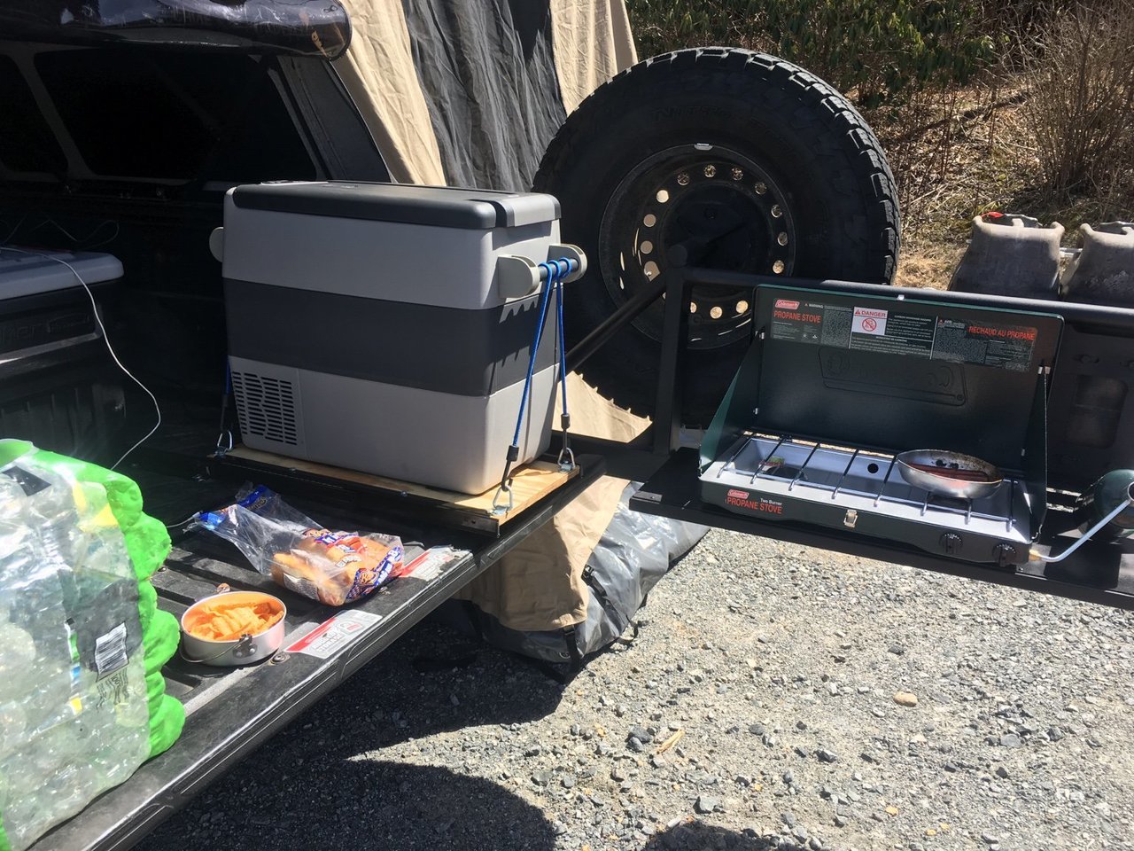

    Fridges is where I found myself (there was a GB on some about a month ago and I got in on it. )
    Extremely happy with my choice. Built a slide for it and got a battery box powered by a solar panel to keep it topped off when it's in use. I took it out for about 4 days and just threw my eggs, milk, meat, water and forgot about it. No more ice is def under rated and with a 51L capacity I've got more than enough space for a 3-5 day trip that I normally go on.

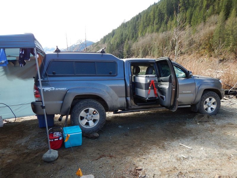

    Looking good @ChamYota, I was curious to how you're fridge slide ended up working out.
    I got in on the same group buy as @ChamYota, Indel B TB51A. We (the GF and I) sleep in the back of my canopy so I removed the rear passenger side seat and turned it into a fridge slide.
    It's a great fridge, it's been a complete game changer for me and my GF.
    We spent two weeks last summer living out of my truck. We went to a music festival which required you to camp for a week and then we spent the week after camping and exploring different hot springs in the Kootenay Region of BC. It was an amazing trip but doing it with just a cooler was a huge pain in the ass. I swore I'd buy myself a fridge before doing another similar trip. I don't even want to know the amount of money we spent on ice and the amount of food that got wasted from being soggy and water logged.

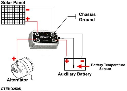

    I'm in the process today of upgrading my dual battery system to help keep up with the fridge and create a truly maintenance free battery setup. I've purchased a CTEK D250s Dual DC-DC charger and MPPT Solar Regulator. I plan on getting it installed later today.
    It's a pretty pricey unit but I think it's worth every penny considering what it does and it's benefits.
    The features of the CTEK D250s Dual are as follows:
    • Multi-step 20A DC-DC smart charger (hooked up to starting battery/alternator)
    • Battery separator that eliminates diodes, VSR's, and allows charging between two dissimilar battery types (wet cell starting battery and a AGM deep cycle auxiliary battery)
    • Maintenance charge of starter battery from solar panel once auxillary battery is fully charged.
    • Two power source inputs (alternator and solar panel).
    • Solar panel regulator with Maximum Power Point Tracking, which can be hooked up for synchronised charging with the alternator input if required.
    With this unit I won't have to worry about setting up my solar panel all of the time to maintain a charged battery. I plan on eventually hard mounting solar to my truck but until then It will make sure my battery is fully charged without having to set up solar or remove it from the truck and put it on my bench charger. This unit will also more efficiently charge my battery from my solar panel as it is a MPPT (Maximum Power Point Tracking) solar regulator versus the cheap PWM (Pulse Width Modulation) solar regulator that I currently use.

    Kinna dumb question but the cable that attach to the unit wondering where you connect it to?

    The cable connected to the unit is the auxiliary battery temperature probe. It prevents damage to the battery if it overheats and also changes the smart chargers charging mode depending on the temperature (different charging cycles for colder weather, etc)

    So if your using 12v battery's as a auxiliary. where do you connet it to? - or + ? Any picture?

    It doesn't get connected to the negative or positive post, it just sits in contact with the battery case. I'm going to just zip tie or sticky back mine to the battery case.
    Here's a wiring diagram.
    I'll have a full write up in my build page of my install in the next coming days. All I've had the chance to do so far is run the positive wire from my alternator (starter battery) to where I want to mount my CTEK in my bed beneath my sleeping platform.
