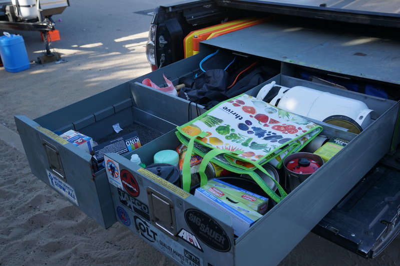

    I have a set of Adrian steeler stow-all drawers:
    It was built for an LR3, but fits perfectly between the fender wells. I have about 5 inches underneath my roll-n-lock tonneau cover. Yes, it's heavy, but the organization it provides is worth it. I did the rubbermade totes for so many years, and the drawers made life so much easier. No more rummaging, hurting my back taking totes in and out of the truck. The drawers fit my tent, bag, dry food, kitchen stuff, and my recovery stuff.
    I have firestone riderite airbags with the 4 leaf TSB pack. Empty, 5 PSI, fully loaded for that road trip, 15 PSI, and it gave me a buttery smooth level ride.
    I would recommend airbags for any expo rig that is also a DD so you can tune the ride to your loadout.
