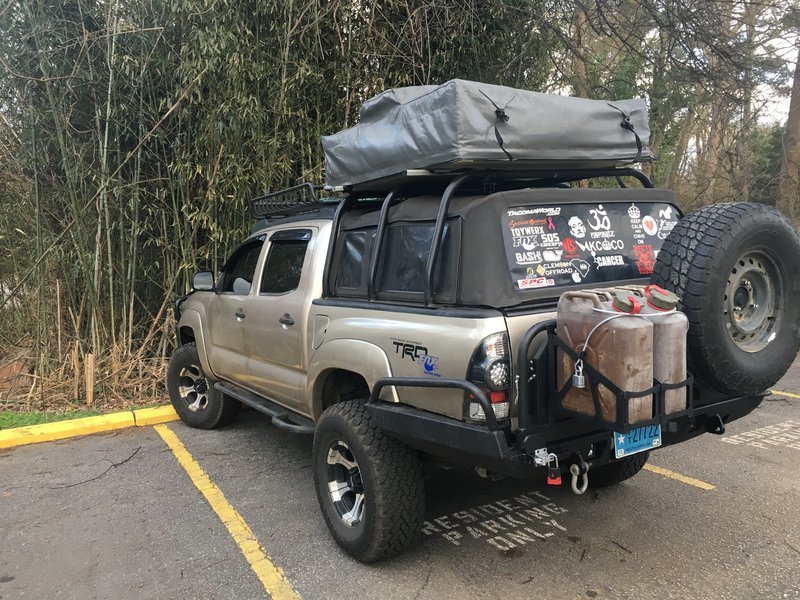

    What rear bumper is that? I like the foldout table, it looks sturdier than the ones I'm used to seeing.

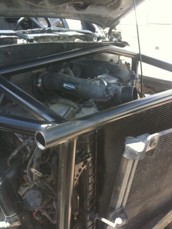

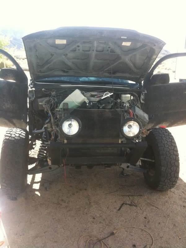

    You removed the core support? Did you replace it with a custom tube support? I was under the impression that you kinda need that...
  10. Apr 19, 2016 at 7:21 PM
    #6290
    username
    username Fluffer
    Oct 15, 2010
    #44704
    6,064
    Pendleton, Or
    05 Taco with some crap welded to it
    mostly stock
    Nah, it's optional. Totally removed it and did an engine cage. I had to because the frame rails twisted so much on hard hits it was pinching my motor and mashing the motor mounts into the frame like a big nutcracker.

    Acutally mine is built by Billy @Bruteforce Fab :cool: He does really good work.

    Yea, I have the same bumper :) But look at his table, it looks thicker and sturdier!

    Ok, so your core is being supported by the engine cage now though?

    Yes, the radiator and condenser are attached to the engine cage, along with the headlights, grill, and fiberglass fenders. It shifted the weight balance a lot more than expected, and it flies a lot better now. The inner fenders are heavy multi layered sheetmetal designed to pass crash safety tests. I feel a lot better crashing my pile than a stock one. Since then I've added more weight to the rear so it handles like a BMW, perfect neutral steer 4 wheel drift when you pitch it into the corners.

    Ah, very cool! I've been thinking about doing an engine cage eventually, but for now I'm waiting for the stock core support to start to fall apart haha.
