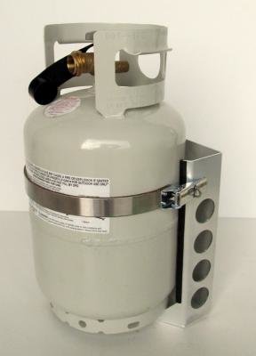

    Thinking about a mount like this for inside the bed.
    A SUV would definitely pose a challenge.

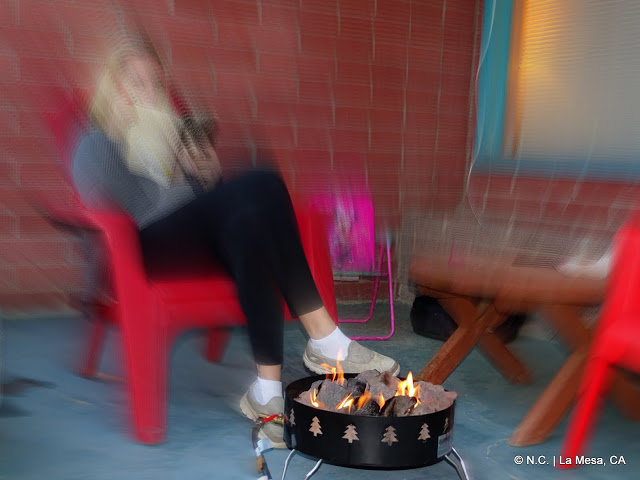

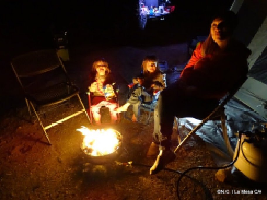

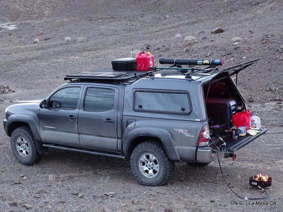

    I think a 20lb (4.2 Gallon) bottle will run about 6 hours on high.
    An 11lb (~2.5 Gallon) bottle with run for about 3 hours on high.
    To get more accurate, find the BTU consumption rate for the pit. Every pound of propane contains 21,591 BTU.
    It's my understanding that every propane bottle can only be filled to 80% capacity.
    Here are some pics...
    Wife pic, flame on low
    Solo trip pic, flame on low
    Wife and kids, flame on high

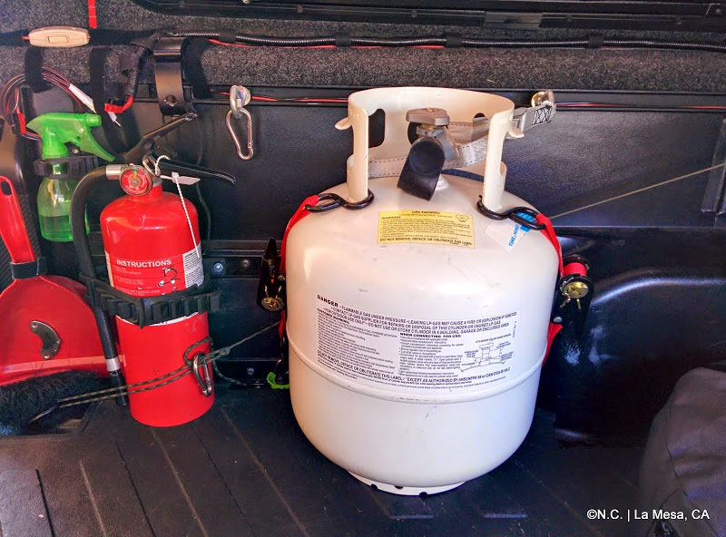

    I have hauled propane bottles many different ways.
    It is technically wrong to do it in an enclosed space. The bottle should also remain upright at all times.
    And during transit the OPD valve must be clear of all fasteners, and must be protected by a cover.
    OPD valves will not release propane even if opened as long as their is no fitting in them. Do not use a plug with these style valves. OPD valves can be easily identified by a triangle shaped handle on the valve.
    Here are some pics.

    X2, as is the case with everything I stole from Crom.
