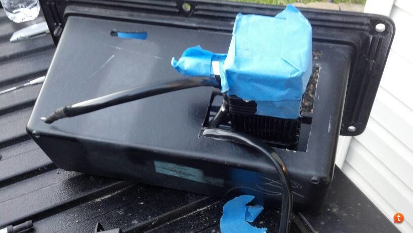

    Anybody with ObA set up with am ARBOR single compressor and a tank?
    I have a few questions but most people with tanks run a twin.

    Fixable? Time to bolt it down

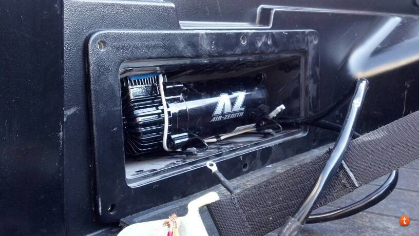

    I have the single but no tank. The single has always worked fine for me. Only takes about 10-12 minutes to air up.

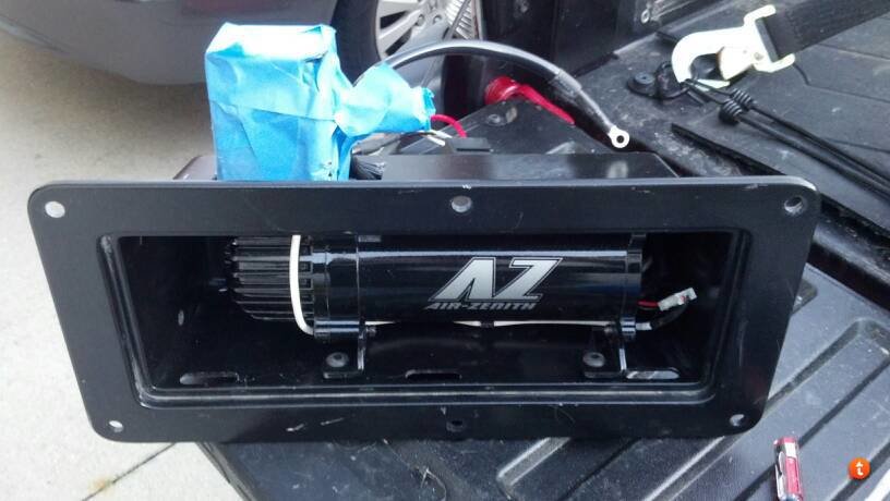

    Awesome! How hot does it get? If I mount it in a cubby, similar to the bed cubbies in Tacomas, will it melt the plastic inside?
    Yeah I want to be able to run air tools was my idea. I was seeing if a single compressor was capable of keeping a tank pressurized enough. I know a twin can.

    It gets pretty warm. I have rotopax right next to it and then don't melt but if I touch it after filling up all 4 tires it doesn't feel good. I think I would want more ventilation for it than inside a cubby.

    Damn... I don't have a great spot for it in the runner. I know people that do run it on cubbies but I worry. Maybe if the door is off permanently so it gets air

    That would be pretty easy actually. I could wire it to come on with the same switch as the compressor. Would serve as a good exhaust fan!
    Gears are turning!
