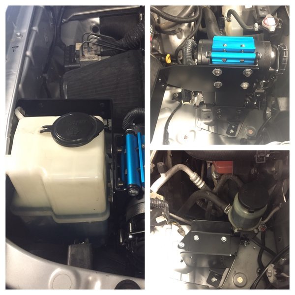

    The other day someone mentioned the Slee Offroad ARB twin mount and I'm really glad I caught that in here because I've had a new twin sitting in my garage for a few months while I worked on ten other projects...waiting for the right mounting solution. Called them up last Thursday and had it this morning, really clean CNC cut and powder coated brackets and all hardware included. The kit relocates your power steering resi a few inches to open up space for the twin. I should specify that I have an 06' with the large ABS module occupying what would be the only other space large enough for the twin to fit under the hood.
    Pretty easy install, pull the washer tank, install PS resi relo bracket, bolt on the mounting bracket, bolt the twin to it and reinstall the washer tank.
    If you are running arb lockers the bracket also has mounting locations for the ARB manifold on the other side of the washer tank.
    pics :

    No, I am going to plumb it over to a plate above my ABS module, I am building a plate ( similiar to the blue sea fuse panel plates everyone runs on the drivers side ) for my winch solenoid, the solenoid controller plug, the ARB quick connect and a couple of other connections.
