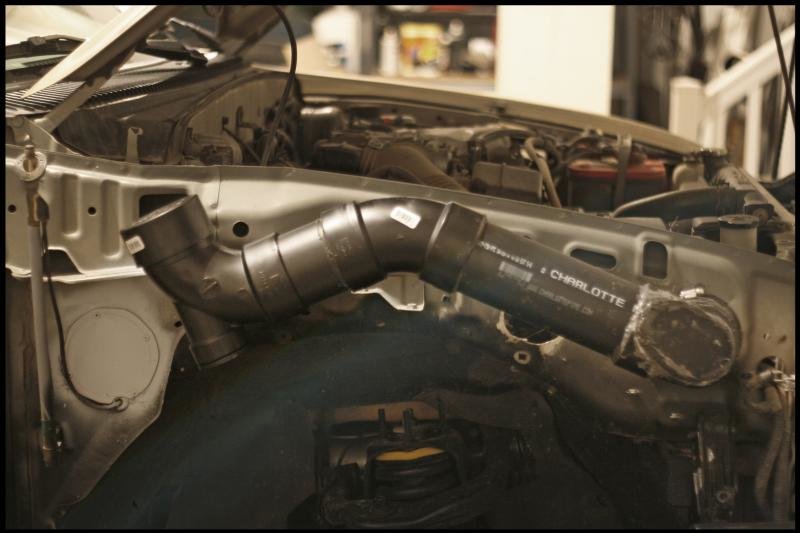

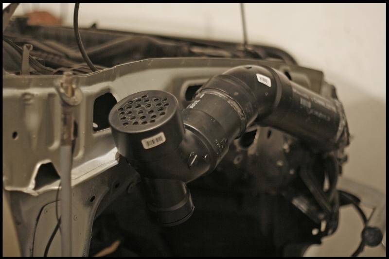

    Here's what I did with mine when I had fiberglass fenders. ABS tube connected to the stock airbox. Inlet up as high as possible under the fender as close to the firewall as I could get it. I used the "Y" piece for the inlet with the small opening pointed down with a cap on it and a small hole in the cap. Any moisture that found it's way in would hopefully drain to that point (since it was a low point) and drain out.

    I saw that before and was going to do something similar but damn tubes were in way
