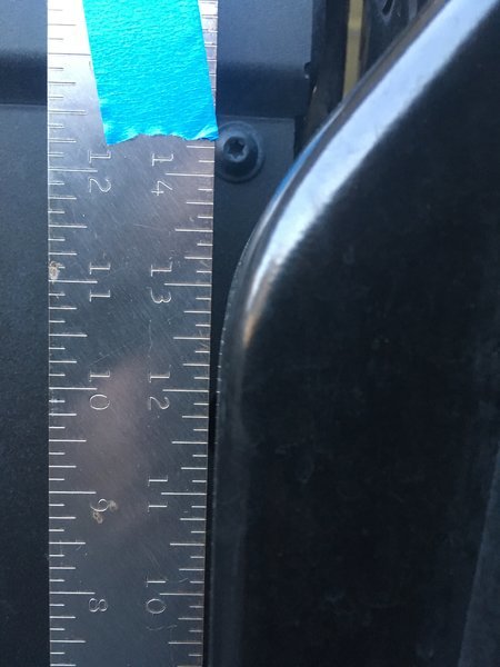

    Interestingly, driver side was worse than passenger as compared to the bracket and the square. Pics all from driver side.

    Think it gained about .5" in the front and about 1" in the rear.
    Wow! I thought mine were bad!

    I knew mine were bad; came to my attention due to the tailgate being a little difficult to open from time to time when out playing at, shall we say, somewhat higher speeds. :D
    I used the bed bolt, OEM tie down and stock upper bolt on the bracket to position it for drilling; then torqued all 4 bolts in sequence to bring the upright back straight. Didn't want to strip out that stock upper thread by making it take all the load. Worked like a champ (with my young assistant).

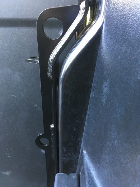

    Did my install the other week

    Did you, as I did, take a moment to admire the welds on the bracket? Very nice indeed. :thumbsup:

    lol I sure did! It came in handy getting gas for my gas can while cutting the grass. I love the brackets.

    Just finished installing my bed stiffeners and I don't know whether it was my gorilla-like over tightening or if there was a significant gap, but the factory 10mm top bolt snapped on the passenger side. Everything else was straightforward. Excellent workmanship. Highly recommended. :thumbsup:

    Over tied. I did the same thing
