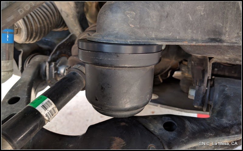

    Any front bumpstop recommendations for first gen with mt?
    lots of people running wheelers in the front but have read that without shaving they give you about 1” of up travel?? Any input welcomed:popcorn:

    Can't help with 1st gen.
    I am second gen, running unmodified Wheelers super bumps in front with 1/4" spacer to compensate for larger tires. I have been very pleased with their performance.

    You might be able to adapt them to work. I just don't know anything about 1st gen tech.
    I recommended the wheeler ones to my buddy after looking at his Baja Bug. I think he drilled and tapped a hole and put them on. Pretty easy.

    Check Build thread
    Yea I run them in the rear with my shock relocation/deavers but think the problem for the front was that they were vertically too tall. Looking for an alternative to cutting/shaping them that other first gens are running with stock lowers
