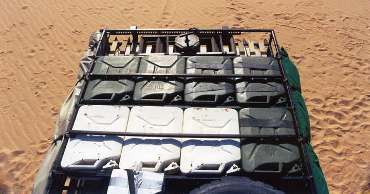

    I know you are going to carry a shit ton of weight in your SAS rig, like your DD.
    So why not go all out with the Scepter cans and put them on the roof. :p
    EAF
    x2 Much more practical. IMO, you can find a gas station just about anywhere in the U.S spaced within reasonable distance. I currently only carry reserve fuel for Death Valley trips. I would for sure carry fuel for Baja, Mexico, and probably travels in Alaska.

    An alternative to Scepters on the roof, are a quad carrier swing out.
    Billy @ Brute Force Fab, Custom swing gate, (4) scepters + Fridge. Untold EAF points, there. ;)
