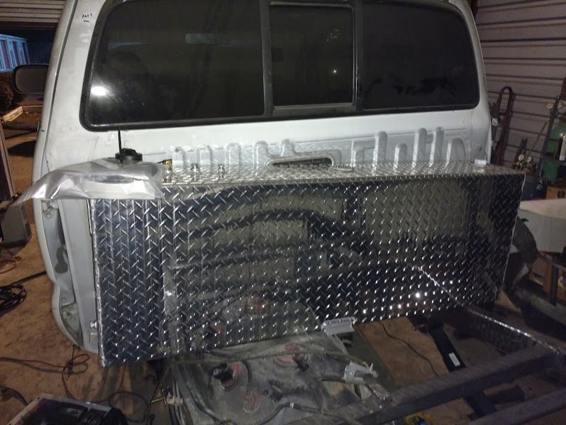

    It's like 18 inches tall so it hangs down a bit.
    This is pretty nice. I like how he ran the fuel filler into the bed. I didn't go that route because I have a sleeping platform in my bed. I also like how he mounted the tank into the truck.

    I should add it took me a while to have confidence in the tank's structure. On one of it's 1st trips I pulled off a dirt road and the truck was on an angle. There was gasoline pouring out of the top of it. This happened to be the second day of an 8 day trip to Baja. It turned out to be a leaky gasket where the fuel pump and sending unit go into the tank. The only other issue I've had is the fuel guage reads backwards and now it's broken all together so I need to replace it with one that reads correctly. It's survived two Baja trips and a whole lotta off roading. Baja alone has been about 2,000 miles of rough dirt roads mostly following the wooped out Baja 1,000 course from whatever year we were there.

    The one thing I was going to ask you when I re-read your tank setup last night is if your aux tank is bigger than your stock tank? If it isn't couldn't you just run your stock tank out until it starts sputtering and then hit the pump switch for your aux tank? That way no risk of destroying the evap cannister again. My dad's old f-150 had a dual tank setup stock and he would run one tank till it started bucking and then hit the switch for the second tank.

    Thanks for finding that. saved me from digging back through all of my photos :oops:
    since the original install, I also added a filler neck to the tank, so I don't have to crawl into the bed to fuel up.

    I thought about just doing a switch tank set up...like a solenoid controlled valve but I didn't want to have to mess around with putting a toyota fuel pump into the aux tank (I'm not even sure if a toyota fuel pump would be needed now that I think of it).
    The aux tank is 1/2 gallon bigger but because of the way I set up my fuel filler hose I can only fit about 16 gallons in it.
