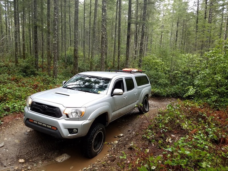

    I'm not EAF yet, but I do have things on the roof, so perhaps I'm inching my way towards EAH(eck).

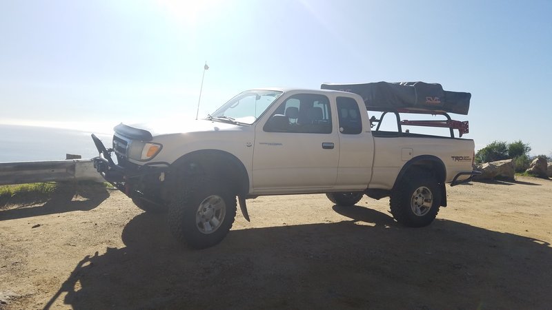

    Am i EAF??

    What's the advantage of a spring under setup? Haven't spent any time looking into them yet.

    So a leaf spring is basically a "U" formed with multiple individual flat bars varying in length and sometimes thickness. In most cases the more of a U shape you have, the more progressive the spring rate will be. Flatter the leaf pack or when you go into negative arch you are actually at the peak or losing the progression as it goes up.
    For instance - The Dakars that I was running were completely flat at ride height when the truck was loaded down for a trip, thus putting the pack at the maximum rate they can handle. Bumps were always rough and all up travel was basically putting them into negative arch which is no good for ride quality. Now with a spring under the leaf pack still retains the U shape and because of that it's still progressive. It rides nice at ride height because it's not at it's limit and as it cycles up it progressively get's stiffer and stiffer.

    With as much weight you were carrying why did you not just put back the Dakar overload you originally took out?
    The Dakars are a progressive pack for that reason.
    You know.. I bet you lost wheel travel by going to the Deaver springs. Did you take any wheel travel measurements before and after?
  13. Feb 24, 2017 at 8:25 PM
    #9273
    1MK
    1MK Desert Explorer
    Jan 8, 2015
    #145870
    857
    Southern California
    They're only progressive when they aren't flat. The leaf pack was basically smashed up against the overload at ride height. Putting in the additional one wouldn't have changed the arch.
    I'd actually say the opposite. Not only does it have the ability to droop further then the current shock can provide, but up travel has also increased due to not being limited by the axle housing. I can grab some measurements tomorrow.
  14. Feb 24, 2017 at 8:46 PM
    #9274
    Crom
    Crom Super-Deluxe Member
    Jun 22, 2009
    #18782
    9,642
    Nick
    San Diego, CA
    2009 4x4 DCSB Camp Supreme
    Millions
    When it comes to spring packs, when you add or subtract a leaf, it doesn't matter which one, you alter the spring rate at some point during its deflection cycle.
    In the case of Dakar they have the second overload for precisely the reason you described. I can guarantee you had you put it in it would have helped. I personally just went through this on my Dakar pack pack when adding a steel bumper with gate, I adding the second overload back in and it does make a difference.
    Measurements will tell the story for sure. And I'd recommend it. That kit cost a lot of coin!
    But consider this, Total Chaos states this on their website re: the spring under kit:
    • Wheel travel specs: Wheel travel with stock mounting location shocks- 9.5"
    • Wheel travel with custom shock mounts- Capable of 12"
    What was concerning was I know from extensive measureing that with my Dakar +D29XL AAL + 3° axle shim, I can achieve 13.75" of wheel travel.
    Our rear was essentially the same except for the said overload if I recall.
    So I question the TC wheel travel numbers.
    Food for thought.

    ^^ my guess is that TC just quoted stock wheel travel since the configuration isn't changing. If they really measured it out I bet it's more. But with SUA the use able wheel travel is more then with SOA. So @1MK has the advantage there.

    @Gramps we'll see.
    The problem as I see it is the stock shock mounts with SUA. Until that's resolved I think he lost some.
    As I understand it with a longer spring you get more travel, assuming shocks don't limit. For example on the Chevy 63 swap, I think I remember Frank saying he has 18" of wheel travel.
    I'm interested in the results, if only to increase my understanding of various build strategies.

    I am not just talking about droop. I am referring to useable wheel travel. That is the space from droop to flat line spring without going negative arch which is the problem with our SOA springs. I am in the factory locations still and have 11" travel shocks. So he can get more then what TC says. And no I am not bottoming out the shock. I am running short body 2.5's with resi.
