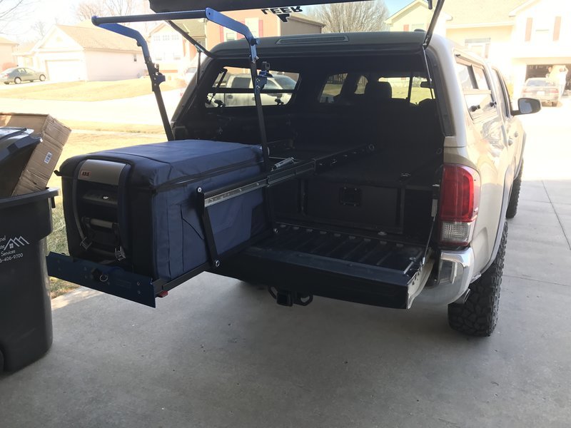

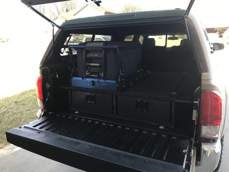

    I made the drawers. 3/4" ply painted with hammered paint. The drawers have the slide home made with 3/4 square tube steel on the drawers with roller bearings in the cabinet. I carpeted the top. I then placed L track on the right side to strap storage boxes down. The fridge rides on a MSA drop fridge slide.

    Did you build those yourself?

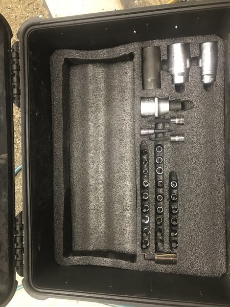

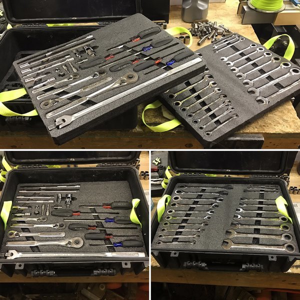

    I have been using the wrench rolls and bags from atlas 46 and love them, very very robustly built with quality parts, do not see them falling apart any time soon. I also decided that my 5 seperate socket sets and all that had to go, so i used a pelican 1550 case i had and made a super tool box out of it with kizain foam
    Impact sockets and sockets are on the flexable socket holders in the botom layer open space

    Oh man that's amazing. I might have to do that sometime as my tool set if growing larger and I need multiple combos of tools since the kit travels between my truck and my track car. Thankfully they're all at least metric...
