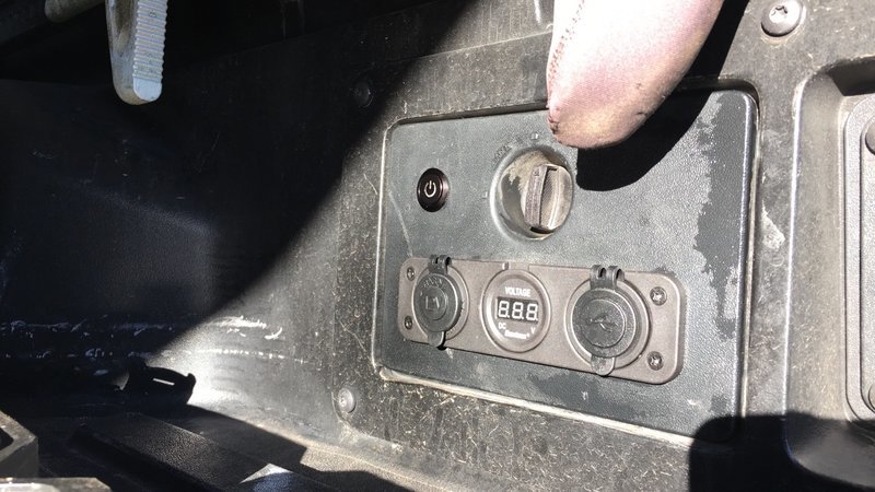

    Any of you guys running this set up in your beds? Picture is just off the internet. Mine is from Blue Sea. If you are running this do you have the volt meter on a switch or do you leave it on all the time? I am curious how much it would drain a G31 battery when the truck is not on. Thanks!

    Are your sockets on a switch as well or are they hot all the time? I found out my fridge draws some high AH the would almost max out a switch therefore requiring me to add a relay if I were to put it on switch. So I am thinking of just having the sockets be hot all the time since the fridge will only be plugged in when needed.

    I had one in the bed of my 2nd gen. @Acerwin has one too
    .. both wired to a switch

    I have a National Luna Battery Monitor with the LEDs, it stays on all the time and does not affect the battery at all.
    You should be good.

    Got mine in the back of the middle console. The voltage meter is running all the time.

    Hey guys thanks for the quick response and info. Much appreciated! Oh and @cmack thanks for that pic. That is one location that is being considered for this and it might just be the winner! ;)

    I have this and the whole thing is powered 24/7. I've had no issues with the OEM original battery but my truck is my DD so it gets used daily.

    Yeah I have another Blue Sea that will go in the bed and all will be fused back to it first and power coming in to the fuse block. Thanks!

    Yes. One similar to that and have it on all the time. Don't reall see much draw out of it though.

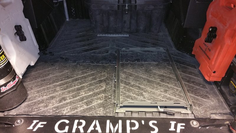

    Got the fridge mount done tonight so that all I have is wiring this weekend. @cmack how is this for your OCD. :D
    Let me know if you can find the slide. ;)

  19. Mar 30, 2017 at 8:07 PM
    #9579
    cmack
    cmack Well-Known Member
    Jun 10, 2016
    #189259
    7,436
    18 Burrito
    Much better :thumbsup:
  20. Mar 30, 2017 at 8:08 PM
    #9580
    1MK
    1MK Desert Explorer
    Jan 8, 2015
    #145870
    857
    Southern California
    Looks like a rookie install to me...
