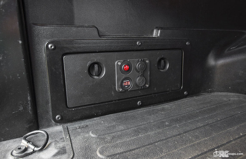

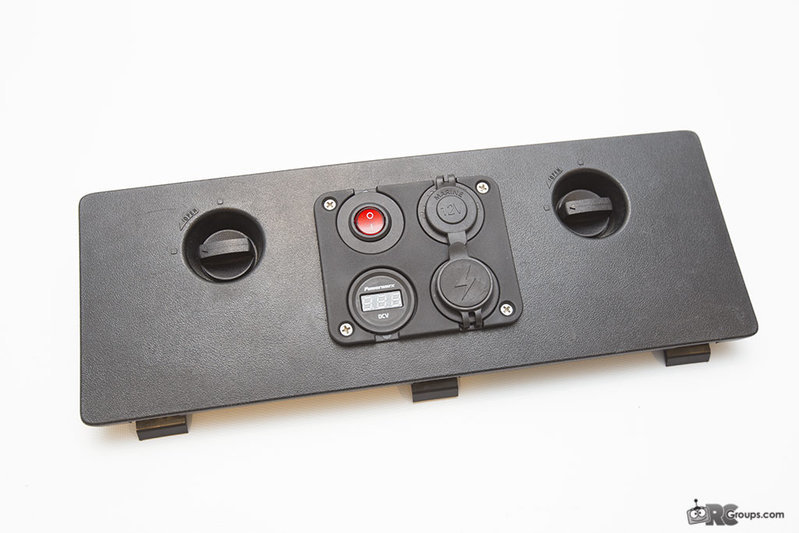

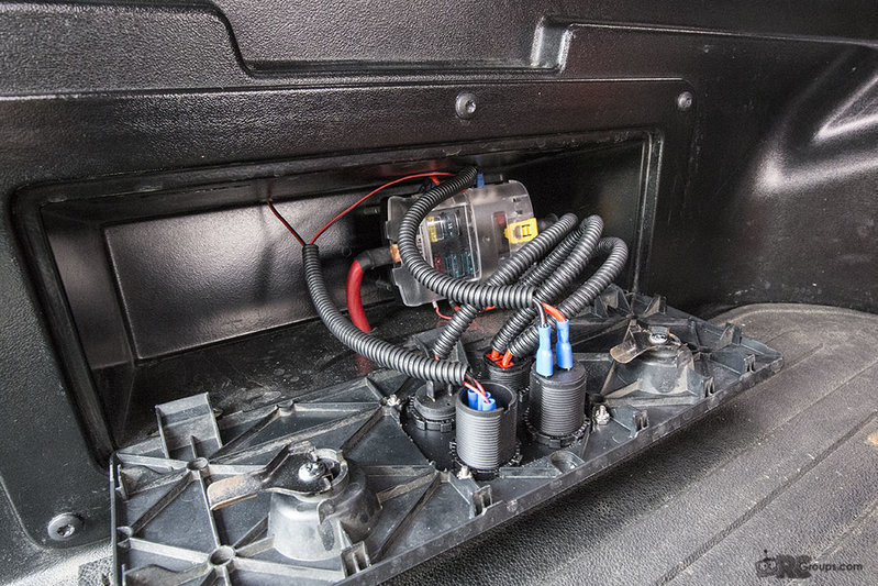

    Here's mine: volt meter has been running since installation over a year ago.
    IanAlpinist, omaguz, tacot0wn and 3 others like this.

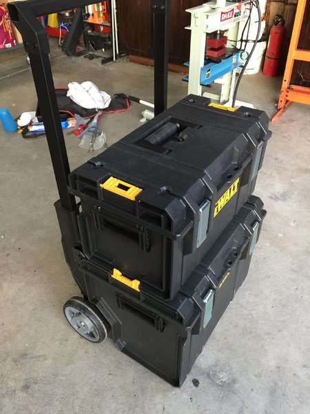

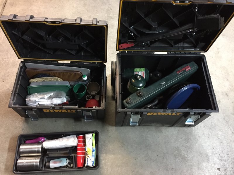

    Thanks for the inspiration on this. Went away with my action packer that I couldn't find anything in, and it sucked how everything got dusty AF in there. Decided on the DeWalt Tough System tool box because of how custom you can make it and it's dust/water proof. I was able to transfer everything over from the action packer and I have plenty of space left over. I was thinking of getting one of the smaller tool boxes to stack on top, but as of now it's not needed.

    And it's on wheels. I got ride of one of drawers and replaced it with bins because I found I would frequently want to carry my bins with all my kitchen crap somewhere the truck couldn't go. Wheels sounds pretty nice.
    I need to downsize my camp kitchen. Just about the only time I cook when I'm not at work is when I go camping so I like to have a pretty good assortment of tools etc.
