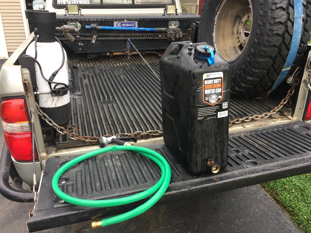

    Looking great Mike! Did that jerry can come with all the fittings for hose and air? You have a link to that?

    No, the jerry can does come with a gravity fed spout, but not one that can be used for a hose application. All the fittings I got from home depot and the valve stem was from advance auto:
    https://www.tacomaworld.com/threads...-01-build-thread.290011/page-47#post-15826970
    The parts used were a 6ft male to female leader hose, a male to male adapter, a standard hose nozzle, and a screw in male to female ball valve. I also got a bunch of extra hose gaskets, like the one used on the jerry itself. All parts are found in the garden section, only part I needed from plumbing was the male to male adapter.
    Jerry can from here:
    https://www.jerrycan.com/product-category/plastic-jerry-water-cans/
    But it looks like some of the nato water cans are stronger and bulge less.

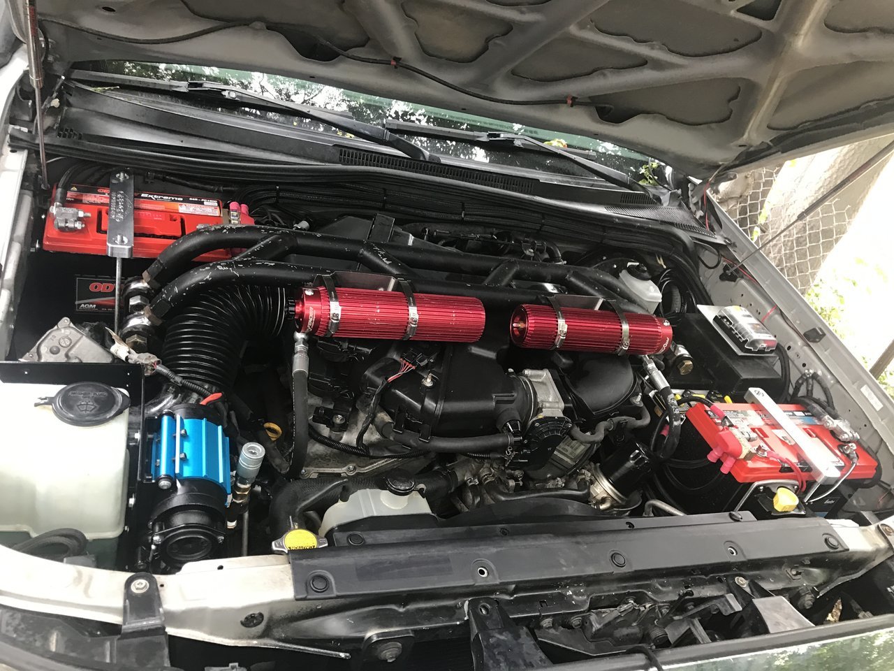

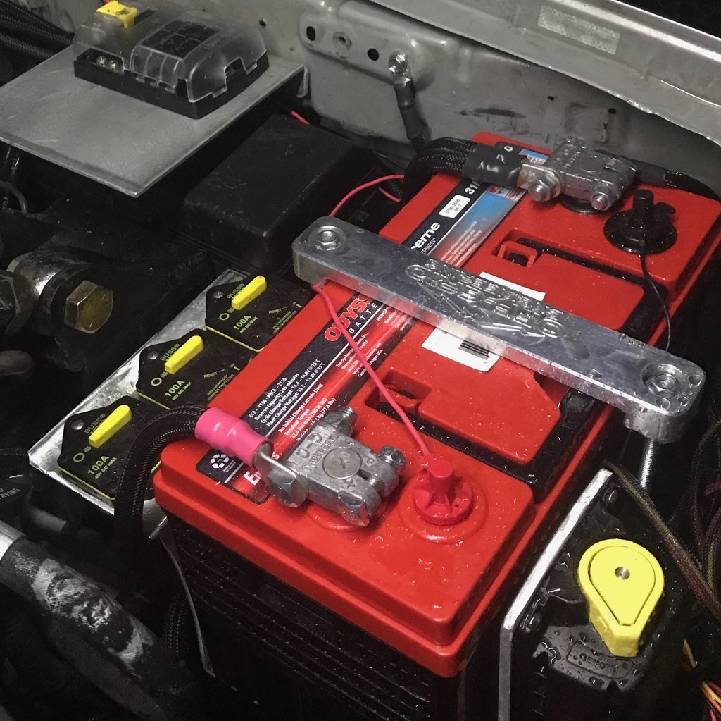

    @HeliMedic and @ROK-NJA at offgrid engineering do some awesome work! Just got the truck back from them last night and it looks awesome! Very well done, and i never knew you could have shoved a group 34 and a group 31 in that engine bay :anonymous:

    So the gravity spount unscrews and then you just thread in the hose fitting? Drill hole in the top for one of the tubless air valves and done? Seems easy enough. I need to do that.

    Yup. Was way easy, and hopefully the black tank will make the water nice and warm for showers.

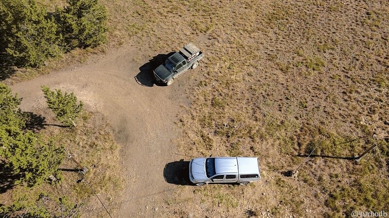

    ... "Within 20 minutes, we arrived at what would be our first extended stop - Desolation Butte Lookout.
    And as we pulled up, we each looked at each other knowingly - parked there, under the lookout, was another Tacoma." ....
